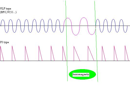

      Hi Michael, look at the picture. The differences are output power:VLF up to 2W ,PI~ 400 - 700W ; waveforms VLF - sinusoid ,PI - short pulses, etc.
      So, if you compare two types of MD, do not use electrical parameters, but check the mains -depth, discrimination of metals,low ground effect,etc.

        it's understood from Carl's note that frequency in PIs is not as important as other kind of MDs, and using VLF phrase for PIs is mistake. yes? no discussion here, I want to know DTI guys comments are true or not? they introduce pulse Peak Height(900 V),Peak Power(600 - 700 W) and coil current(10A) as the factors for penetration power . Can it be really so ?
          PI transmit depth is determined by the slew rate of the magnetic field, dB/dt. This depends on the initial strength of the field (B) and the speed at which it is shut down (t).
          For a skinny donut coil, B is proportional to the current I, the number of coil turns N, and inversely proportional to the coil radius R. At the center of a coil, B = µ*N*I/(2R)... it falls off as you move away from the coil. However, the reduction-vs-distance also depends on radius, so even though a larger coil will have a weaker field at its center compared to a smaller coil (everything else equal), at a distance it can be stronger than the smaller coil.
          The other parameter is dt, the speed at which the current is turned off. Faster is better. And this translates into a higher flyback voltage, where V=L*dI/dt. So, in general, a higher flyback voltage translates into a higher I or a lower dt. However, I believe you can clip the the flyback voltage without any negative effects, so a lower peak flyback that is clipped might still have a high I and low dt. This is on my experimentation schedule.
