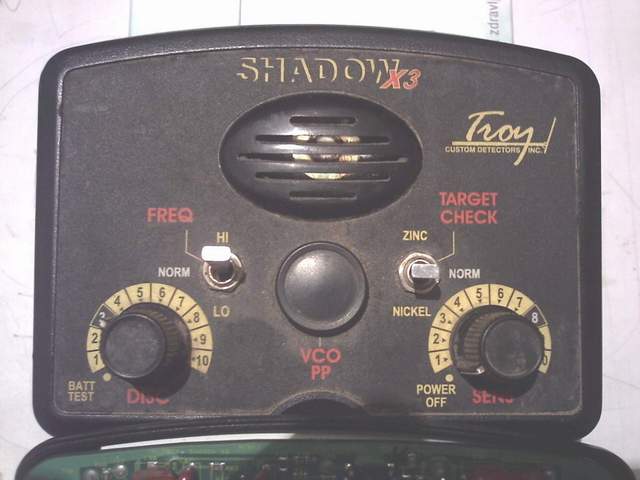

        So, finally,today i bought Troy Shadow X3!
        I checked it only in my workshop for now,since is to late to
        go outdoor,but tomorow i'll go on the field and see real X3.

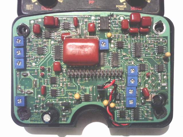

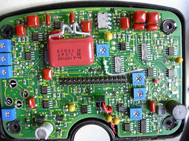

        One more thing is not clear to me;
        PCB's from my X3 and Mrand's X5 are exact the same ???!???
        As you can see on posted photos below....
        So i was wandering; what is the "geag"!? What is the defferences?
        O.K. on front panel X5 have a few knobs more, but inside the box..? Same?
        So, if that so....is is possible to know exact "spots" where to solder a
        few wires and add those X5 knobs and mod X3 to X5 ????
        Funny and interesting question! Any idea?
          Yes, they probably share the exact same board... this is commonly done. I'm sure the X3 lacks a few components, though I don't know which ones.

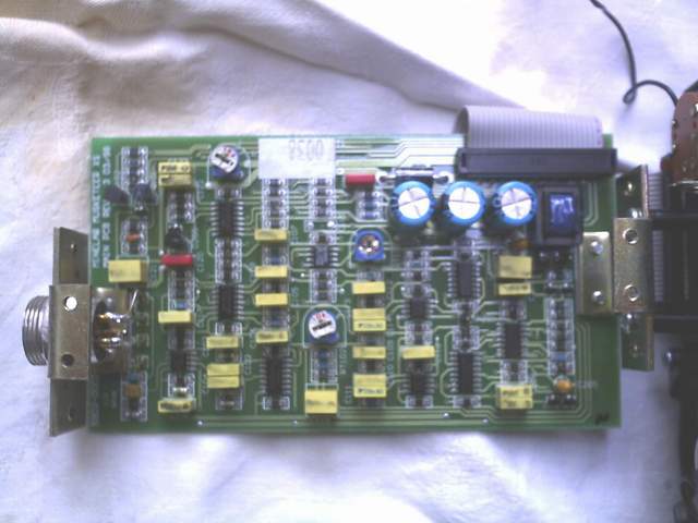

            it will be very interesting to trace the schematic of X3 (X5).
            if You can give me good pictures from two side of pc board i will try to make this.
              thanks a lot.
              can you give a list of all IC's of the PCB?
                x3 DEPTH
                If you do any air testing, crank up the sense as high as you can without falsing and set the disc to 3.
                It will see a quarter at 17.5 inches.

                    No big use from incomplete list of IC's....A few most important IC's had been already "scraped out"...their designators-labels....so they remain unknown for me....maybe somebody else can help?

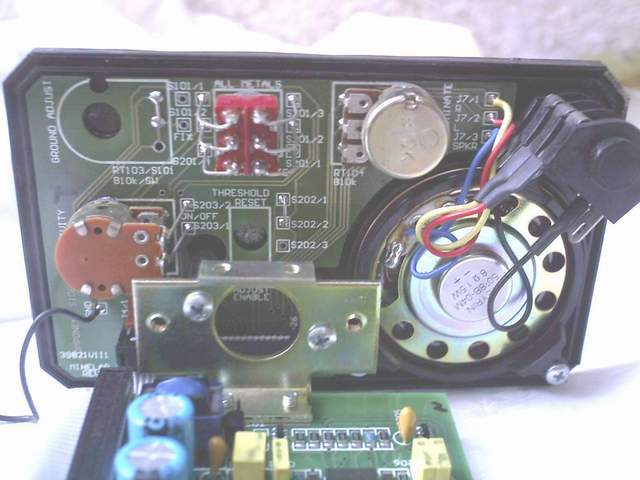

                      But curiosity pushed me to open the box....
                      Inside i found small,neat,smt pcb.....but with 'XS' label printed on it...
                      Also there is extra space for some pots, switches more....all wired up in overall design and jumped with jumpers....
                      So it showed again what Carl mentioned above...Colt and XS models of Musketeer type, are sharing the very same pcb....
                      I was thinking somehow to extend controls by adding those extra commands on it and make it to "XS" model....

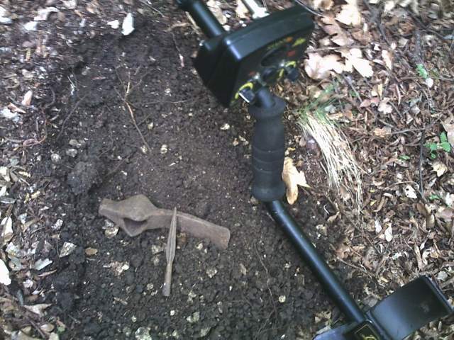

                            Bronze spear point?
                              No, it is arrow made from iron, but must be some progressive technique...very low rust although i founded it on terrain suspected to datet form early byzant period, maybe even Roman!? Axe is younger.....12-13 century, also iron...although not sure yet...
                              I found so far over 2000 arrows...but this one is most strange, most beautifill....first time i see this kind!?
