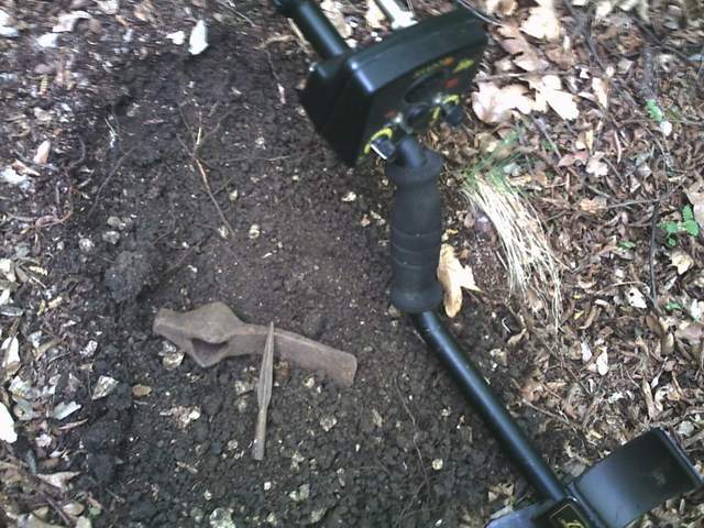

              Arrowpoint and pickhammer
              No, it is arrow made from iron, but must be some progressive technique...very low rust although i founded it on terrain suspected to datet form early byzant period, maybe even Roman!? Axe is younger.....12-13 century, also iron...although not sure yet...
              I found so far over 2000 arrows...but this one is most strange, most beautifill....first time i see this kind!?
              Hi Ivconic,
              I checked your arrowpoint and surely isn't medieval, probably not even Byzantine (even if it's kind a simmilar ..), also not Roman.
              So the last period possible is prehistoric (iron-age 1000bc - 300bc). The most simmilar in shape (iron ones) are from 3rd century bc in my country.
              Pickhammer can be very well roman (dolabra) but also late medieval or even later.
              I doubt you have found them at the same spot. Am I right??
