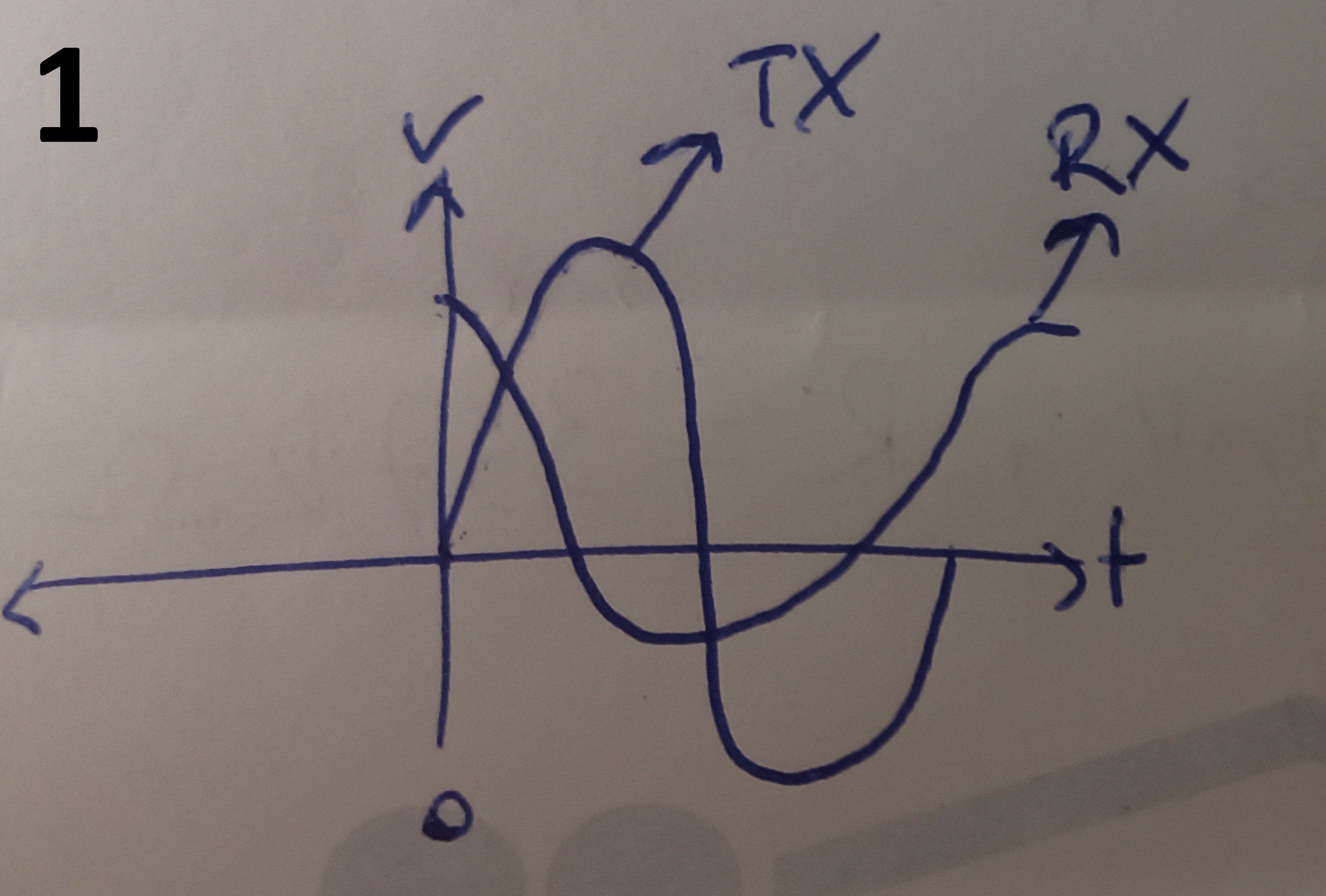

                          Hi again Carl,
                          I bought 9 different ferrites in total.
                          When TX and RX are as in the "picture 1", when I bring Ferrite closer to rx, the reactions are;
                          In-Phase Response + Amplitude Increase
                          CF139T1607C Toroid 1500nh
                          CF139T2815C Toroid 4300nh
                          KT130-26A Toroid
                          CF139T2515C Toroid 3200nh
                          MS-184026-2 Toroid 59nh
                          CF199T3112C Toroid
                          Phase change + amplitude increase;
                          CF193T3829C Toroid 6600nh
                          CF139R0620 Toroid (little rod black)
                          No Code - Long Rod black
                          When I pass the "ferrous object" while the RX and TX phases are as in the picture, there is a phase change + amplitude increase.

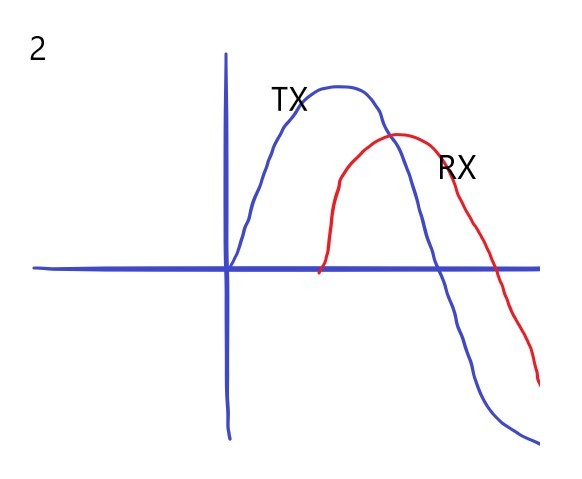

                          Which side should I choose?
                          When I set it according to "picture 2", if I hold "iron metal" to the coil, it gives an in-phase response + amplitude.
                          CF193T3829C, CF139R0620, Long Rod Black = in-phase response + amplitude boost.​
                            Carl's suggestion that 'any ferrite should be OK' is not 100% accurate. Some very high mu ferrite materials, usually ones designed to absorb high frequency energy, give unusual results. They are commonly painted green, and are found on mains ( 50 Hz / 60 Hz ) power filters, such as common-mode filters. The toroid "CF139T3829C Toroid 6600nh" is likely this type. I suggest using the lower A[sub]L[/sub} value toroids.
                            Also, type "KT130-26A Toroid" is not ferrite, it is powdered iron. This would be my choice for you to use as a "test ferrite"
