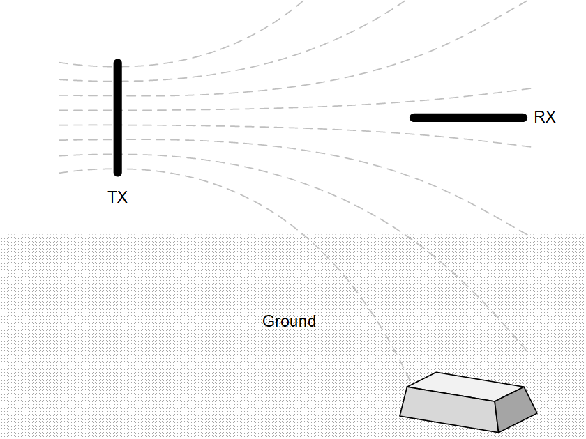

              Here is how orthogonal coils work:
              The TX field lines bend downward vertically and cut through the surface of a deep target, creating eddy currents. Shallow targets are actually hard to detect because the flux lines are more horizontal. You can add another RX coil on the other side of the TX; it won't add any depth but will cancel EMI and ground.

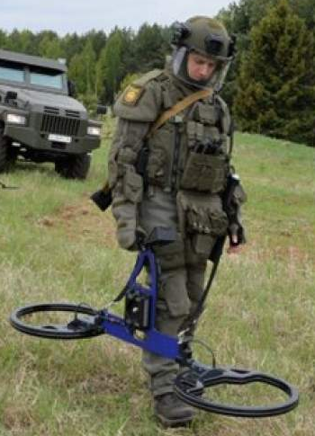

                  The 2 box principle that you showed in the sketch is known and explained many times.
                  But I think that the aforementioned Korshun works on a similar but not the same principle. I'm not sure though.
                  As far as depth is concerned, 1 meter is easily conquered with Pulse Star II and coil 45cm and 1x1m. We are talking about serious hoards here, not a handful of worthless coins.
                  The average depths involved in the cases I have seen are from 1.5 meters to 4-5 meters.
                  And the hoards in question are serious "masses" of mixed metal objects, mostly coins, but also a lot of jewelry and parts of weapons and costumes made of precious metals.
                  Don't waste your time on devices whose "success" is a depth of only 1 meter... that was overcome a long time ago.
                    And this is the official version of the military detector, the price of which is huge!
                    It is the same detector as the Korshun I wrote about.
                    Only that the picture shows the factory model, digital, the last word of technology.
                    Although it is a military product, it can be purchased individually.
                    But the problem is the price.
                    It is both the most powerful and the deepest metal detector I have ever seen in my life.
