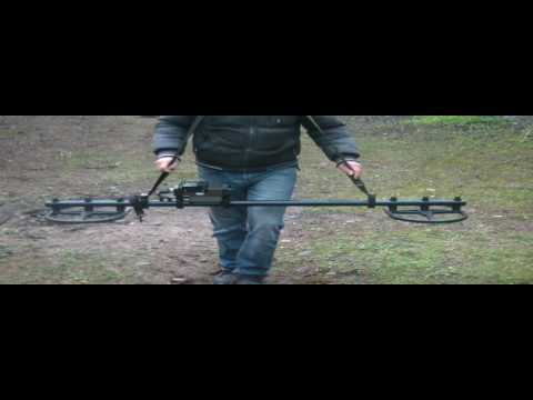

          TM808 tried it, it's stupid for me personally​,the so-called Bulgarian detector​ "Kantar" ​two box i also tried even bigger crap than tm 808​! As for the mentioned Russian detector or Ebinger 150​ I have no idea about EBINGER, and according to some sources, the Russian one comes from an older model that is based on the principle of pi technology​ so it was produced under the name Anker pulse​! And Eclipse can tell you more about that​ ,although I think Eclipse mentioned somewhere that that Anker is nothing special either​.
            https://youtu.be/rY-veK7gDUY?feature=share.
            This is a Two box that, in my opinion, works much better than what I have seen so far.​

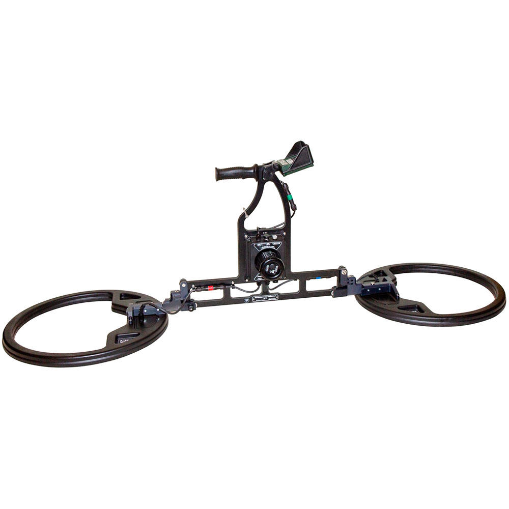

              Carl here are some achieved depths:
              Maximum detection depth 5 m
              Depth of detection of the OFAB-250 aviation bomb 3.1 m
              Depth of detection of an artillery shell of 100 mm caliber 1.8 m
              Depth of detection of an artillery shell of caliber 152 mm 2.2 m
              Click image for larger version Name:	image.png Views:	0 Size:	225.7 KB ID:	414539
              This is older model.
              The one I posted earlier is latest model and with depths up to 10 meters.
              And price is 12 000 euros.
              Now... we don't talk here about diy made by any of us; we talk here about a device produced by Russian military technology. Top of the world technology.
              Got to laugh at a munitions / mine detector where the operator has to actually walk over the target must have been by the same design engineers that gave us the T series tanks with rotary magazine autoloader in the crew compartment.
              The quoted targets are relatively massive lumps of steel ... a good PI with a single large coil would easily detect them. A two box PI could provide a Ferrous / non Ferrous indication ( for largish targets ).

                The story I heard, etc. is not serious​!
                I know about such stories, colleagues from the Russian forum told me.
                I have to correct you; no, it's not an Anker-based detector.
                It is a purely military project developed over decades by military engineers.
                And of course, as is usually the case; newer models are always based on the experiences and principles of older previous models.
                Much later, hobbyists tried to make such a detector based on Anker.
                Otherwise, a larger number of detectors that we have made so far and that we know; can easily be modified to work in the 2box variant.
                Anker is suitable because of the very strong TX and high voltage in the TX signal.
                Proof of that is the video you posted, Golden Mask 4 modified to work as a 2box.
                I assume that the TX "booster" was added in that Golden Mask. I have seen some GM models with the added "booster" before.
                It all makes sense.

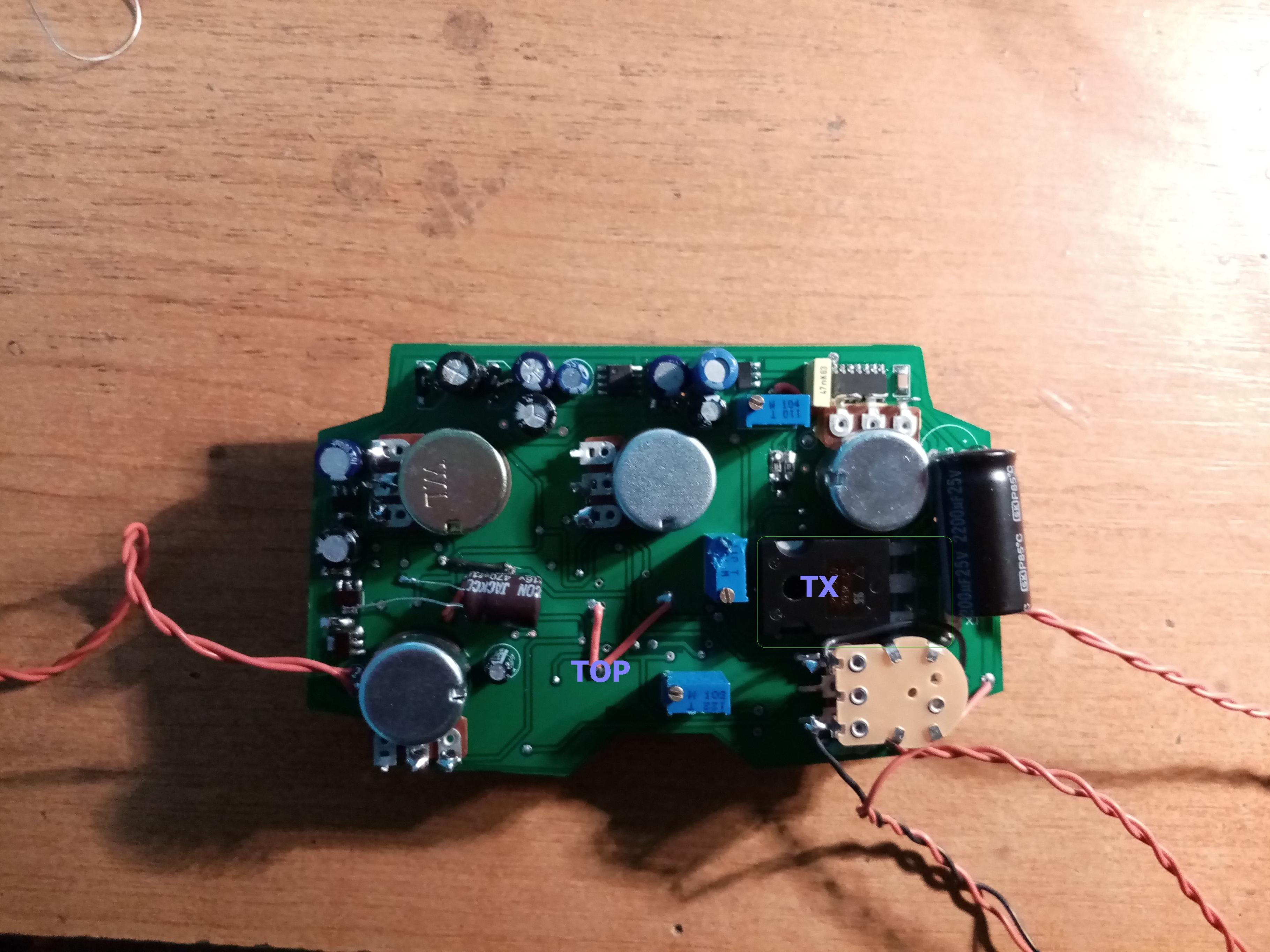

                          However, any slow motion and motion detector can easily be transformed into a 2box type of detector.
                          There have been ideas on the forum in the past. I vaguely remember something.
                          I'm not sure that such detectors can be called "PI" just because the TX works on a similar principle.
                          In the specific case when we talk about that Golden Mask; I don't have any knowledge because I don't follow Golden Mask from model 4 onwards.
                          Because many years ago I myself made some attempts to make a 2box variant out of an ordinary detector. None of it was good enough.
                          Carl suggested a strong TX in a previous post. And there is an essential difference between the modification of the ordinary VLF I/B in 2box and such attempts as that Golden Mask.
                          Of course, the TX must be very robust in order to achieve greater depths. PI TX is always preferred for such performances.
                          But let's also remember Anker. Anker 50... a very old project. I remember making it. TX was really strong.
                          If I remember correctly, I measured about 200Vpp on the TX on the oscilloscope.
                          It was impossible to make a well-balanced coils under such conditions, so I eventually gave up.
                          That Anker was hypersensitive and kept reacting and giving false signals.
                          At that time it didn't occur to me to try to make a 2box out of it.
