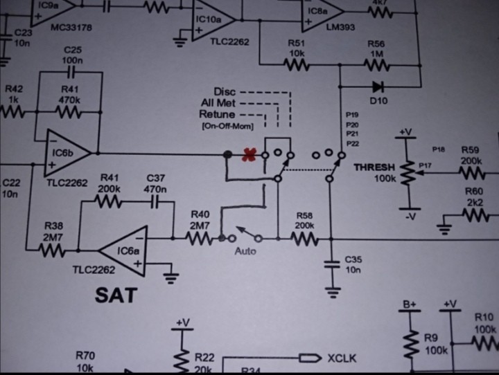

        A third channel is sometimes provided in VLF detectors that can display a target ID, as this is based on the phase angle of the target, and this can be offset if there is an external ground balance control. It depends on how pedantic you are about the target ID accuracy.
        In Tesoro detectors without a display (such as the Bandido) the third channel is a non-motion mode for pin-pointing. I don't know about the Bandido III variant without seeing the schematic.

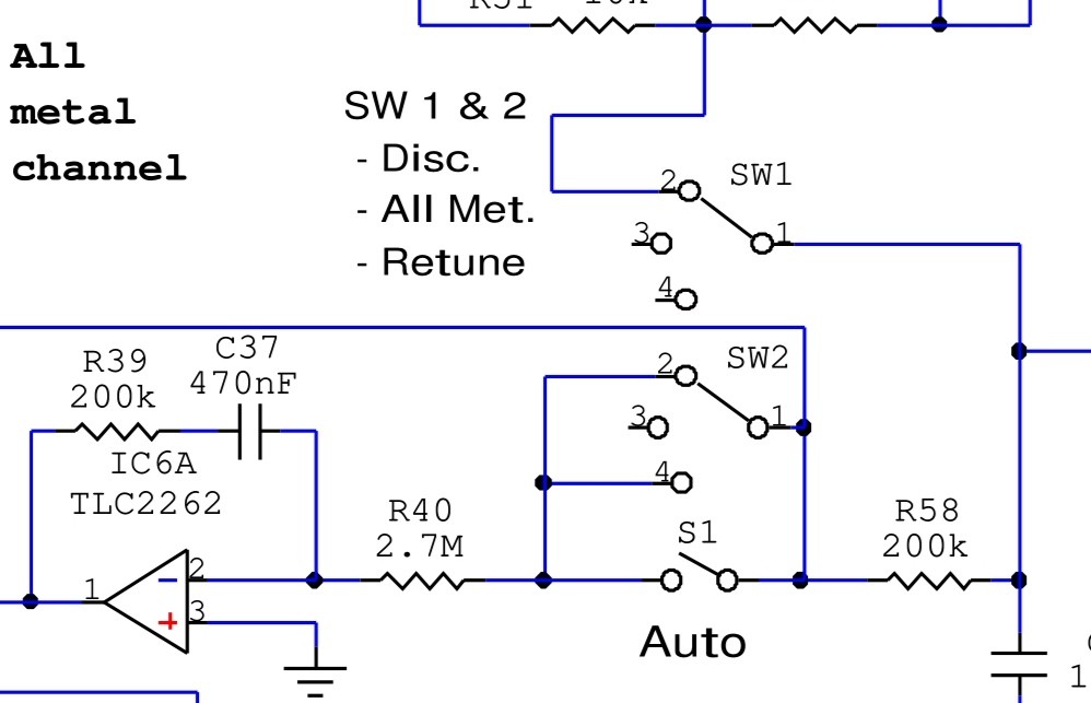

                Hello Carl, I have found another inaccuracy on your scheme from the message # 2.
                I compared it with the old scheme and figured it out, but so that others don't get confused, I'm writing.
                With respect.
                  Thanks, I'll get it fixed.
                      Here is my updated schematic:

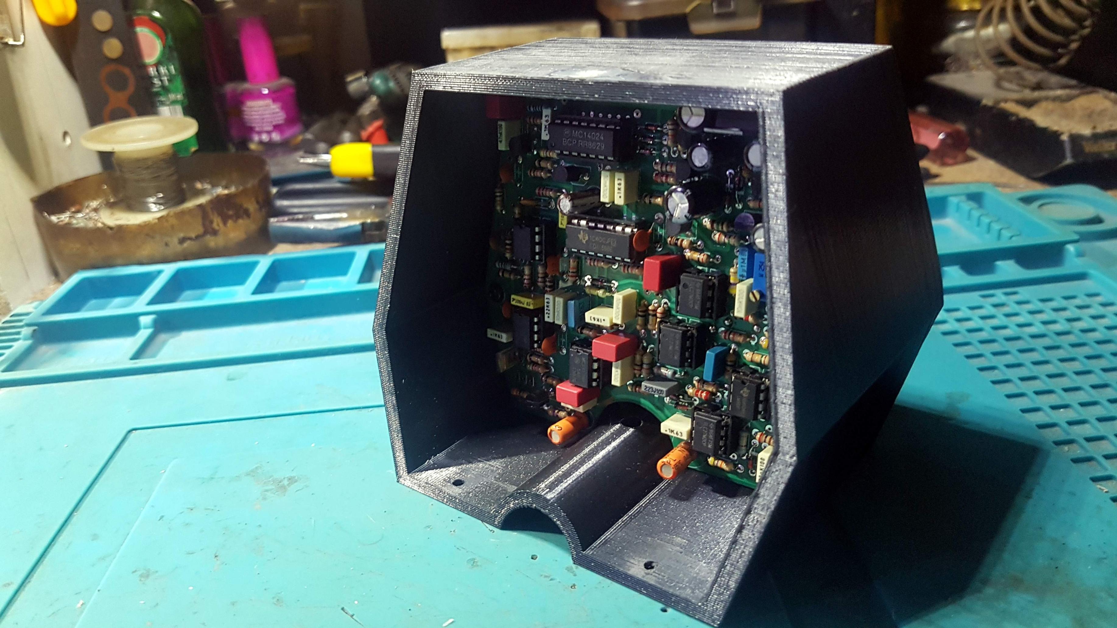

                            My 3D files are "rough" geometric shapes, because they were made in TinkerCad.
                            I'm not professional enough either.
                            It would be good if someone more expert processed them in a more powerful software.
                            I have all the relevant Autodesk software... but I don't have time to master it properly.
                            The edges of the box and parts need to be slightly rounded and the whole design refined.
                            Who has the will to do it; it would be useful for the forum and future detector builders.
