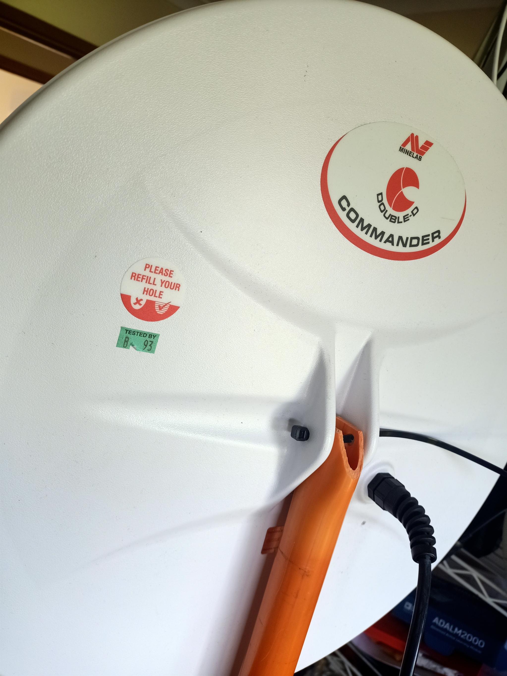

                      The coil is a minelab DD ... Its made for PI use and I believe the TX coil is wound with Litz wire. There is no capacitor across the coils ( like you may find in some VLF coils ).
                      Its a wide band low capacitance coil and the TX reactance at 8.33 Khz is about 15 ohms - 20 ohms and real ohms is 0.4 approx.
                      It develops 60 volts peak - peak across the coil @ 4 amps.
                      I should have quoted the IB leakage as 10 millivolts per amp ... so the unbalance at 4 amps is 40 millivolts not 10 millivolts. However 40 millivolts at 4 amps is OK for my application.

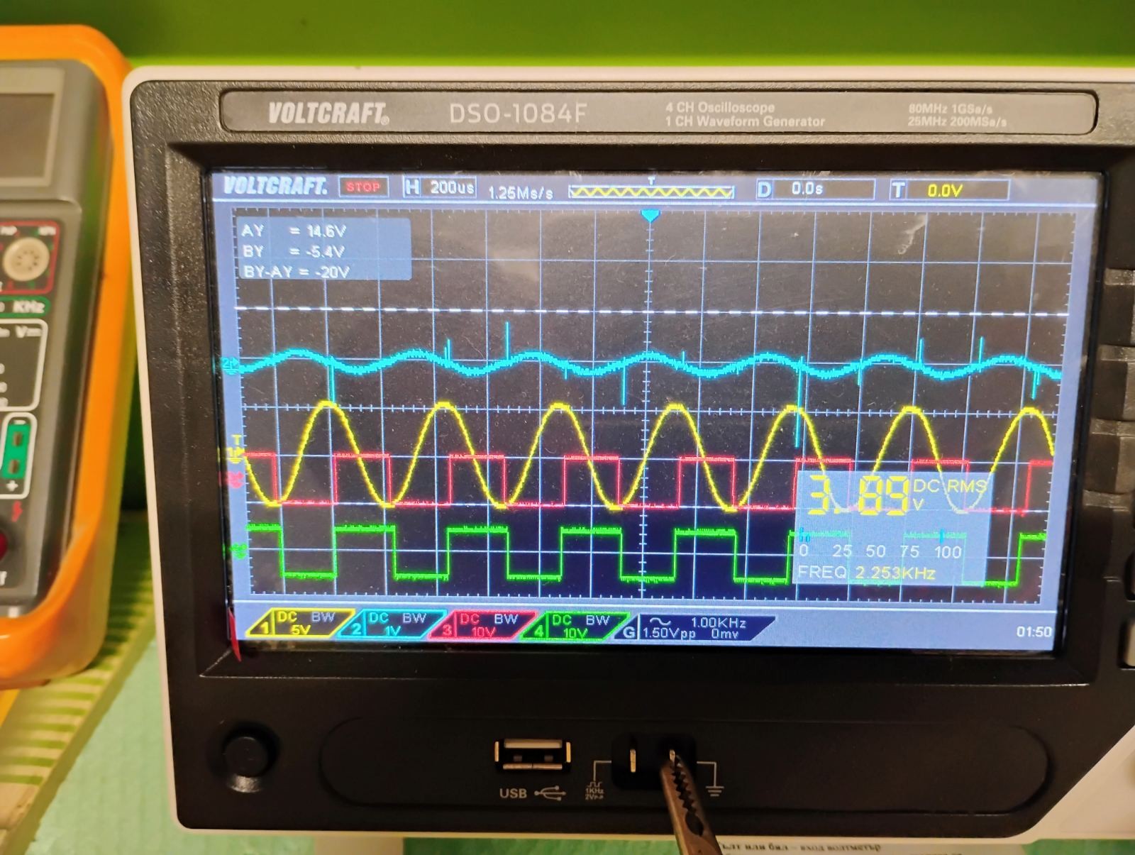

                      Below is pic of waveforms from the testbench ...
                      Yellow = TX clock
                      Pink = RX voltage ( 40 mv pp )
                      Light Blu = TX voltage ( 60 volts pp )
                      Dark Blu = TX current ( 400mV pp ) sensed by 0.1 ohm resistor in TX leg.

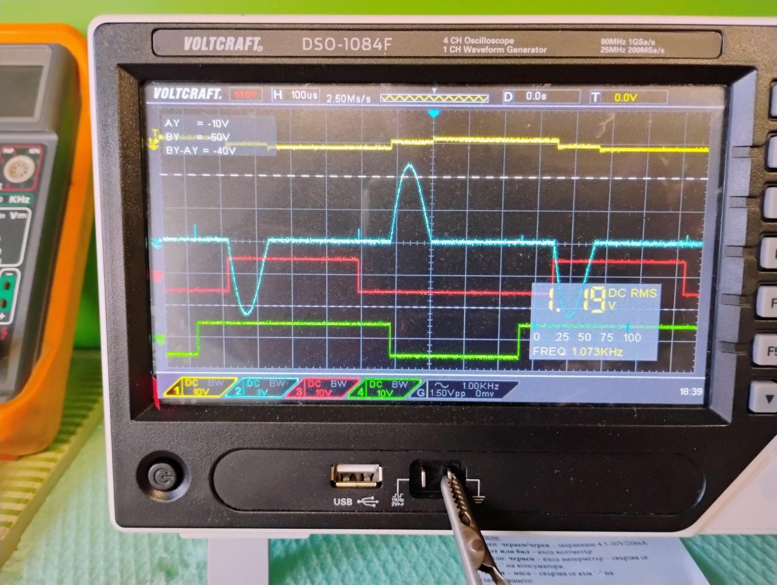

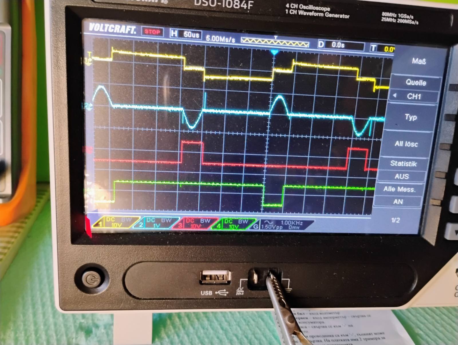

                      • Click image for larger version  Name:	viber_изображение_2024-12-18_11-34-07-145.jpg Views:	0 Size:	346.3 KB ID:	431936 Click image for larger version  Name:	viber_изображение_2024-12-18_19-21-05-944.jpg Views:	0 Size:	313.7 KB ID:	431937 Click image for larger version  Name:	viber_изображение_2024-12-19_19-24-28-775.jpg Views:	0 Size:	343.0 KB ID:	431938

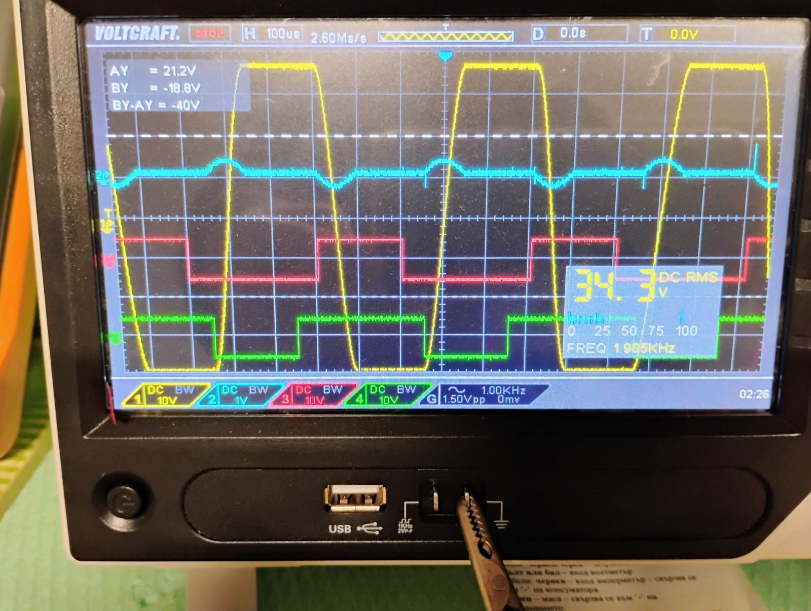

                        • Probe range x10

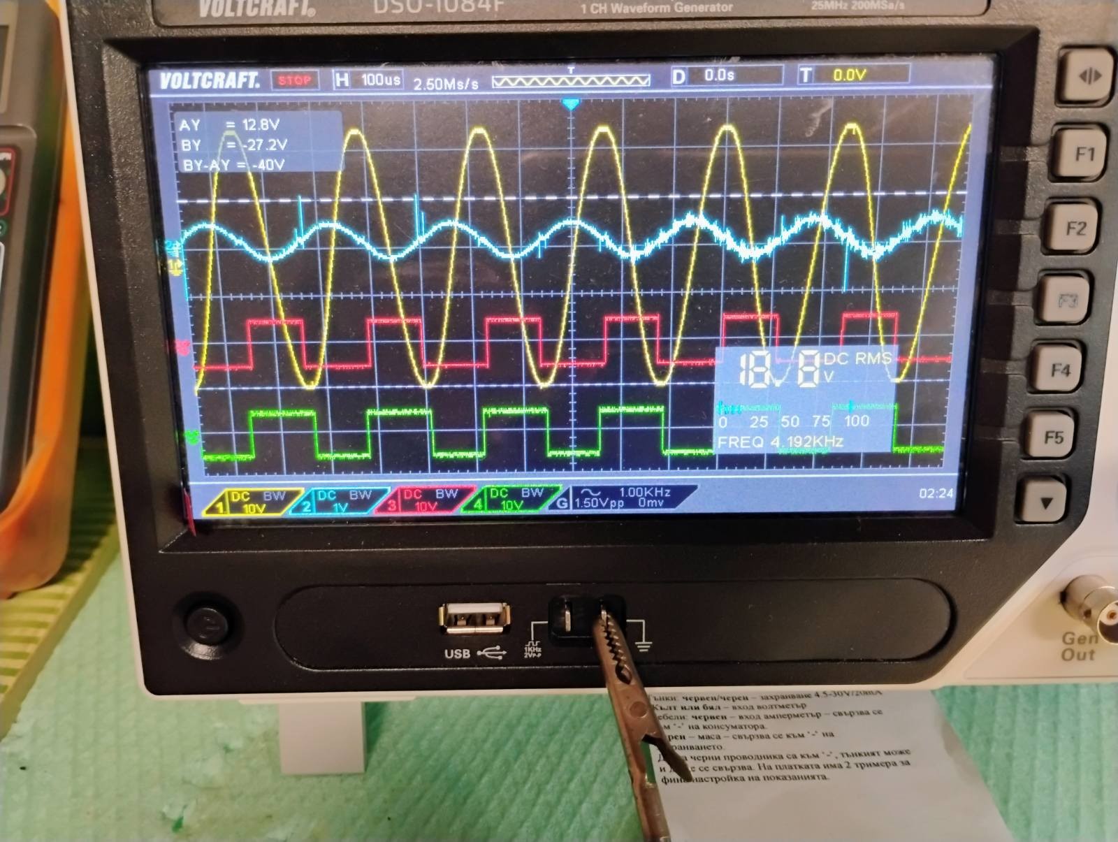

                            Hello, I would like to test the circuit, but I can't understand what the pulses on the inputs V7 and V8 should be. Can you write the parameters of the two pulses? Thank you.
                            • V7 and V8 are square wave 180 degrees out of phase.
                              • Make them 10 khz to start with.
