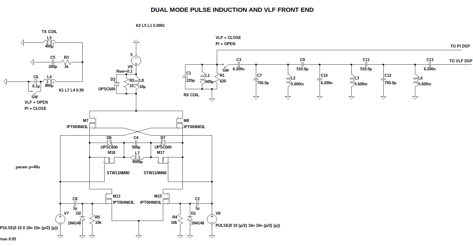

    ​And why is it that the classic full H-bridge is not used in branded metal detectors, and in homemade ones too? Two assemblies of P/N mosfets (for example, IRF7105, 7309), one TC4428 type driver are enough. This, of course, applies to the VLF, for a pulsed metal detector, such a bridge circuit is not suitable. What is the advantage of the TX cascade on 6 transistors over the TX cascade on 4 transistors?
    With a TX cascade of 4 transistors, the metal detector can use a lower voltage (3-9V) TX and a coil with fewer turns. The TX coil with low inductance will be less affected by the Earth's magnetic field, which in turn will provide a more stable phase characteristic of the TX circuit
    There are one or two metaldetectors with H bridges though more complex than 4 transistors and a gate driver as you put it.
    The short answer is that the 6 transistor configuration recycles the flyback energy on each pulse and uses considerably less energy than a conventional H bridge.
    The CCPI can run off as little as 1.8 volts with 2 amps peak to peak in the coil whilst only using 1.5 watts.
    Out of the 6 transistors (mosfets ) you only need 2 high voltage units not 4 like a H bridge ... these are the expensive devices.
    Its a bipolar transmitter and RX so earths field is inherantly cancelled during RX sampling.
    • Fine. I almost got it. "6 transistors" are more economical in terms of money and have a higher efficiency.
      And if you set the supply voltage of the TX cascade to 2.5-9V. Which mosfets are worth paying attention to? Does the CCPI support operational voltage regulation: at high frequencies, increase the TX voltage to increase the field strength of the TX coil, at low frequencies, reduce the TX voltage to reduce the current in the coil.​​

        As you increase the supply voltage the current will increase and the probability of MOSFET avalanche will increase. I use 3.3 volts for 2 amps peak to peak and the flyback is around 800 to 1200 volts. I have found silicon carbide MOSFETs give good results.

            • I just remember the photo of your PI detector layout. You used "big" tools. It is justified for a PI detcutor to use a "reverse stroke". But for the VLF, how appropriate is the ccpi?
              • The through hole parts are used for prototypes. SMD works fine. The CCPI generates pulse or sinewave.
                • Update to make it clear how we switch the detector from PI to VLF mode.....
