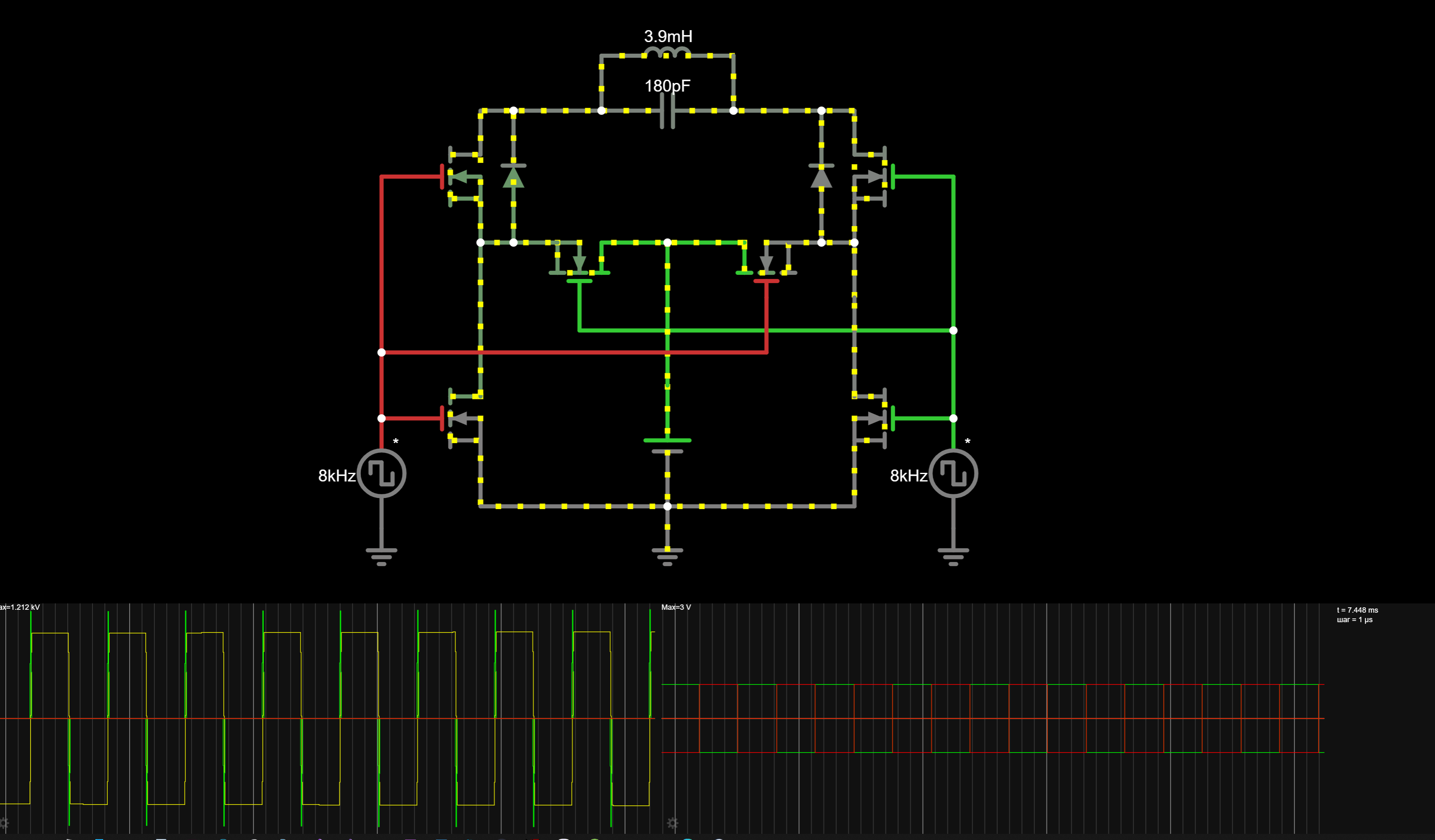

                        • Here is transmitter simulation file for helpful program "circuitjs" Transmitter 1.zip Click image for larger version  Name:	Transmitter.png Views:	0 Size:	147.5 KB ID:	418926
                          Mosfets-current sourses after battery is forming square shape of current.

                              • ​And why is it that the classic full H-bridge is not used in branded metal detectors, and in homemade ones too? Two assemblies of P/N mosfets (for example, IRF7105, 7309), one TC4428 type driver are enough. This, of course, applies to the VLF, for a pulsed metal detector, such a bridge circuit is not suitable. What is the advantage of the TX cascade on 6 transistors over the TX cascade on 4 transistors?
                                With a TX cascade of 4 transistors, the metal detector can use a lower voltage (3-9V) TX and a coil with fewer turns. The TX coil with low inductance will be less affected by the Earth's magnetic field, which in turn will provide a more stable phase characteristic of the TX circuit
