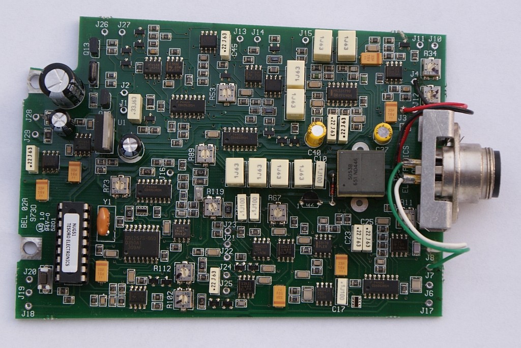

        do you need to make some adjustments to the PCB.
        no data, not given. yup, i did believe after Tesoro crash somebody will get their whole archive, but not. no issue.
        all died. your way probably is to do new coil with more great tuning.
        so nice board, SMD made, microchip used (sic) and such poor result... just 20cm depth. a blood, a sweat and the tears Click image for larger version
                so nice board, SMD made, microchip used (sic) and such poor result... just 20cm depth. a blood, a sweat and the tears Click image for larger version  Name:	lobo_pcb.jpg Views:	0 Size:	224.5 KB ID:	422661
                Hello KT, thank you also for your opinion and thank you also for sharing your files.
                I think the same; This detector's cost is much higher here in my country than an XP ORX. So much investment in SMD components for little range.
                I see that you like to collect images of detectors. Here I share some of my Super Traq Lobo Treasure Detector.​
