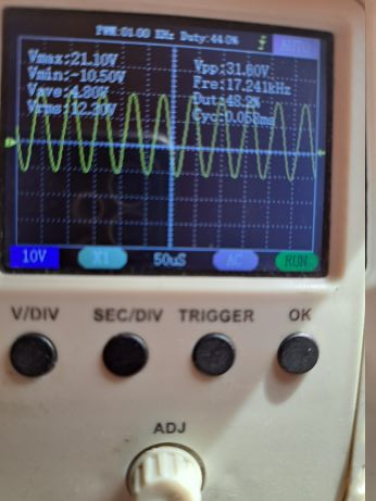

      Maybe someone "played" with the trimmers in that Lobo, who knows?
      Maybe that's how he messed up the factory condition.
      And so maybe the detector behaves a little differently.
      You won't know until you find another colleague who has the same model and compare the behavior of both detectors.
      Ruben; it would be good, if you have time and will, to record a video in a similar way as I did; to show the behavior of the detector on similar targets.
      Then we will be able to better assess whether the detector is completely ok or not.

        Tomorrow I will make the video, I don't have any object that is gold to make the demonstration; but I will do it with some other objects.
        I thought the same thing about the trimmers, maybe someone moved them from their factory state. I was even making the schematic diagram of the Tx stage and the Disc. so that it is easier to locate the fault; But as I have seen in the video that I shared, I think that my detector is within the parameters of the video.​

                What was promised is a debt, here is the video I made!
                Try with iron, copper, 1 sol and 50 cent coins (copper, zinc and nickel alloy), 10 cent coin (brass), 1N4148 diode and 1N4148 diode without terminals. The test on all of them was done in all metal mode, the other selector in normal mode, sensitivity 10.
                Then the tests were carried out only with the diodes in all-metal mode and it was changed first to ALKALI mode and then to Black Sand mode.
                Then I tested the diodes in discrimination mode and set the discrimination level to half and the Threshold to half.​

                  Looks to me like everything is working properly. The coins seem to be breaking the threshold at around 30cm which is very decent. I suspect your diodes have steel leads (mine do) which is why they are not detected in disc mode. Cut some small pieces of household aluminum foil, say, 5x5 mm and 10x10 mm to mimic small gold.
                    ok Carl, I'll do what you say. Thanks for your point of view!
                      Sometimes I'm wrong in my judgment and sometimes I'm right. The detector is perfectly fine.
                      A video always says more than 1000 words.
