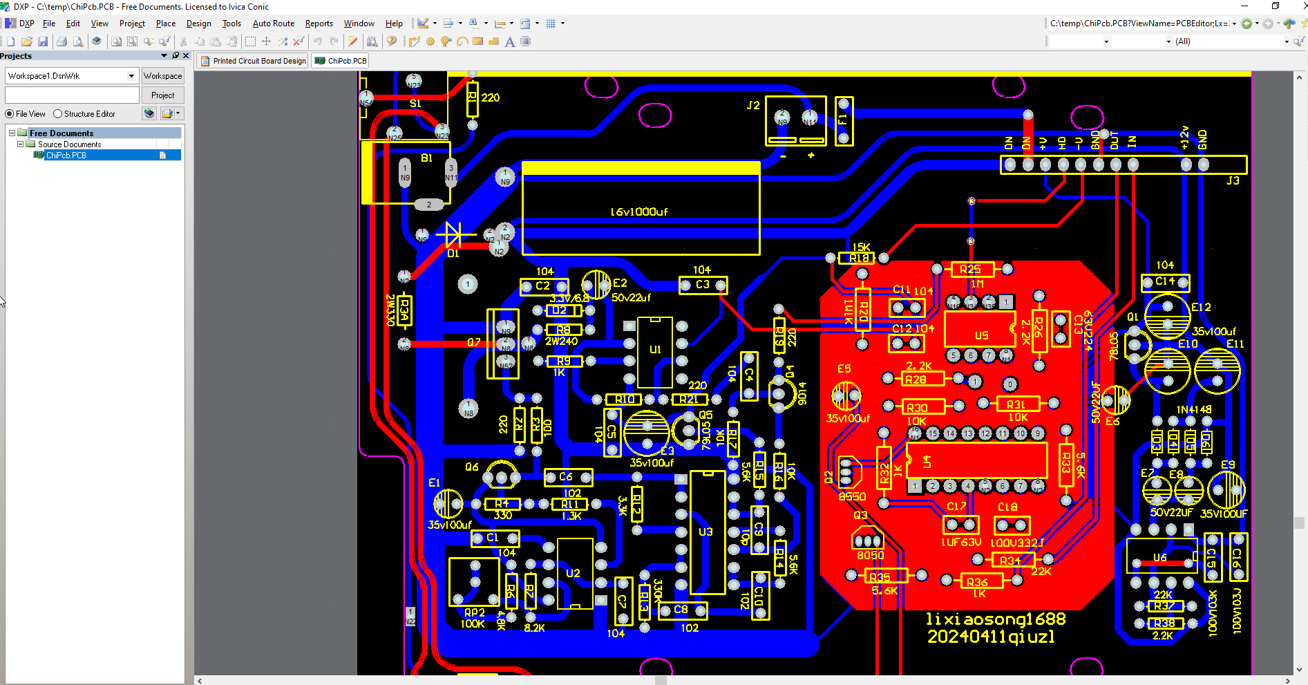

    I am a novice want to add a number module function to my board, please do what I how to start, there is a master willing to help me add a number module function
    ​​​​​The following is my PCB format design drawing
    What design is this? Is there a schematic?
      I don't have a schematic, just a PCB
        Then there is nothing anyone can do to help.

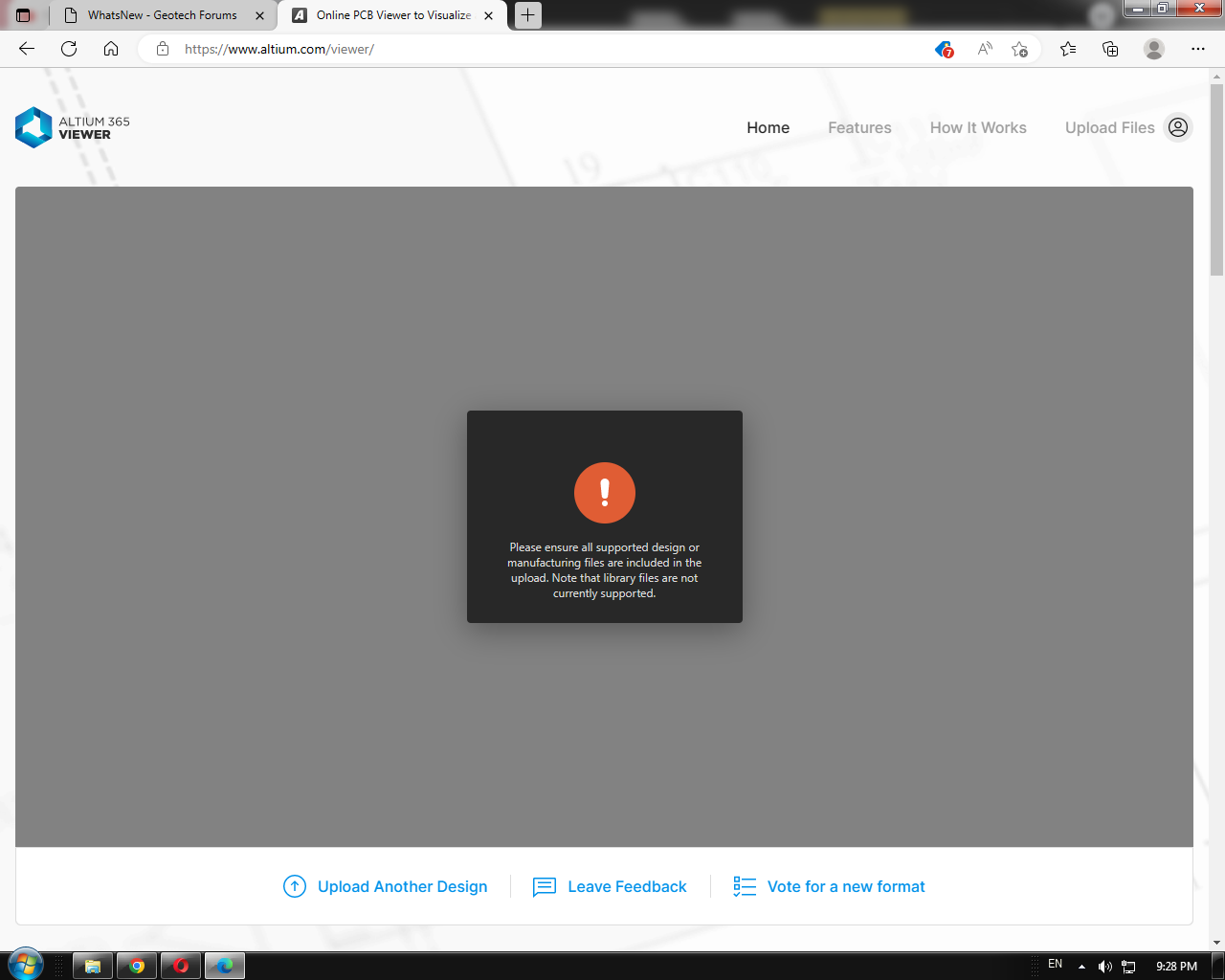

          what CAD (THE soft) was used? .PCB is very common extension in much CADs.
            Altium Designer
              not open - not Altium Designer

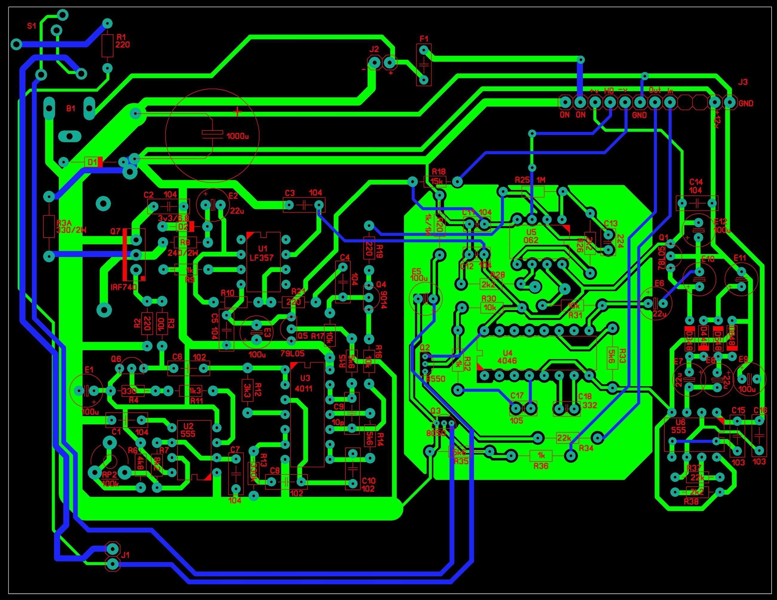

                If you have the PCB, then it should not be difficult for you to trace out a schematic.
                    U1 lf357
                    U2 U6 NE555
                    U3 4011
                    U4 4046
                    U5 tl062
                    Q7 irf740
                          Thank you, teacher.
                            Obviously it is some kind of PI detector.
                            But the unusual pcb design, the unusual way of drawing the connections as well as the DC connector...?
                            Is this a regular PI detector or for some other purpose?
                              Is ordinary PI, two separate boards, similar to the dbp2010 structure, depth 3-4 meters, using 2 × 2 meters square coil, very unstable in the mineralized area I want to add a digital programming chip for him, I have no clue
