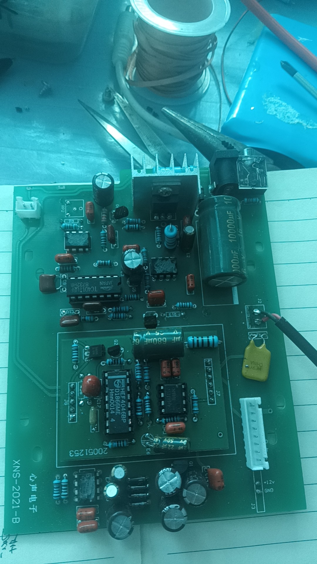

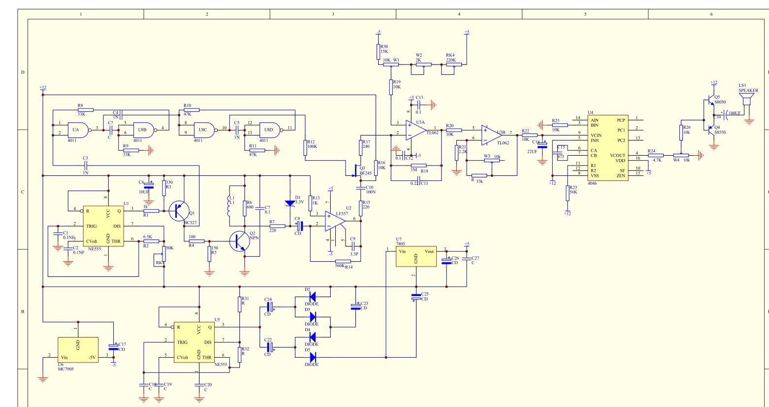

    How can you say its like DBP2010 if you do not have a schematic? The DBP2010 is for sure more complex of what I see in the PCB.
      again Polones moded by 4046. ok, i hope still to see the source of this mindflow.
        It is a PI POLONES with an audio module composed of a CD4046.
          it seems he is keeping a divider in a hand and loves to draw circles.

                I have created a schematic, so how can I add a CPU to it? Programming is really difficult for me, please help me
                  Obviously it is some kind of PI detector.
                  But the unusual pcb design, the unusual way of drawing the connections as well as the DC connector...?
                  Is this a regular PI detector or for some other purpose?
                  The pcb is designed like this for commercial purposes. This is the cheapest deep pi. 90% of the pi motherboards in China, and the remaining few motherboards use xr71 and the old gold mask
                    The above post is not a correct drawing, I have not seen a pcb that is the same as the circuit diagram. There are two designs of 6103, one uses two 082s, and the other just adds 4046. It is just 5196, proscan adds 4046, changes the frequency delay, which makes it look deep in the air, there is no benefit, just to sell it at a high price. XR71 is better than 6103, and DBP2010 is always better than 6103
                      There is another 6103, called 5198, which uses 78l08 and 79l08, adds 10000uf filter capacitors, and adds 1n4001 and self-recovery fuses to the positive and negative poles. The obvious feature of 6103 is its four 4148s, while the original 5198 uses 4001

                        You wrote.... "There is another 6103, called 5198,..." are these detector models? Or what? If detector models can you post the schematics here?
                          Hi, the translation I used may not be clear. They both add 4046 through a polones, the only difference is that 5198 uses +-8v power supply.
                            I don't have the 5198 circuit diagram, I have two versions of the 6103 drawing, and if I release it, it may damage the interests of Chinese sellers.
