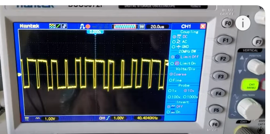

Is this the results I need to be seeing with my scope for the Deus2?
  • Is this the results I need to be seeing with my scope for the Deus2?
    Russian video
    https://www.youtube.com/watch?v=E2AYJp2uH2U

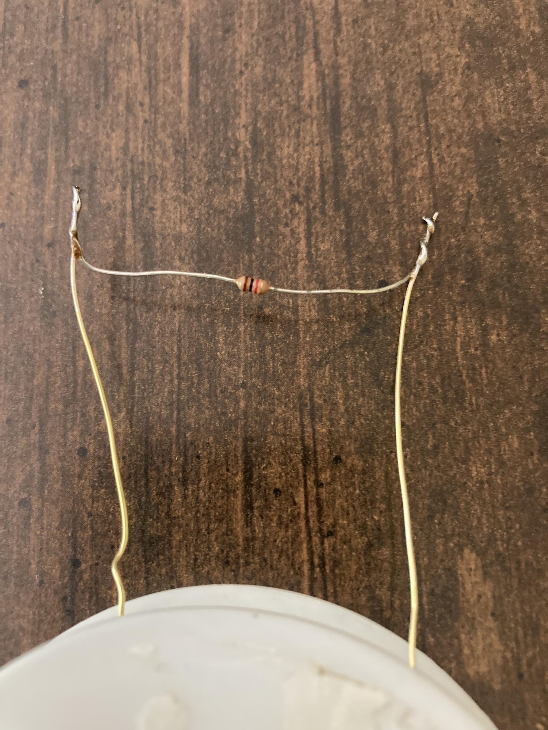

    I'm no where close. Built another coil using crafting wire that seems to have a coat of shellac. 2" in diameter. Measures .11 mH and .7 ohms.
    Not sure but the wire is white like maybe some kind of tin.
    The Russian video has not got correct triggering but you do
      My bad ... Thought the picture was your scope.
        The exact design of the pickup coil won't make a whole lot of difference. One thing about MF waveforms is they are hard to trigger on. You need to set the trigger holdoff to just a little longer than the overall period of the waveform.
        Show us what you are getting, maybe that will suggest what you need to do.

            Try adding a 1k damping resistor across your pickup coil.

                Now the 17 kHz looks better.
