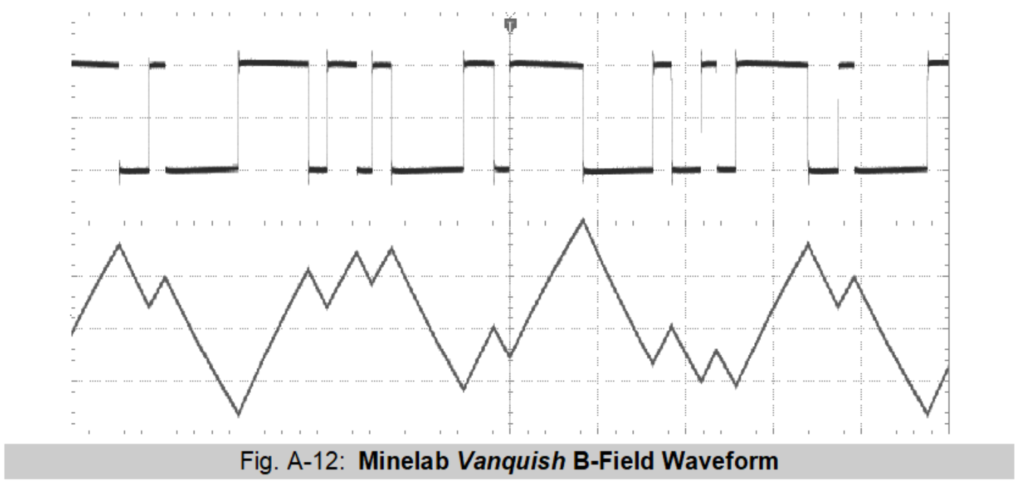

        For the sensor, I use a Wurth 7447480331 which has L = 330uH and R = 0.3Ω, or a tau of 1100us. This is plenty low enough (145Hz) for detectors. Here is the measured field for a Vanquish 540:
        The slight bowing you see in the B-field waveform is due to the resistance of the Vanquish's TX coil, which has a tau of 260us.

        Does the lead core of the Wurth 7447480331cause the detector to detect an overload?
        • #49
          The inductor has a ferrite core and, yes, if you get it too close to the coil the detector might overload. That doesn't alter the TX signal, tho.
