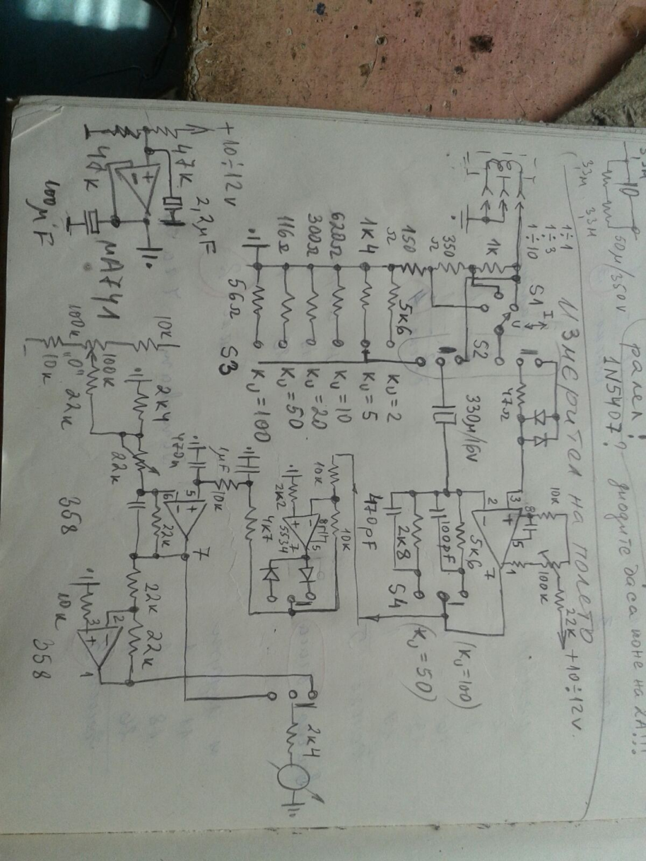

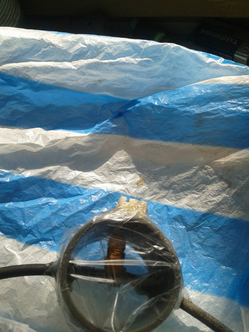

        Hi Altra , I understood , that you are confused that I am confused .I know the scheme Current probe sch.pdf from kindergarten 2 years ago I made a "field meter", it has several sizes of "voltage" coils and one "current" one - a coil of 4 mm copper wire closed through 1 winding of the primary winding on current transformer( isn't it the same ? – a closed current loop of 4 mm copper wire passed through a toroid -White's TM808 Euro) if anyone is interested, I will take pictures of the circuit, coils, appearance. It is primitive, but it works for me to measure the energy and field configuration in the near and far zone (more than 1 meter).
          Yes I understand the closed loop current transformer. I normally use a series resistor with the tx coil to monitor the current. The op amp c to v circuit is good for testing when you cannot insert a xformer or resistor. Post some pictures of your sensors,
            yes, please post
              And I really like a series resistor 0.05 to no more than 0.33 ohms to see the current. I will take the pictures of the "field meter" soon. but don't laugh at my design... :rotflMark-VA - now it's sunrise for me, the air is scented with linden trees , I have a lot of tasks waiting for me. I will take the pictures in a few days ​

                    Just having the inductor for the sensor by itself will distort the flat frequency response if the TIA.The input impedance must be loaded up to preserve low frequency response. Eg for 20 hz to 150 khz see below ...Click image for larger version

                      Thanks that's some good information. When I get some time, I try your circuit.

                        For detector fields you don't need to go that low. Here is the (more) complete circuitry for my field probe:

                        For the sensor, I use a Wurth 7447480331 which has L = 330uH and R = 0.3Ω, or a tau of 1100us. This is plenty low enough (145Hz) for detectors. Here is the measured field for a Vanquish 540:

                        The slight bowing you see in the B-field waveform is due to the resistance of the Vanquish's TX coil, which has a tau of 260us.
                        ITMD-3 Appendix A will give all the details for this probe. Soon.
