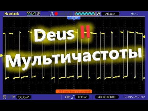

              Look at this person's channel --- there are all the oscillograms for Deus. To translate into English, turn on subtitles.

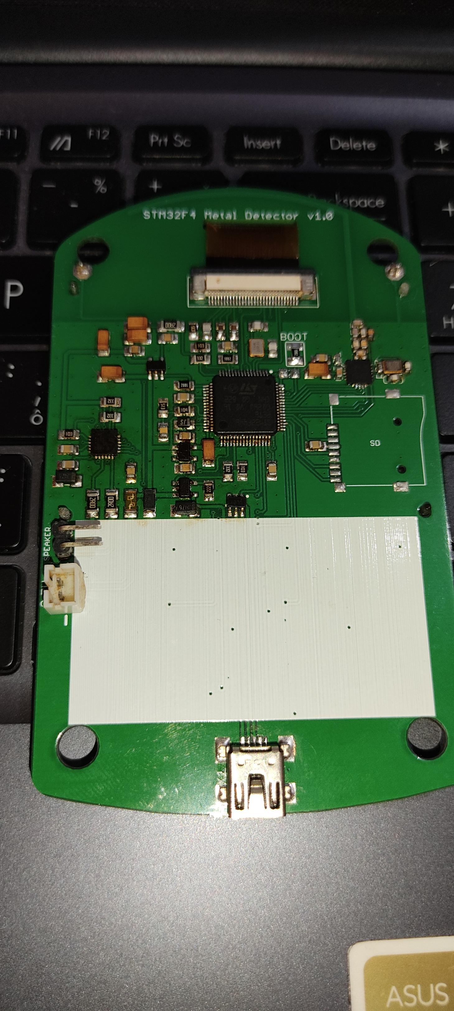

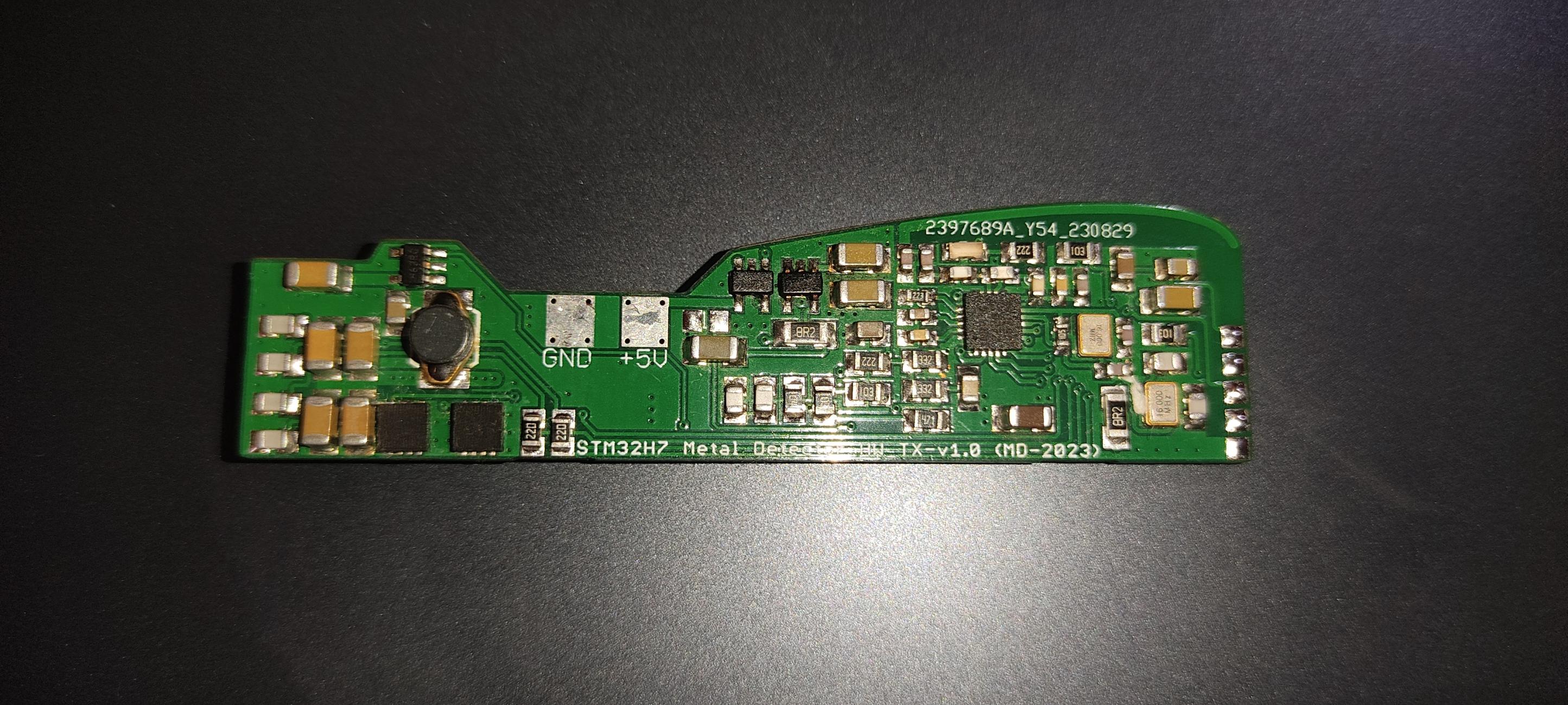

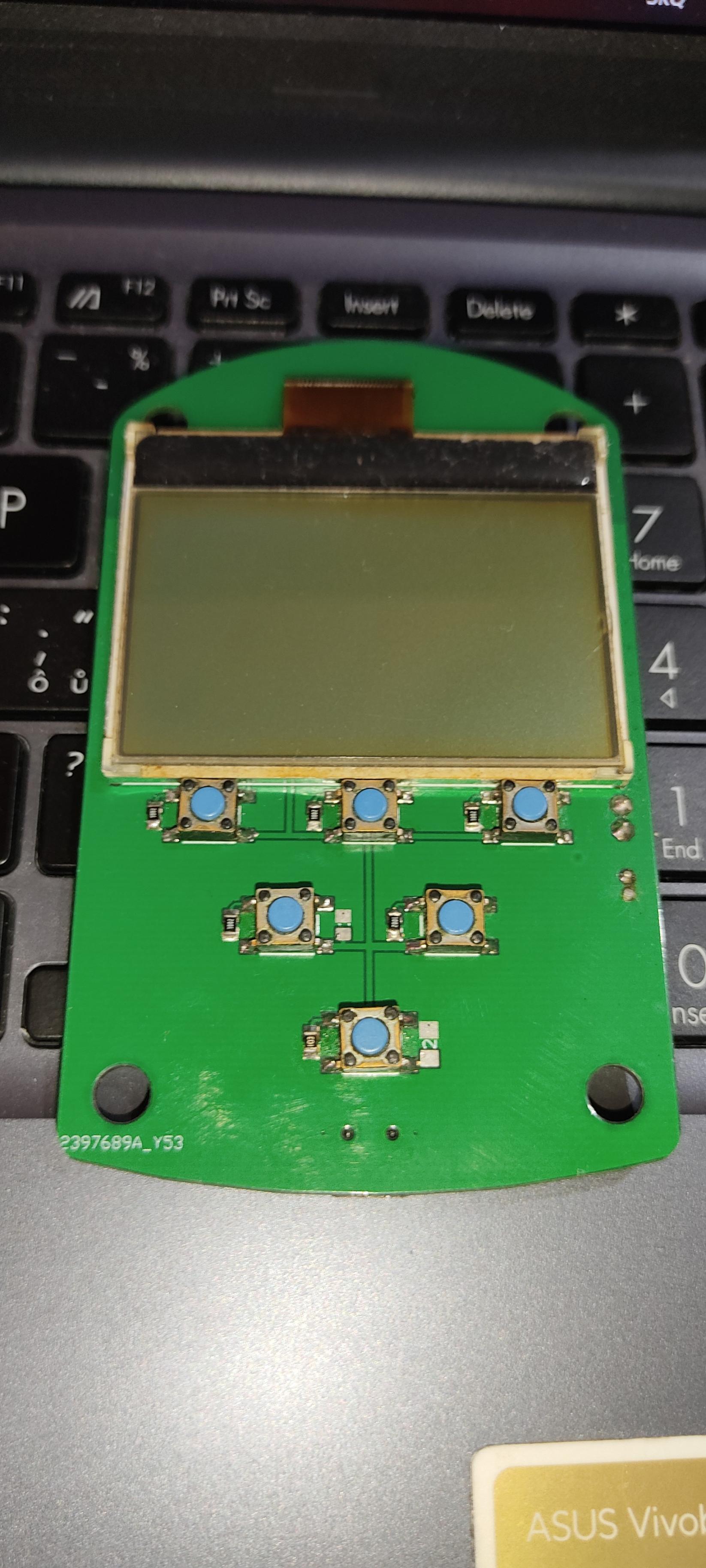

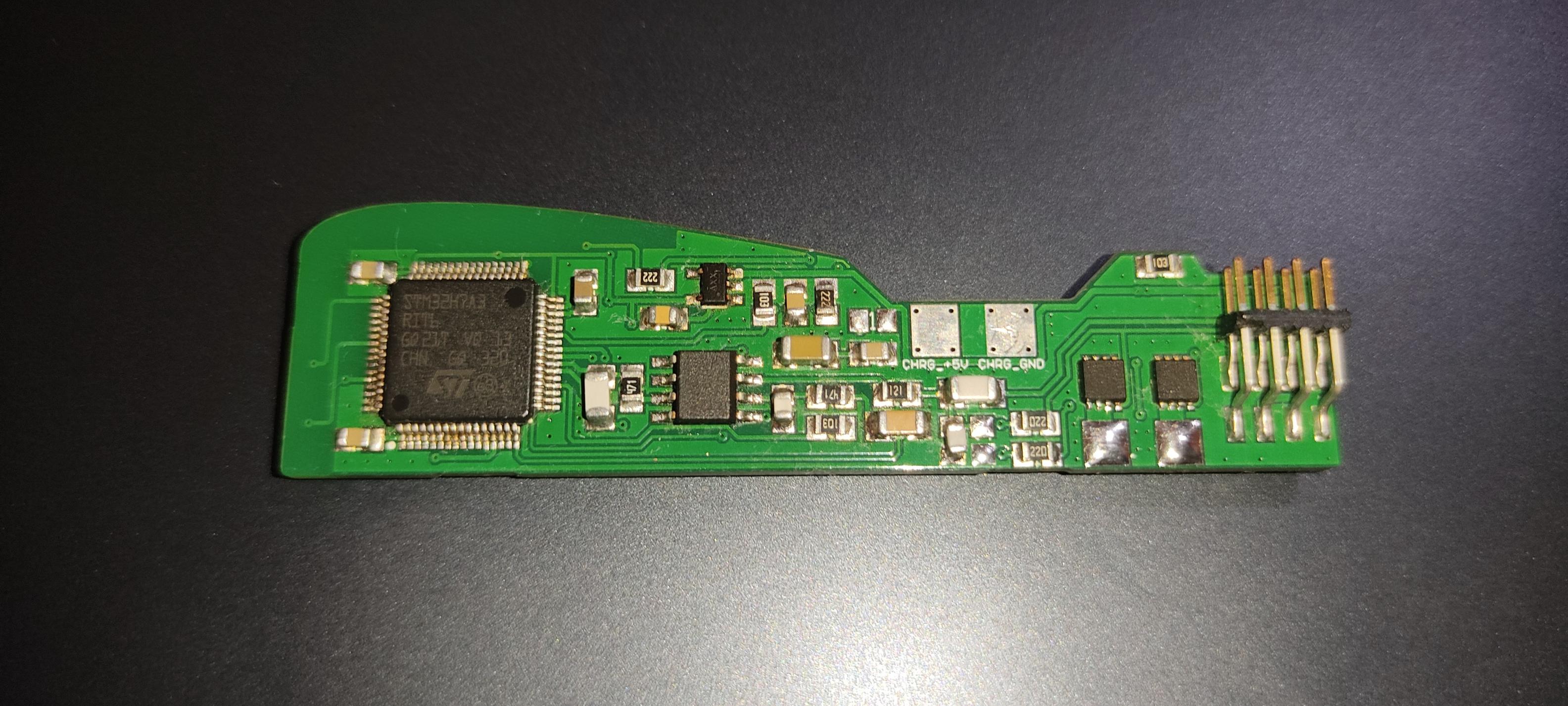

                Hello
                I am working on a Deus 2 clone project and I have an FMF coil at home and plan to open it up soon and examine the PCB which will tell us a lot about how this metal detector works.​
                  My project is based on the STM32H7 processor and, unlike the XP Deus, does not have an external ADC but uses an internal 16bit ADC. Here are my final PCBs which still contain small errors. I am testing the project on the original coil X35 22cm, if anyone is interested in working together on this project, we can create a special contribution on this forum.
