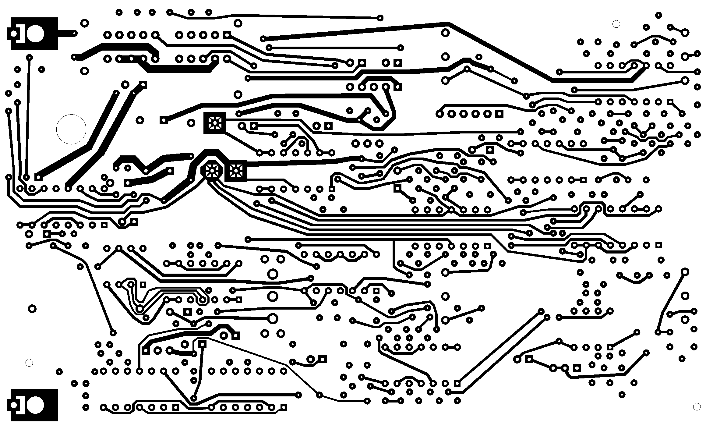

          bottom ready for checkout
          Have found some time to complete bottom. I actually started with top of PCB but would really need some extra pixels to that raster files to finish it.
          Ivconic I will send you .cdr and higher res. pictures on your email to check out - I'm sure there are mistakes (unconnected pads) I just could not decide on some parts - is it blur or copper.

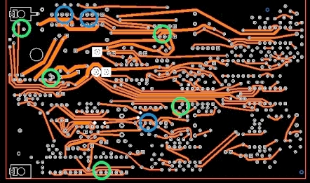

              corrections
              I already found few missing paths in marked blue circles. Ivconic please check green circles I'm not sure there... Also I have sent you an email.
              Waiting for those files to finish the board properly.

                Bravo!
                Yes you are right!
                I did some checking. Yes there are few missed connections.
                I corrected those and here is result.
                Although this can be corrected more but only in "cosmetic"
                manner. Some of "broken" lines can be straighten up etc.
                On few places there were to close lines,i corrected some.
                Anyway it is gonna be fine.
                Leto you did a great job! Also very fast! Congratulation!
                I hope you gonna do same with top side.

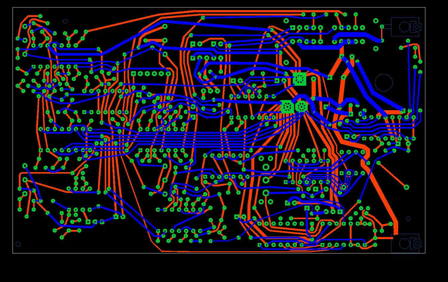

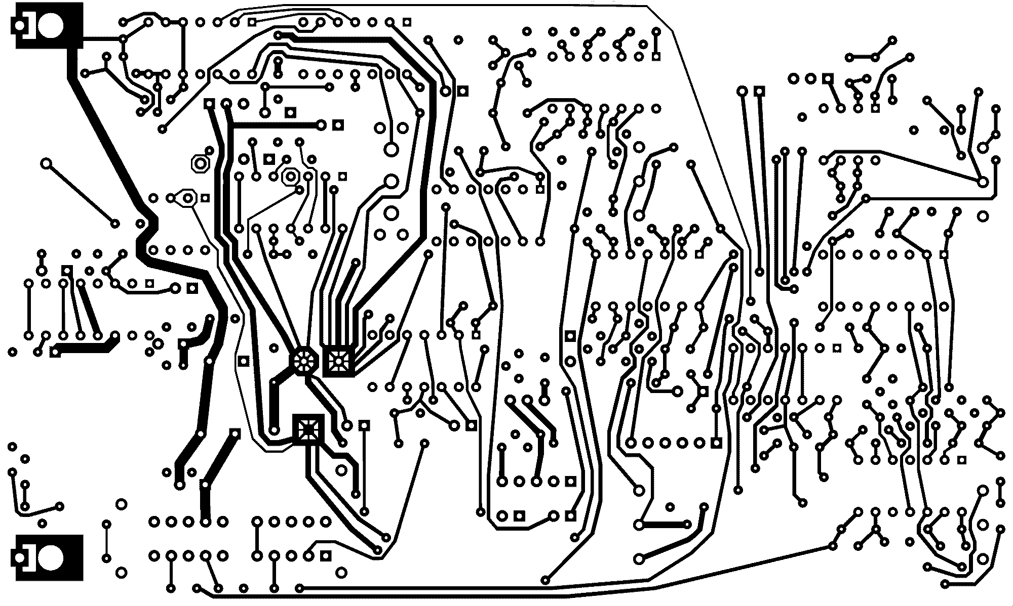

                        Ready for checkout..
                        Ivconic thanx for high-res picture you have send to me - it helped a lot and top is already finished.
                        I'll send you files to your email to check-out.
                        Please note that I have changed position of some pads and corrected bottom side of PCB as you suggested.
                        Here is the superposition of layers.
                          top side...
                          Here is top side, checked....

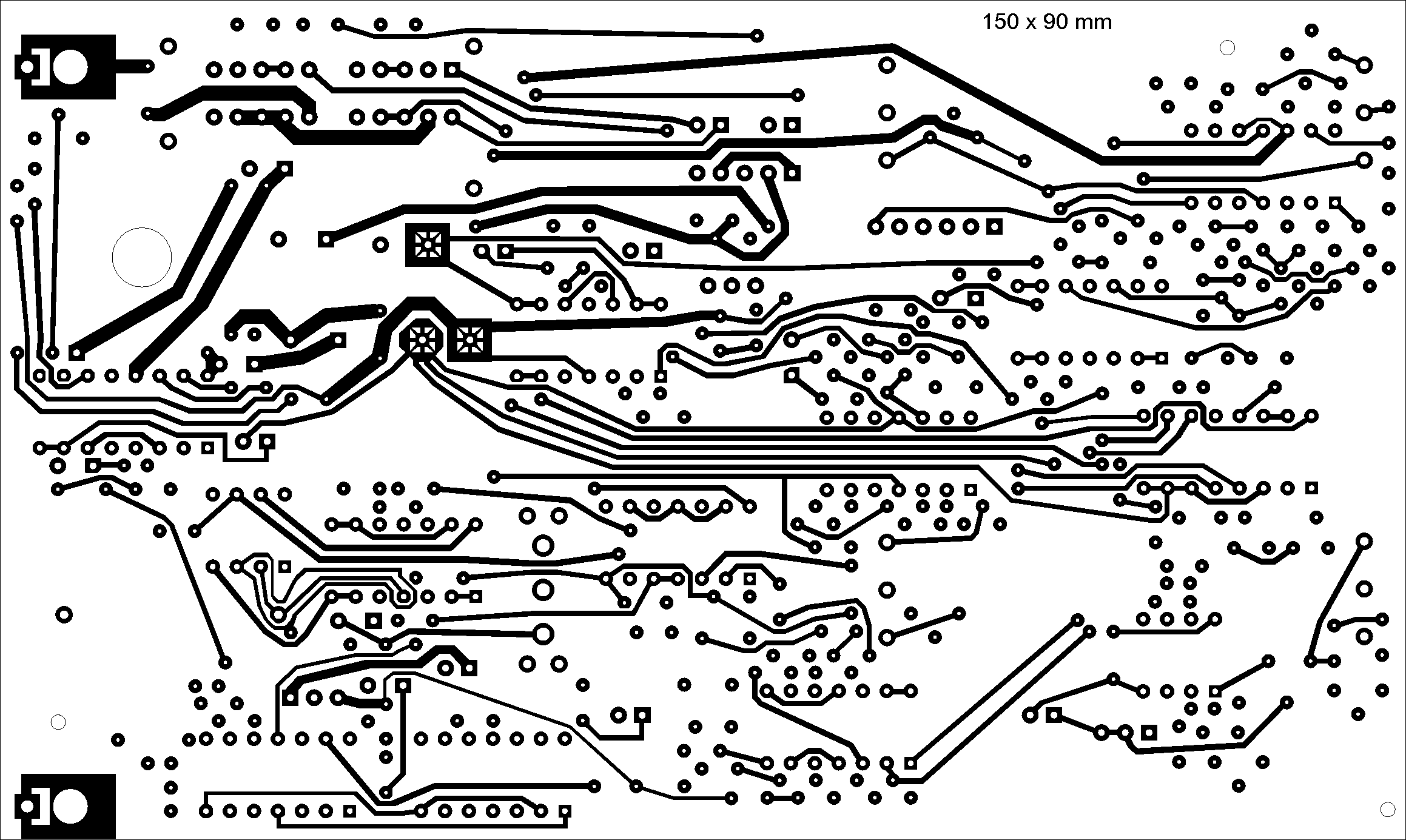

                            Hi, Ivconic when in your workshop could you please verify this:
                            1) measure your coil resistances (2.1ohm in estebans posts) on both coils (rings)- are they the same??
                            2) Do the same with inductance meter ...
                            even if this coil is actually transformer it is probably not hard to make. Ferite ring, wire, aluminium rod and few other materials is all that's needed.
                            3) why is that c46 so fat?? From shematic I can see that it's only of PP kind (I guess polypropyleen) on board. Is there any voltage rating on it?
                            4) What about shield (on shematic drawn around coils)?? Toroid does not need lots of shelding but what about loop? is it constructed coaxial? Any ideas?? Ivconic whats the type of cable from board to coils??
                            5) probably stupid question - Is R1 realy 22M??
                            I have not checked the availability of semiconductors(+ics) yet....
                            Thank you.
                              too late to edit
                              7) please measure the resistance of L1, also can you measure wire and ferite ring diameter of L1?
                              Also problematic seem U10 (78540) I realy do not know what this is?? and U11 (14584-B) is this the same as 4584 logic IC??
                                fat cap
                                Hi Leto,
                                C46 is so fat because it needs to be high
                                insulation resistance, yes polypropylene ,
                                higher voltage the better, will need guard
                                ring traces, and "keep PCB clean" in this area
                                from fingerprints and grime.
                                look up insulation on capacitor you use.
                                sometimes this is hard to find.
                                reduces DC drift of this part of circuit.
                                more fun if not drift.
