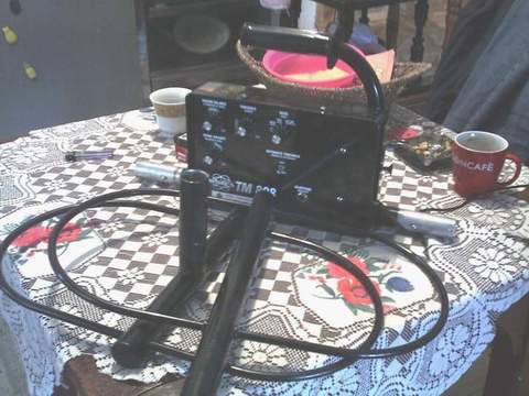

    A friend retreived White's TM808 to me few days ago.For the first time in
    my life i had chance to see and test it properly. I have very positive
    experience with it. I already heard in the past that some people claimed
    TM808 is not so good as advertised,but now,having my own experience, i can
    say; yes it is very good device,working as claimed on White's advertisements.
    I guess, the main thing about it is that man should understand how to adjust
    it properly. This type of metal detector is quite different than ordinary
    IB's,so if you have previous experiences with some IB....well,you better do
    not rely on those. The main point is that "reseting" device will limit
    depth to range proportional with range were the nearest conductive material
    was at the time of "reseting". So if you lift TM 808 high over the ground and
    "reset" it, later settle to normal position and fine readjust "Threshold" to
    gain no sound or very "mum" sound, than you'll gain maximum depth with it.
    Adjusted like that TM808 is very sensitive, and can detect large items over
    the 4 meteres deep. When i said "large" i mean item as standard oil barrel
    and larger. It is also very useable for detecting cavity,cave,tunnel etc.
    I am still planing to do more tests with it, but my main interest is to do
    reverse eng. on it and make another one. Since i do have original,it should
    not be some problem. It will need some time.I am planing to reassemble unit,
    make some draws,unsolder all components,copy pcb,later solder all over again,
    assebmle it...and that is all.But! I do not intend to reassemble coils.
    No way! Since those are assembled and glued hard,closed in a pipes and it should
    be very difficult and risky to open those....

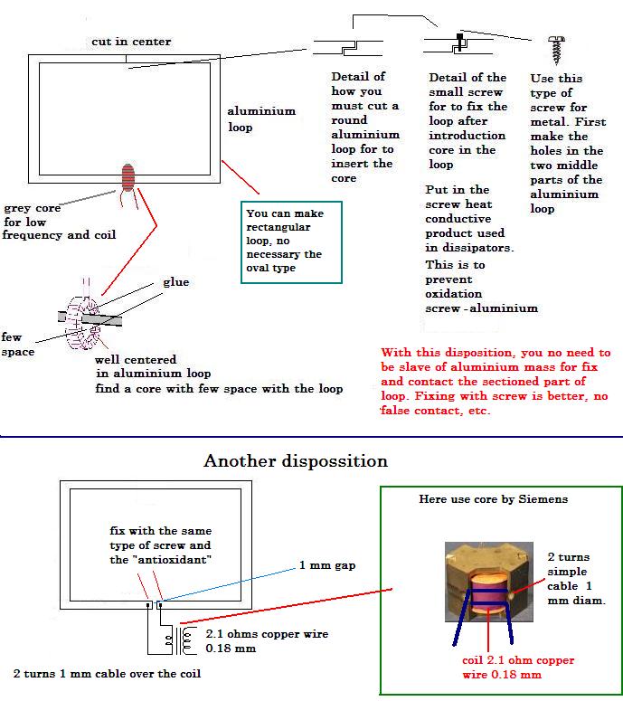

    So i was asking is anybody knows any data about coils for TM808 ?
    I think KT315 already posted some about TM808. But posted pcb was SMT.I am not
    working with SMT cose do not have conditions.Now i have chance to do it on
    conventional way. But about coils i do not know any data yet.
    Also i do intend to post pcb draw here when prepare it.
    Anybody interested to join this subject? Any datas for coils?

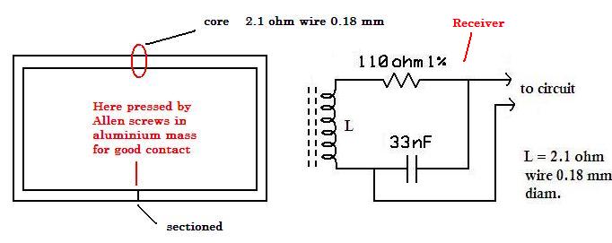

    1. About TM808 coils if i remember right Esteban sent a schematic with coil transformers (it is one loop coil). Now i am at work but when i will go home i'll see at PC because maybe to have the coil details.

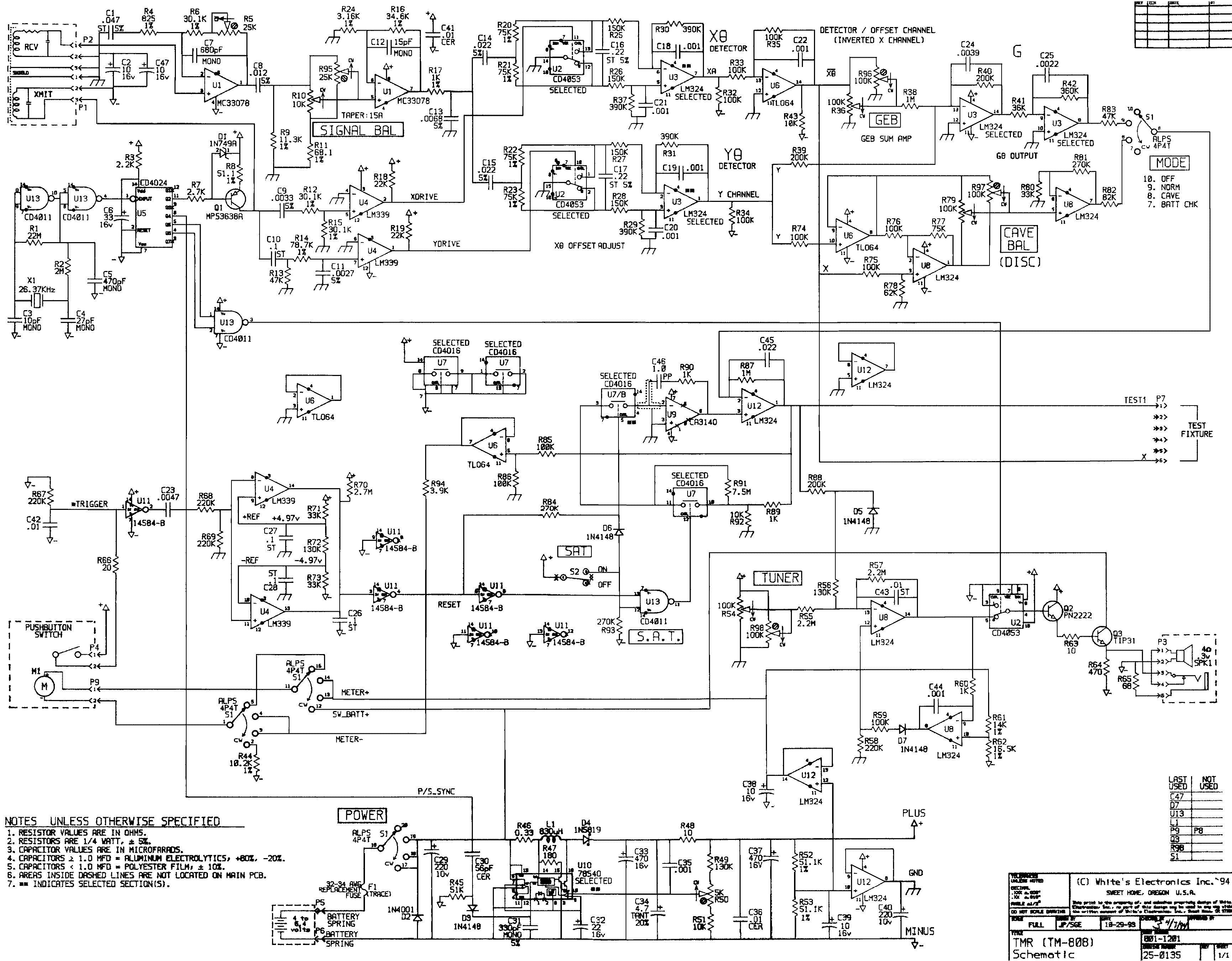

        Yes i have the schematic of TM808 from this forum. I attach it
          The PCB done without part of opamp U6 (legs 8,9,10) and without part of U8 (legs 1,2,3 and 5,6,7, (cave balance channel)). U6 changed to MC 33078.
            Hi Ivconic. Go to schematics....TM808 Schematics by Anatoliy and read a text from Esteban about coils. You must take wire 0.18mm and turn it around the core until to measure 2.1 Ohm.

              About Esteban hints on coils...well...i am not sure at all.
              Also i did not understood him well?? On first examination on coils i asume that there are ordinary windings inside,but closed in pipe which role is to form faraday cage.....no transformer or simillar at all. I am a bit confused about Estebans post...? Maybe Esteban should come here and help a bit?
              Esteban,can you explain a bit more?
              I was thinking anyway to wound some windings and try....i'll see later.First i have to finish pcb..

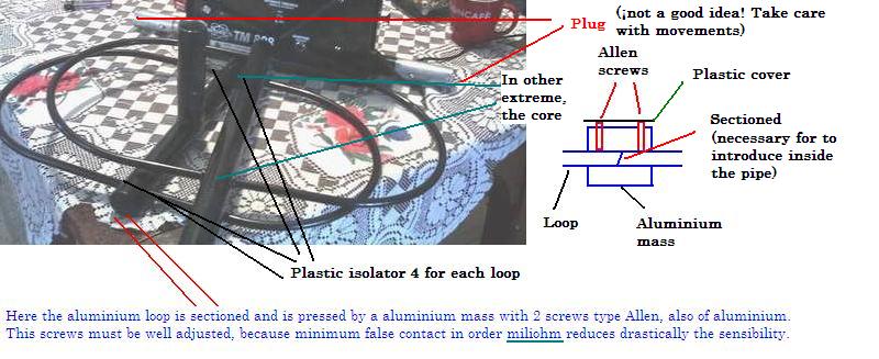

                I repair a TM808 in last the 80s, the causes of fail was the 3140 IC. This detector is good, but in very wet area (soil and air) produces much falses alarms. In dry terrain is very sensitive. Was in this opportunity I make same meditions in the coil. The sectioned aluminium loop is "reconnected" in a aluminium cilindric mass via 2 aluminium Allen screws, so the loop is closed, as a shortcircuit, no gap. This is the secret of major transference in transmitter and good receptivity in receiver. Here the ubications I remember:
                  Many thanks Esteban!
                  Thank you very much Esteban! THis will clear up a bit my doubts about coils.
                  I was asuming wrong about those.
                  About core, do you know dimensions?
                  Also i was thinking to make ordinary coil with some wire windings? How about that?

                    ...i can say; yes it is very good device,working as claimed on White's advertisements.
                    I guess, the main thing about it is that man should understand how to adjust it properly. This type of metal detector is quite different than ordinary IB's,so if you have previous experiences with some IB....well,you better do
                    not rely on those....

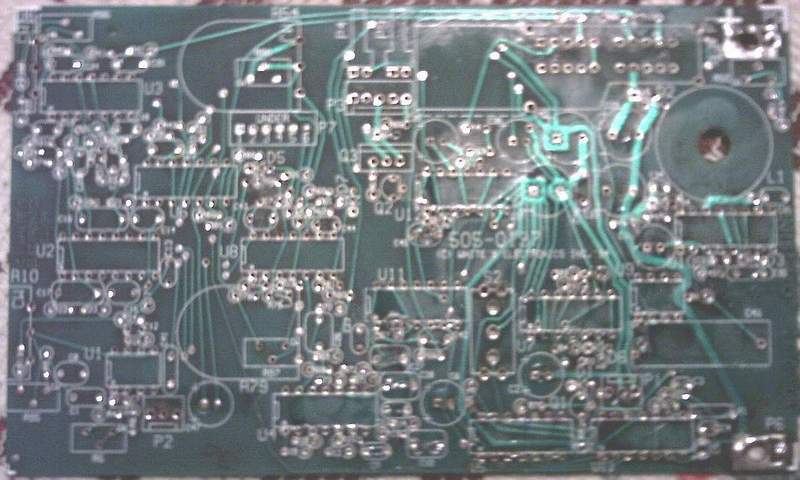

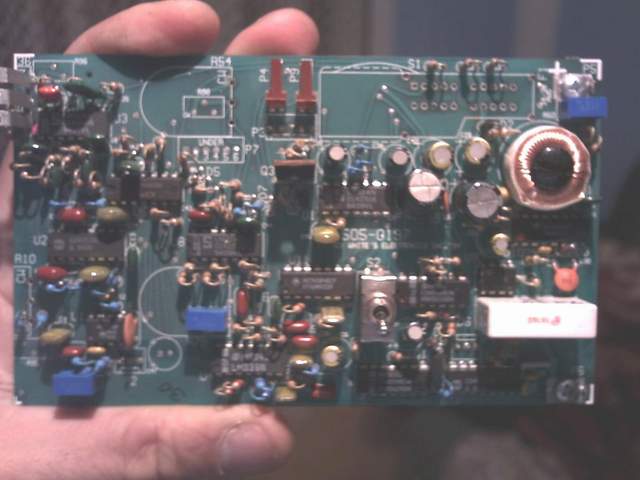

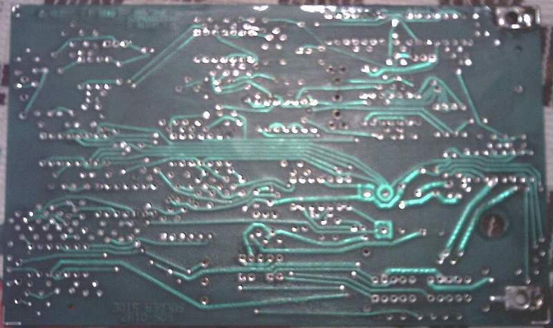

                      So,as planed,first step is finished. I just unsoldered all
                      components from pcb. To tell you the truth it was "labour".
                      But,have to say, White's used extra quality materials here.
                      Tribute to White's. The very best ever prepared pcb i saw
                      in my life. Holes are metalised,pads,vias superb!
                      I used my Salomon soldering iron,which is very good and
                      neither one damage occured! Pcb need some cleaning,so when
                      done, i intend to scan it on 600dpi.Later, using Corel Photo Paint
                      i intend to redraw all over photo,do some more cleaning,sharping
                      and finalizing to make file for offset printing.
                      I done reverse eng. same way,so many times on much originals
                      so far, but i have to repeat, this pcb is best quality i ever saw!
                      For now here is blured photos(my camera is modest).
                      I'll also post scans when done.

                      Esteban,although you explained pretty good, coils here,please can you
                      do some extra work. Can you use paint or simillar and draw more
                      preciselly inner composition of coils.. I didnt get quite clear
                      picture of those yet.Call me stupid,but i would like to be sure
                      what is all about.Dont want to make any mistake when making those.
                      Thanks in advance! Also everybody else, if somebody have pictures
                      draws&stuff about those coils,please come here and post.

                        Well, what it made us :confused: and you spoiled it :mad: ??? I will show the photo to my children to eat all the food (he ..he)

                          Crikey!
                          The quality of construction may be good, but it looks like a mad man did the PCB tracking.

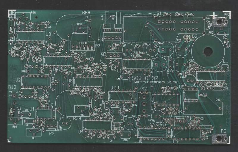

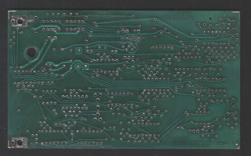

                            Hi
                            Hope this can helps.
                              scans
                              Regards to all!
                              Esteban you done great job now! Thank you!
                              Here is scans....Origin files are HUGE!!! 27Mb's, so it is quite impossible for me to upload those anywhere....I done some compression and here they are...I hope this degraded will done job anyway...I intend to post offset files when prepared, but it will take a week or two for me to done them...
