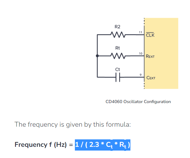

      • CD4060 does not have Q0, Q1, Q2 and Q10.
        For 52740Hz (26370x2) = 1042300 ohms and 22nF in Q3 = 6592,5Hz
        I'll try now....

        • "CD4060 does not have Q0, Q1, Q2 and Q10."
          Correct, and this is not a problem. If you use the 6.7xxx MHz crystal, you take the Q7 output and connect to the CD4024 input. We are trying to generate ( ideally ) 26600 Hz. This gets divided down by 4 to drive the TX circuit, and divided further to drive ( non-critical ) audio stages, and to synchronise the smpsu oscillator. If you use the 420 / 429kHz ceramic resonator with the CD4060, you use the Q4 output, and connect it to the CD4024 input.
          Furthermore: you can change which CD4024 outputs you use. The outputs used are Q2, Q4, Q5, Q6 . These could be changed to Q3, Q5, Q6, Q7, and you input 53200 Hz to the IC. This gives you options with you additional divider / oscillator. You can also use outputs Q1, Q3, Q4, Q5, and input 13300 Hz to the divider. These options may be useful, they may not, but they exist.

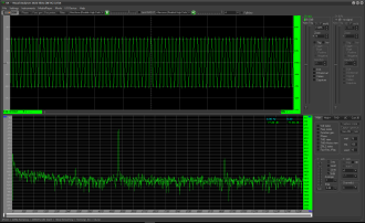

            • Visual Analyzer + Windows 10
              Oscilloscope, Spectrum Analyzer, etc ... perfect for tuning coils.
              Visual Analyser 27.00: free Windows audio measurement and media playback software. Choose the English or Italian site.

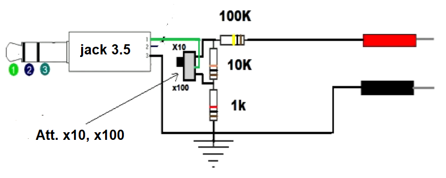

              • Probes for Visual Analyzer -> PC Sound In

                • Change the 1k0 resistor to 1k1, you will get better accuracy on the x100 range ( and a little bit better on the x10 range, too. )
                  • Thx Skippy, I will do.

                      • Regarding that scope input attenuator: If you want to get it "perfect", the 1k0 should be changed to a 1k2 in parallel with a 15k. This will give the correct 1.11111k value; but 1k1 is just in error by 1%, so it's close enough.

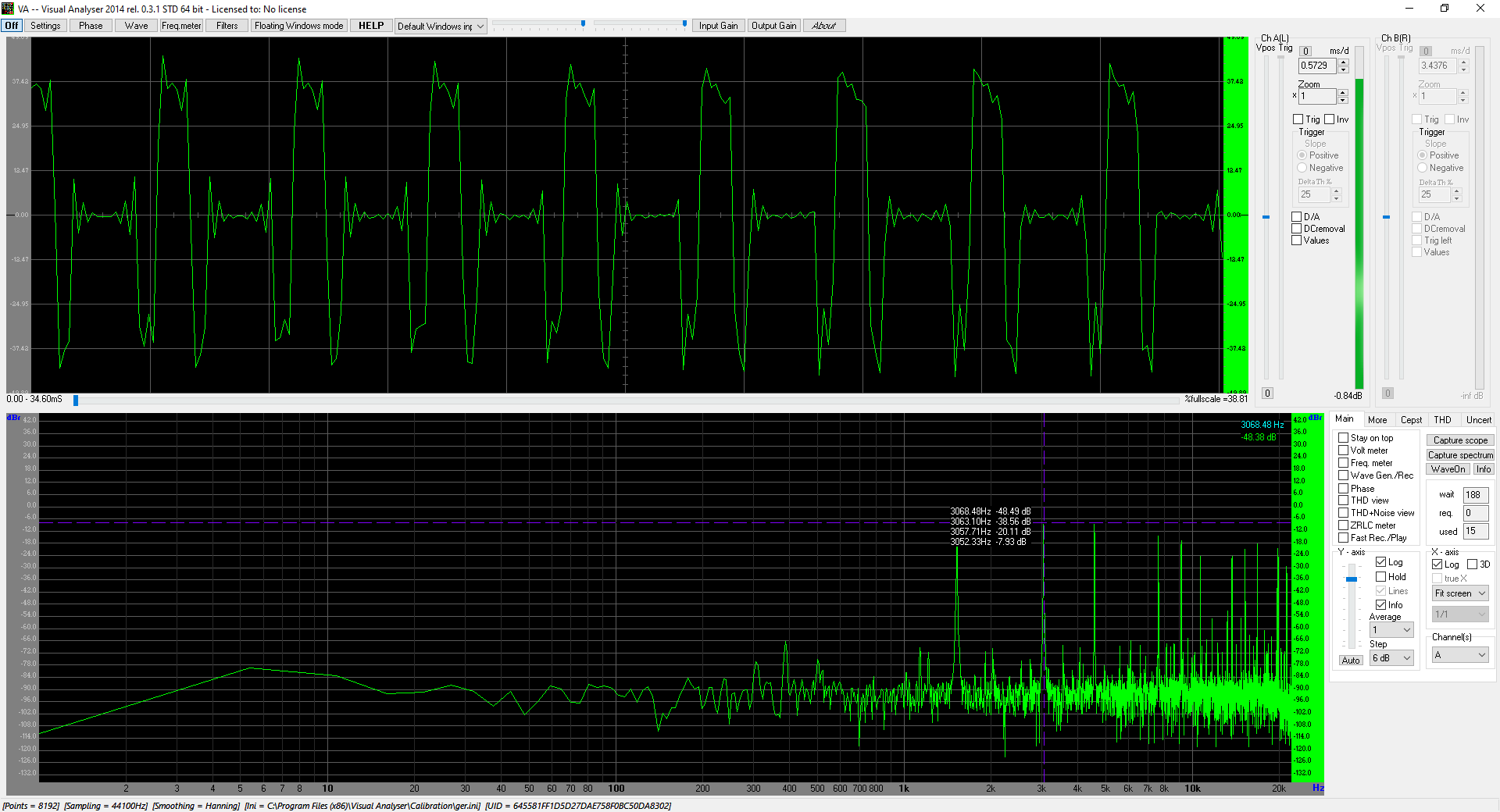

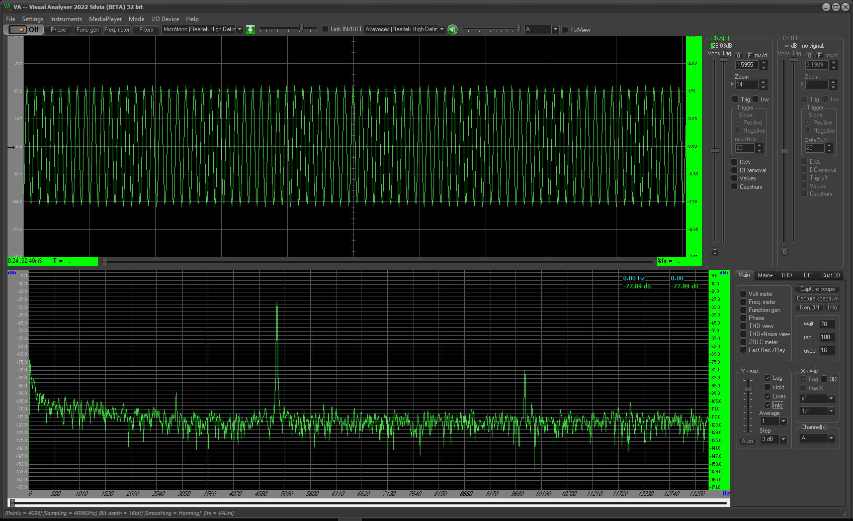

                        • I am using the Spectrum Analyzer directly without the attenuation since the coils work with millivolts.
                          With the Analyzer I have verified that the Cscope Metadec works at a frequency of 16,480 kHz and the Minelab Excalibur at 3,050 Hz !!

                            • Yes !, BBS Excalibur Spectrum, from 1500Hz, 3000, 4500 ... 21Khz (Sound card no give more..) :

                              • That's quite funny, and shows how troublesome sound cards are ... with few exceptions, unfortunately. Your scope trace clearly shows the full cycle of 3.125k, as quarter-cycle; half-cycle; quarter-cycle. Then inbeween is absolutely nothing, where in fact there are 8 cycles of 25k. If I recall, it's a quarter-cycle, then 15 half-cycles, then the final quarter-cycle. Your trace just shows "ringing". It's not ringing, of course. If you take a square wave, and remove the 7th, 9th etc harmonics, you are left with a waveform that only has fundamental, 3rd harmonic and 5th harmonic. This looks at first glance like terrible ringing .... but notice it starts "ringing" before the big 'edge' , not just after one.
