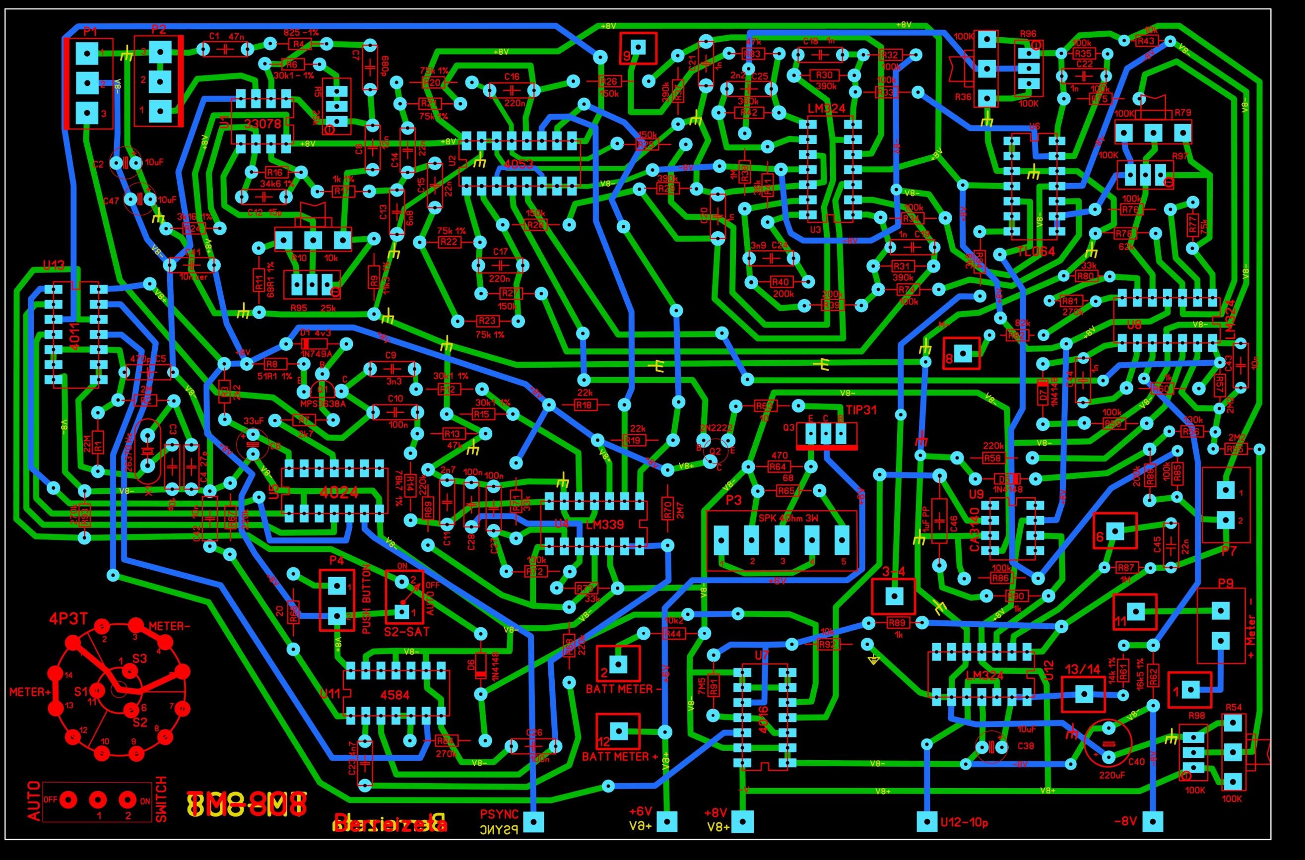

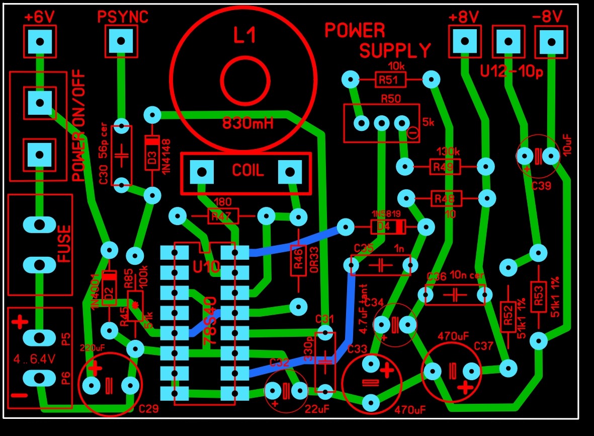

  • My version of the TM808 finalized and revised with the schematic :
Name:	TM808 PCB 2L ALL.jpg
Name:	TM808 POWER ALL.jpg
    [ATTACH]n412688[/ATTACH]

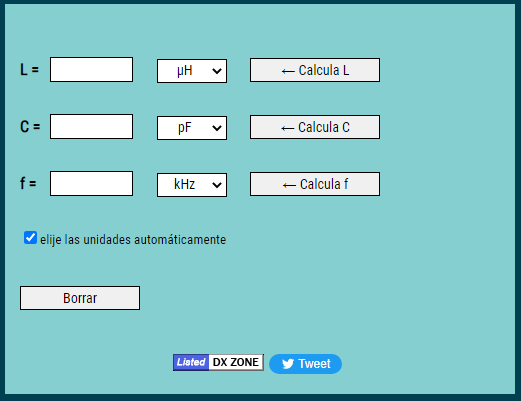

        • Calculation of the resonance circuit of a coil, online :
          Calcula la frecuencia de resonancia, inductancia o capacidad de un circuito LC. Calculadora gratuita para radioaficionados.

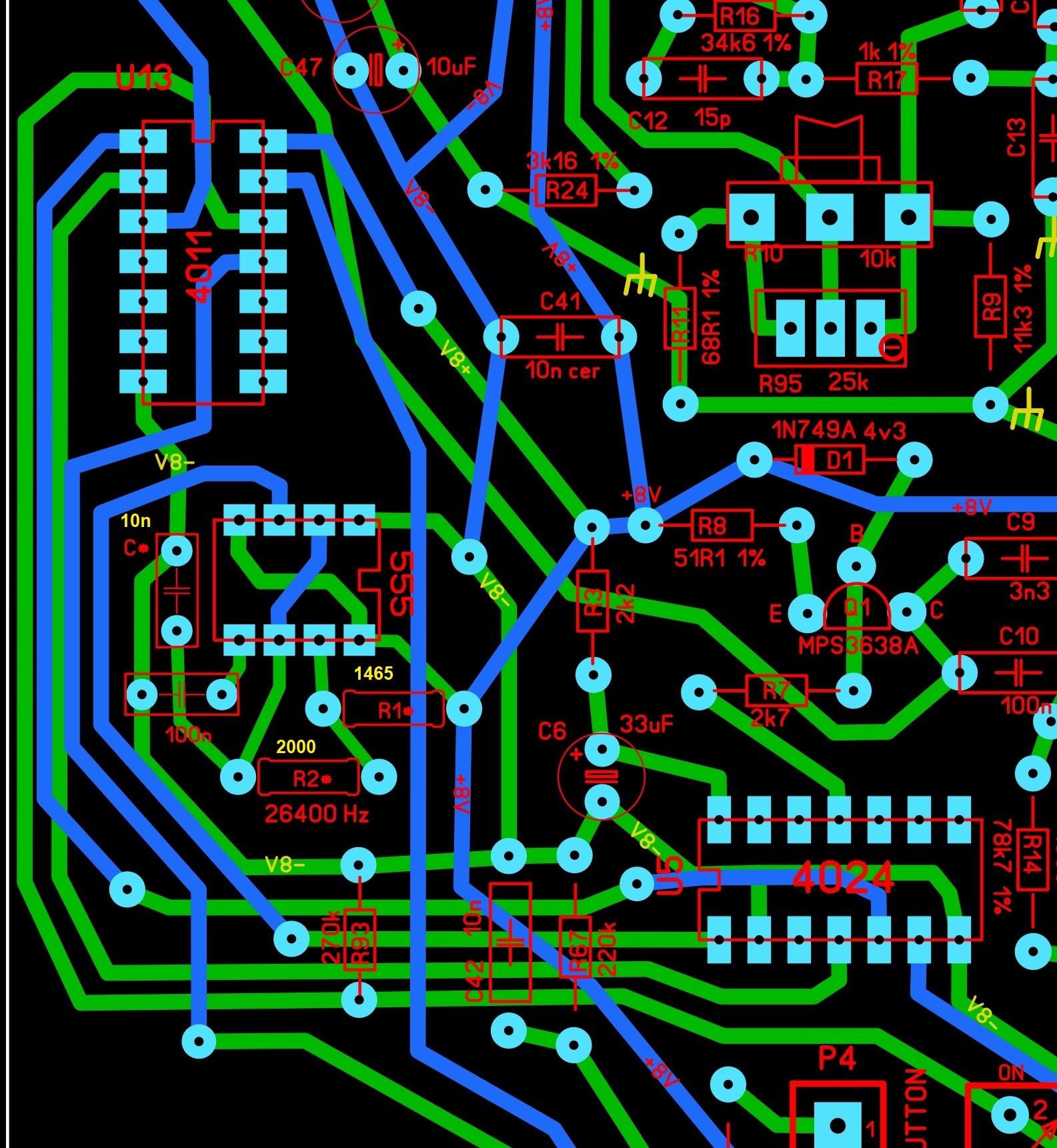

          • Solution with 555 :
Name:	555 to 4024.jpg
            • Your crystal problem could be solved by using a 420 kHz ( or 429 kHz ) ceramic resonator, and dividing it by 16.
              This gives equivalent crystal freq and operating freq of:
              420 kHz > 26250 Hz > 6563 Hz ( and 429 kHz > 26813 Hz > 6.703 Hz ) These resonators are used in TV remote controls, mainly, but also some radio IF circuits instead of 455 kHz.
              • OK, I will searching for one, thx
                • The resonators should be easily obtained, I checked eBay, there were several sellers. The oscillator circuit is similar to that of a quartz crystal, with some component value changes ( lower resistances, etc ) , so you should be able to use the existing 4011 NAND gates.
                  And the divide-by-16 can be done with any CMOS counter, such as the CD4024.

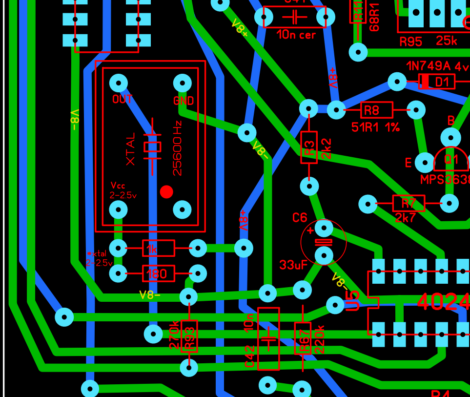

                  • I found an active crystal of 25600Hz.
                    25600/4= 6400
                    psync 1600,
                    800 and 400
                    • With Active Xtal 25.60 Khz :

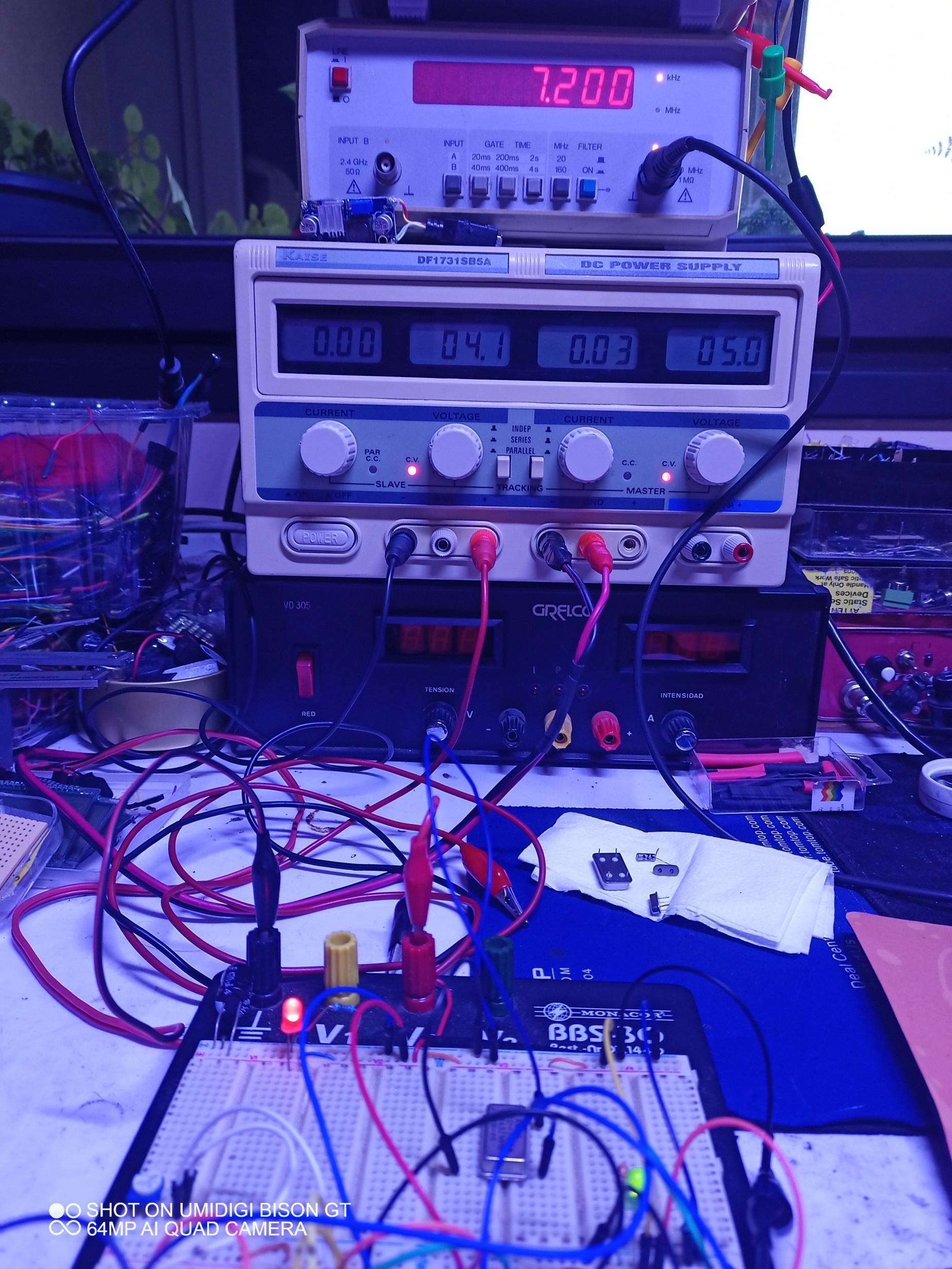

                        • I have been playing with an active crystal of 1.8432 Mhz (the lowest I have) and a 4060.
                          On pin14 (Q8*/256) it gives 7200Hz, and stays nailed for ever!.
                          As I can't find any 6600Hz multiplier I think I'll try the 25.6Khz (= 6400Hz), and adjust the coils to that frequency.
