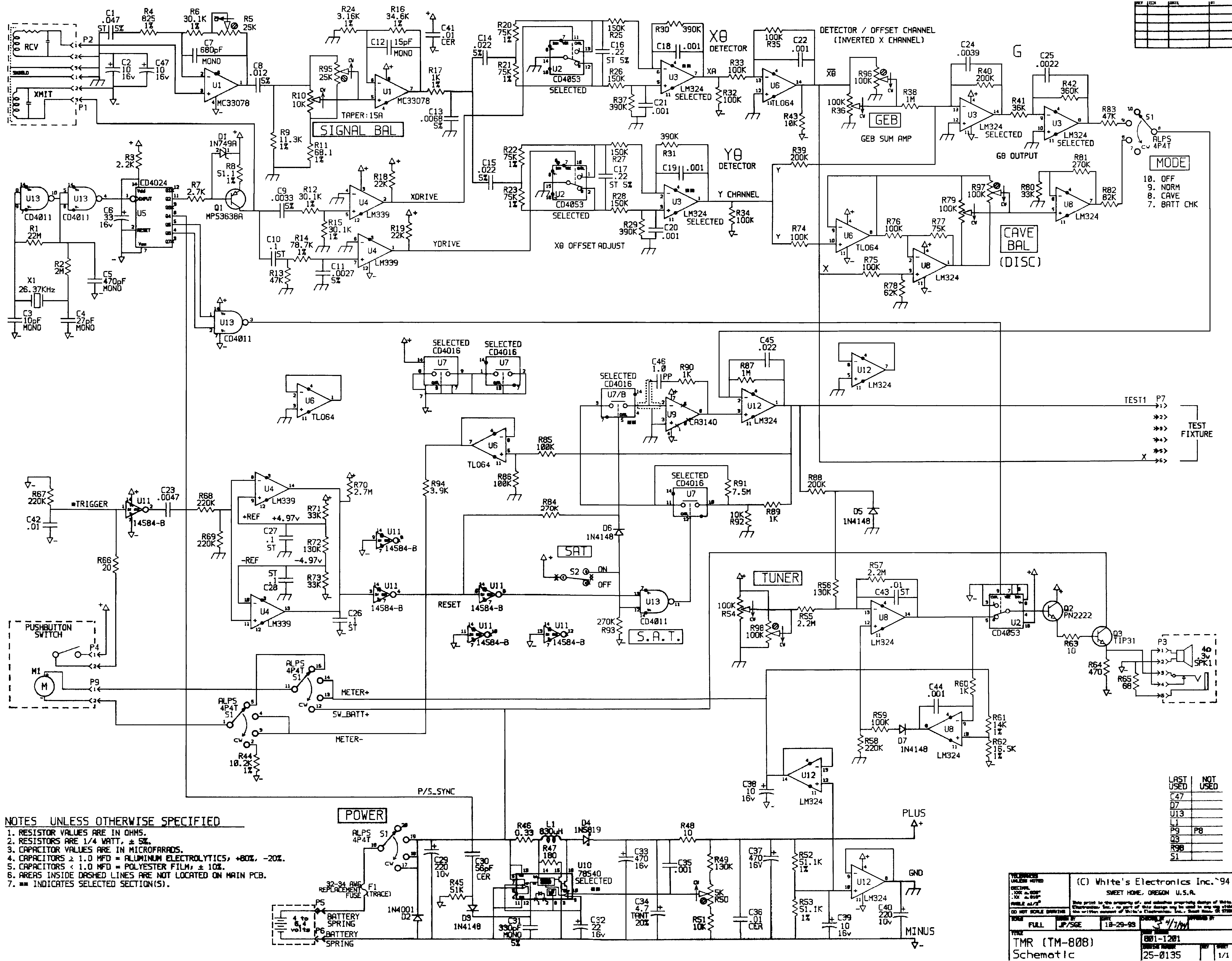

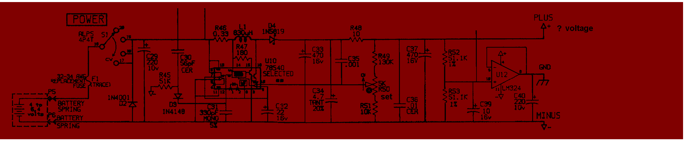

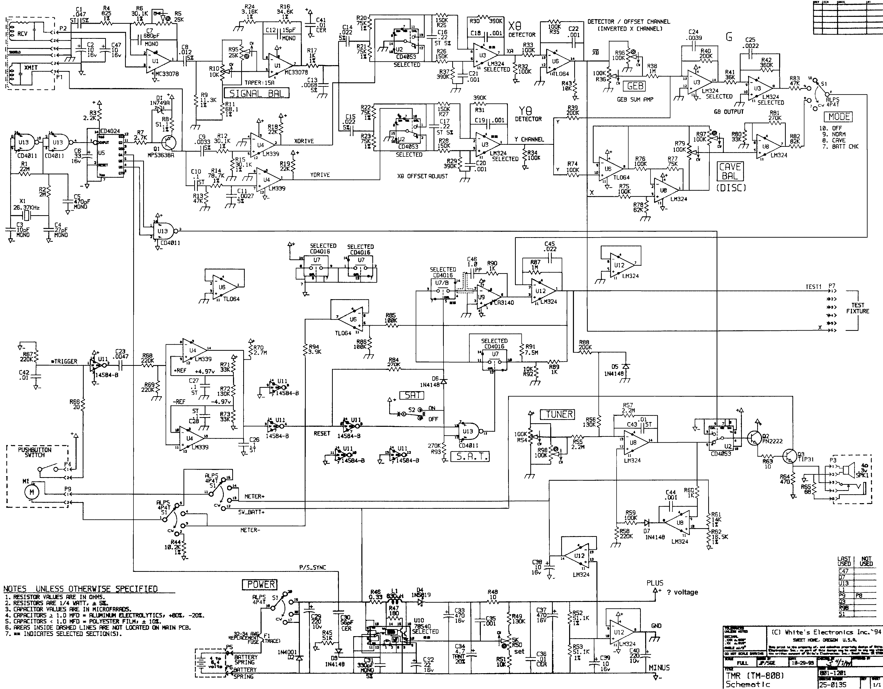

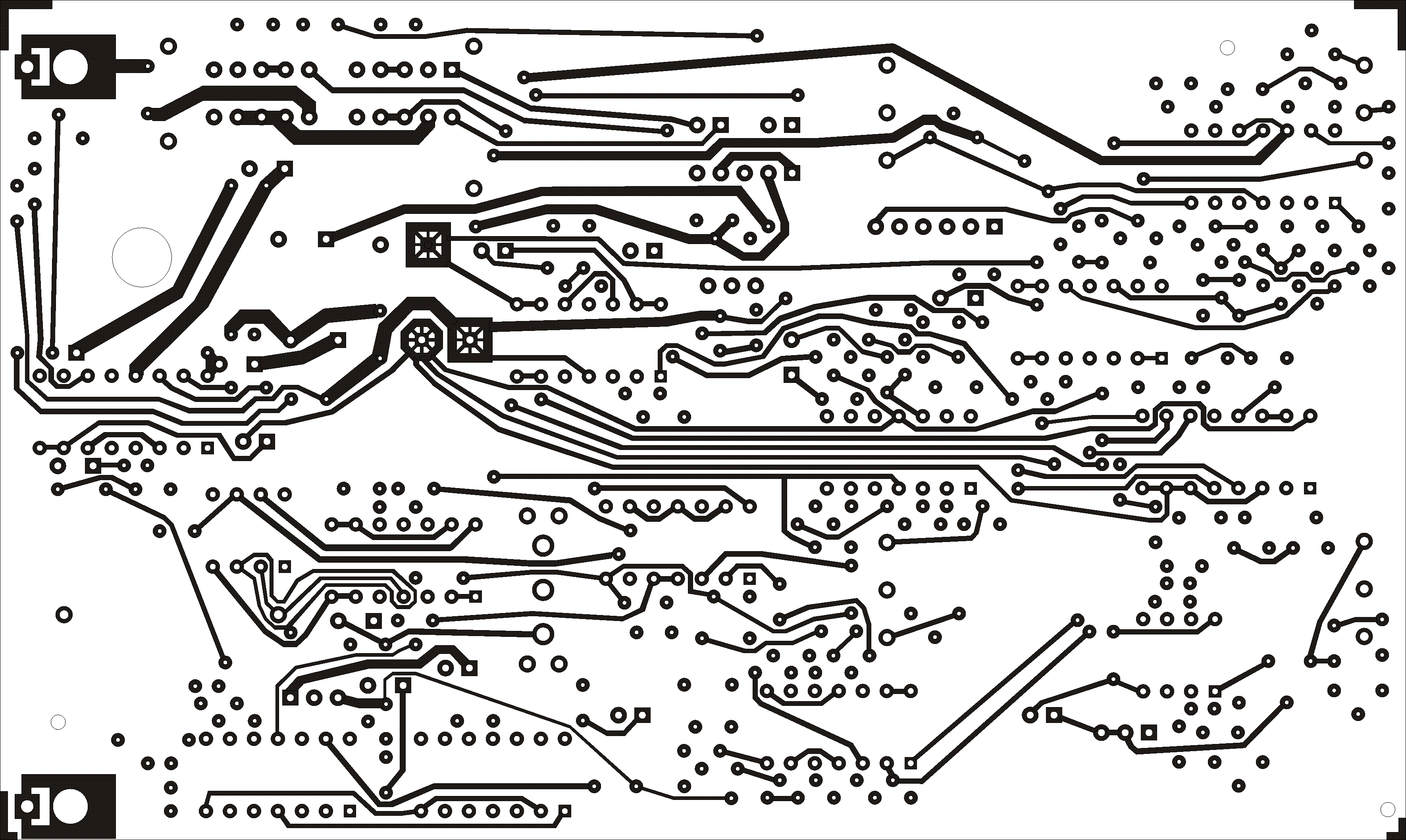

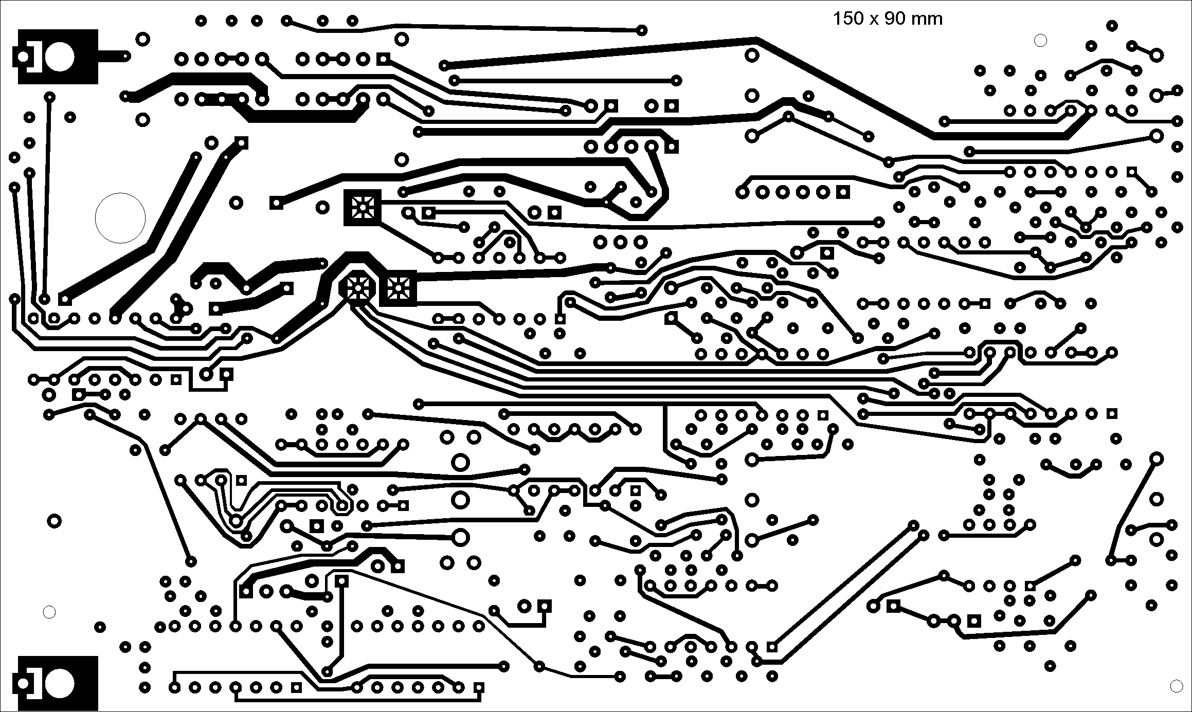

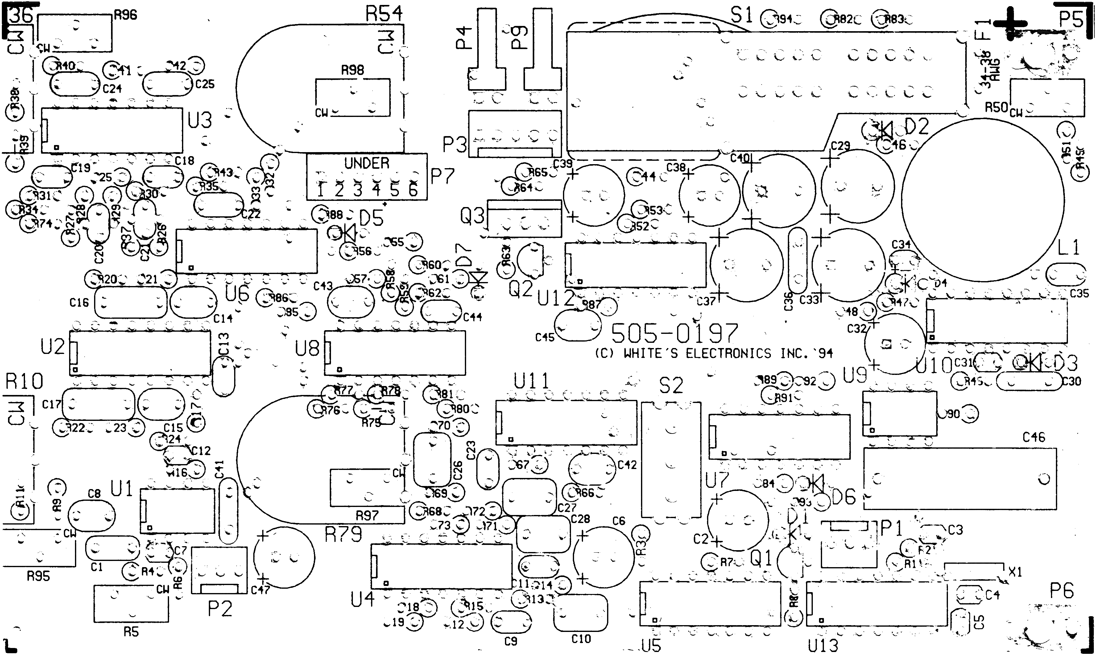

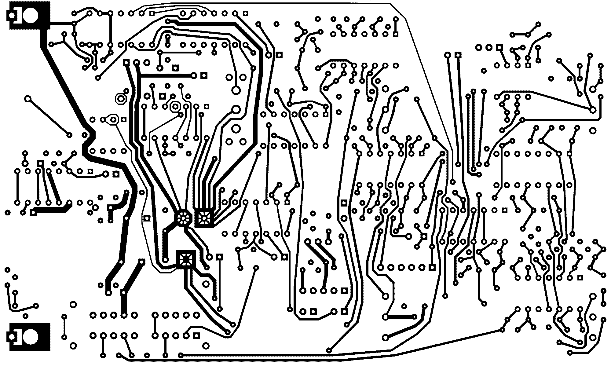

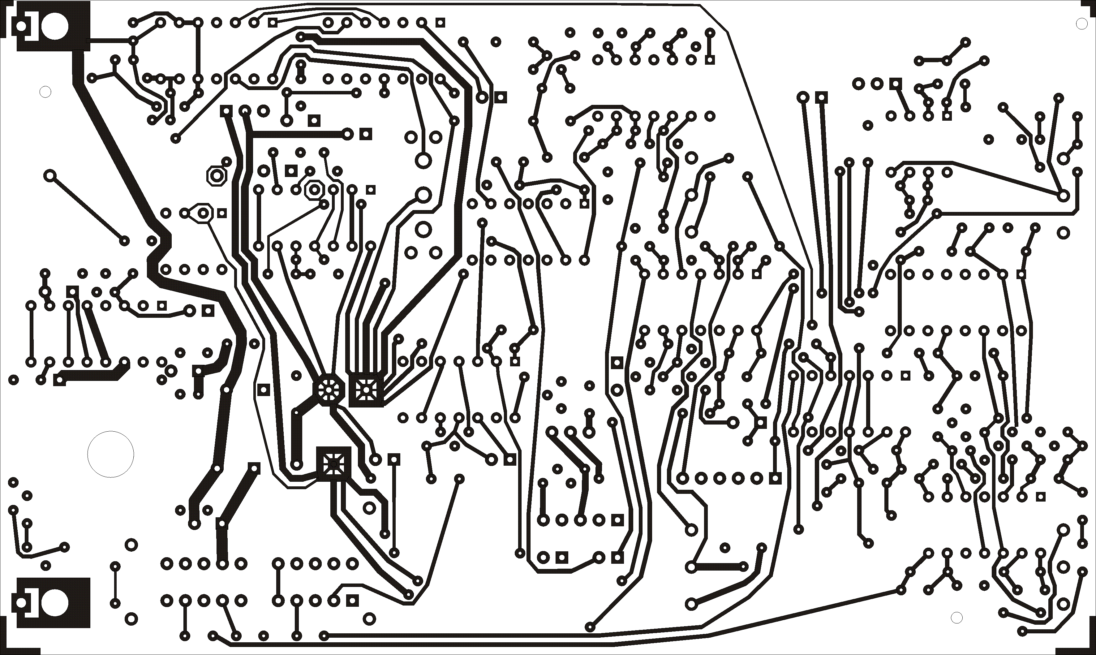

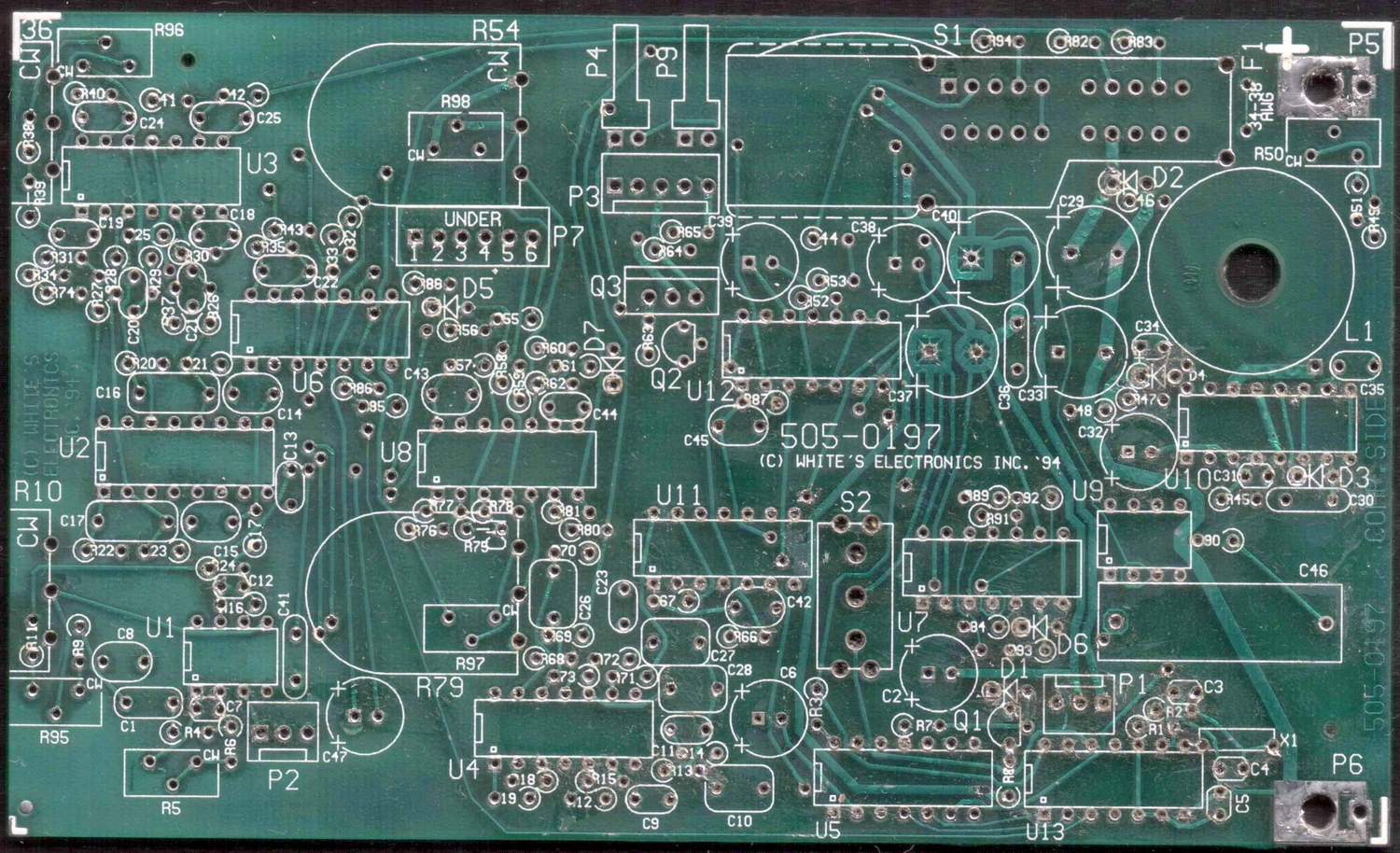

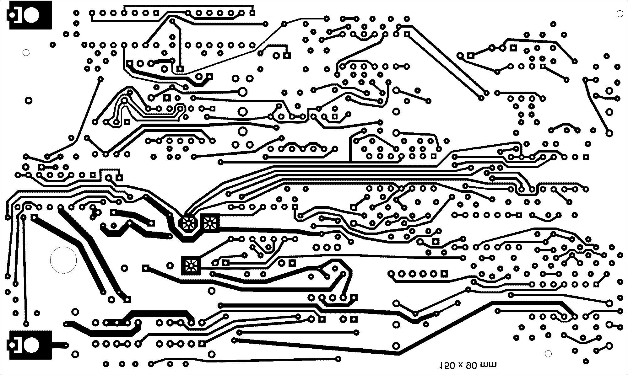

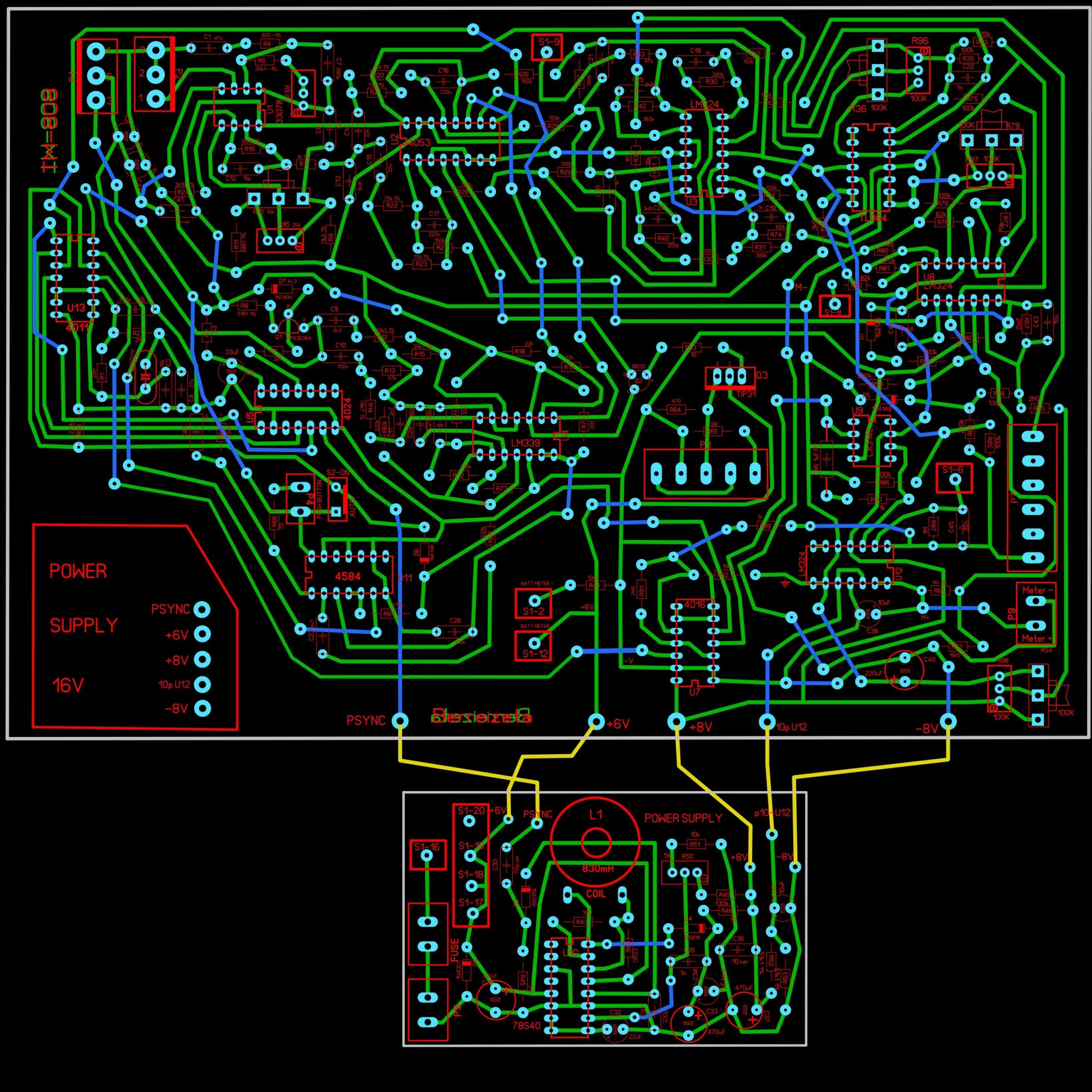

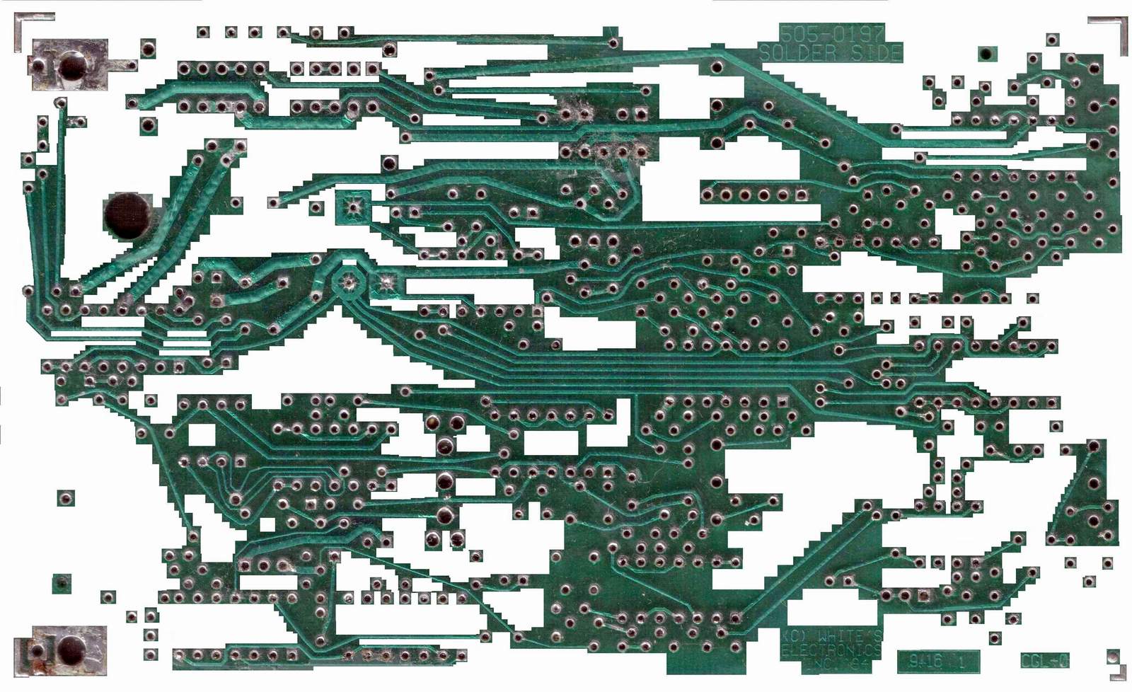

With rv 50 it serves to get a higher voltage at the output on integral circuits ,I'm interested in the output voltage ,I turned the trimmer rv 50 and I get voltage on integral circuits 12 ---- 14v, etc. ,which voltage to set it has at ic ?
This would mean that the voltage should be set to 15v ?!Originally posted by kt315 View Postyou know or do not know this fact that TM-808 is a part of 5900/6000 di pro sl, non-motion all metal mode part. ONLY one part.
if you open the schemaic of last you will sure see - +7.5 and -7.5V to gnd will give you 15V.
What would be a problem? I have the impression that the geb balance can not be set out on the ground it feels the ground always when I pump down to earth ?
I can not find a balance point !
schematic
