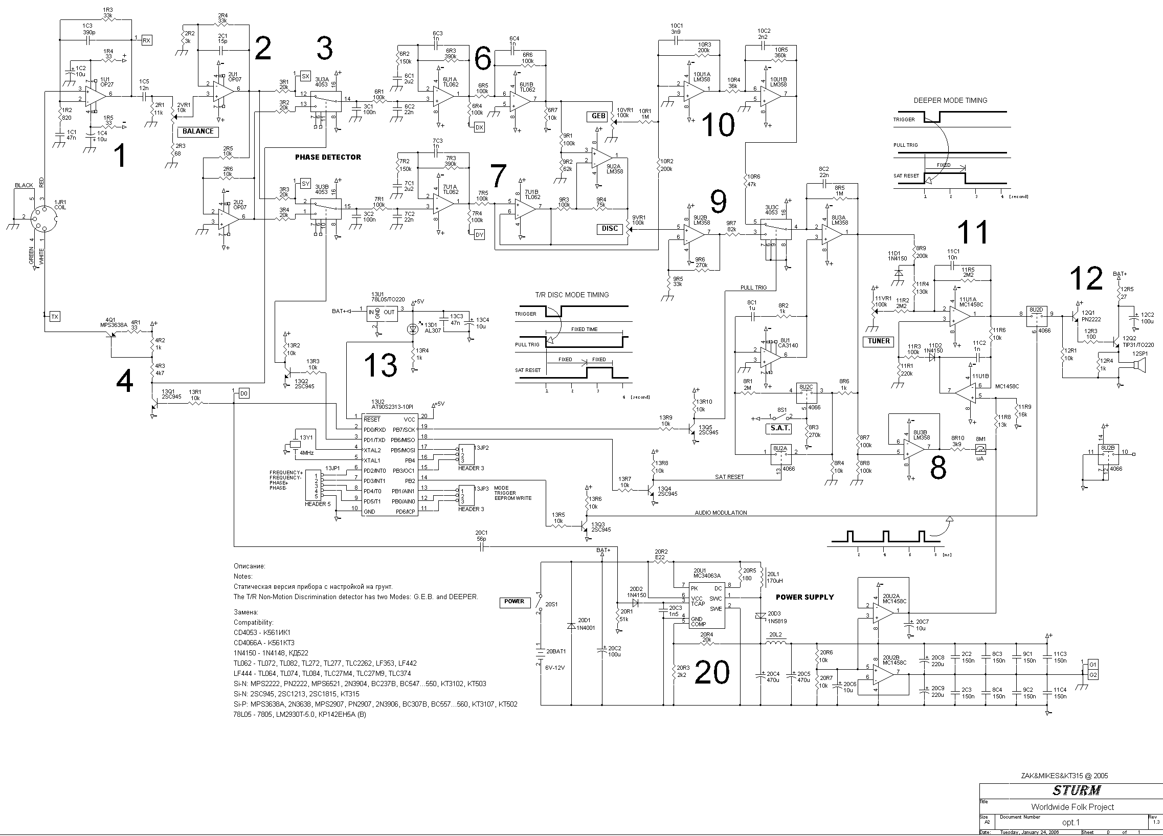

      • i used the ones on the following side:
        and i hope they are the right ones.

            I had shared this schematic many times. you can do the TM-808 with ANY frequency.

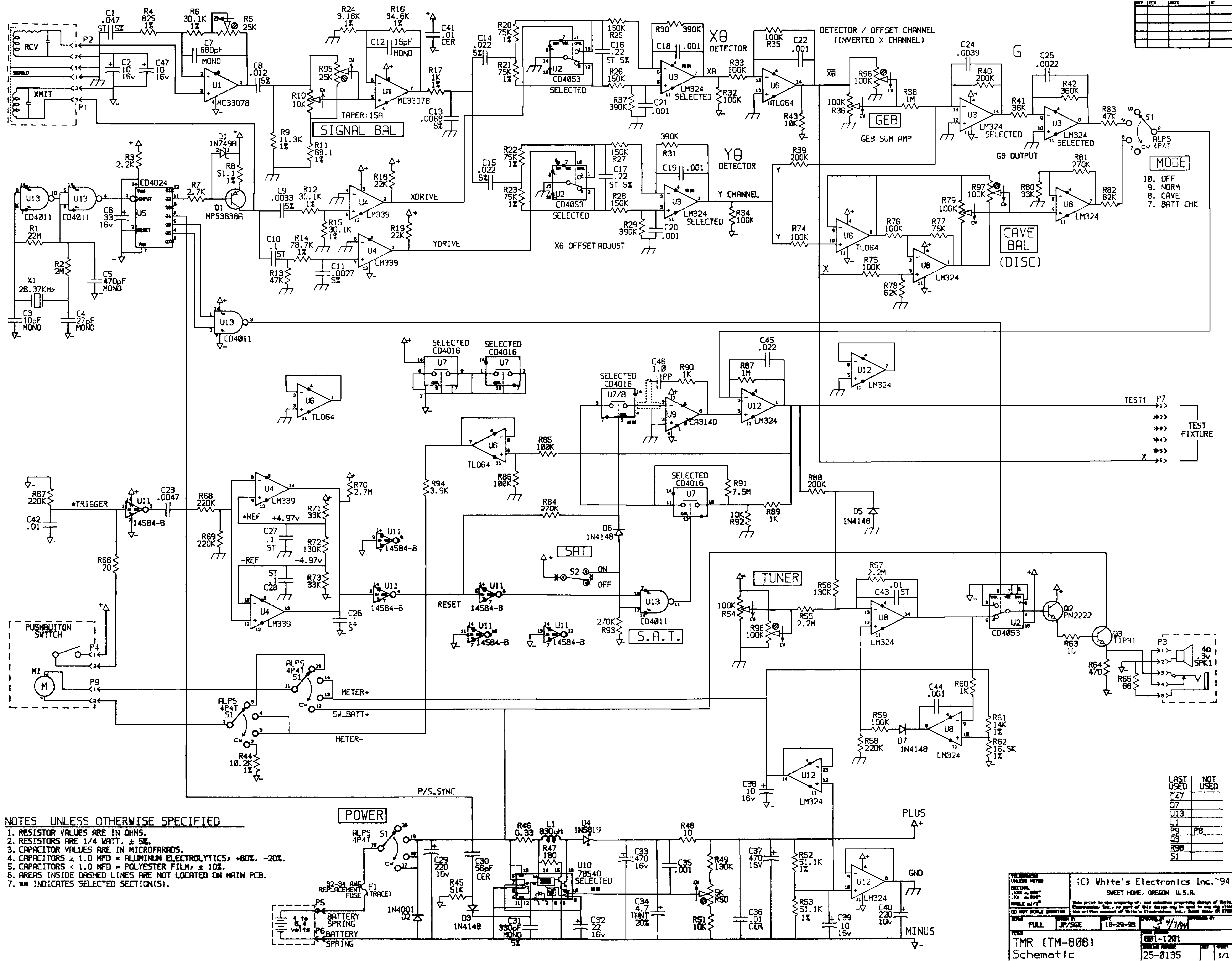

            • @ kt315: thanks for sharing... are there many differences between your shematic and this one?Click image for larger version

              in some other posts, the people (and so i) thought, its the right one.... its the earliest one i think with Cave-mode. I just dont understand the explanations in your last shematic: T/R Disc Mode timing, Deeper Mode Timing and the third unnamed one.
              @ wubian: i´ve a lot of work to do at the moment, so i won´t have much time for the project. A cooperation is allways interessting... But if my PCB is old, it wouldn´t help much to send you my (incomplete) parts-list (which i would first have to write on PC). I ordered the things just to get started and to check the real difficulty of the project. If kt315 says, that his latest shematic is the same as mine, i´ll continue the project. If not, it would be a pitty and a too big waste of time for copying this 808 and maybe i´ll buy it somewhere used or new. But by the way... from what country are you from?
