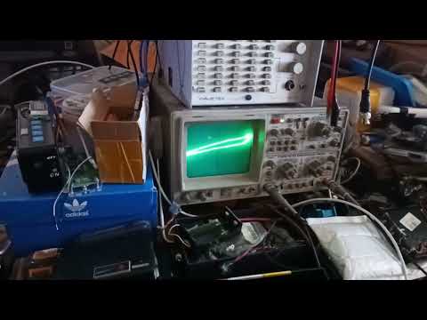

  • And from what distance it is react to the can?
    The goal is 90cm.​
    Telling you what? = My Tx - Rx system is 50% more sensitive. 40cm Vs 60 cm
    • Originally posted by pito View Post
      The goal is 90cm.​
      Cola can over 1m. Not measured precisely.
      No it was not my point. Your "Rx system" is not more (or less) sensitive because it is not detector yet.
      It is just wire and led. Once you make a real detecotr out of it ;you will see the real performances.
      Led indicates the distance from coils which you will have to use as minimal to be able later to achieve balance.
      • The system means post # 241and #242, not a complete circuit.
        Cola can over 1m. Not measured precisely. = 90cm, now just oscilloscope, when finished with complete electronics 150cm.
        use as minimal to be able later to achieve balance.​ = my minimal is 20cm. Smaller distance = harder to achieve balance, does not reduce sensitivity.

        • It's obvious that we don't understand each other at all, no problem.
          Do the whole detector and when you do then we will see what the real performance is.
          In any case, this forum won't hurt a little more ideas and experiments.
          I support that.
          • Cola can over 1m. Not measured precisely. = ??? ,
            In your video, the pipe is detected from a distance of about 60 cm, and there is more metal in it than in a can of coke.

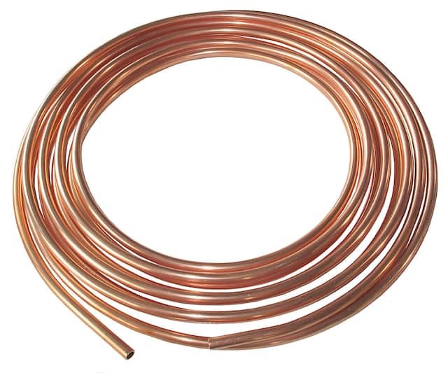

                      Coils = the most rigid is duralumin rod, if it is difficult to bend, use a torch.
                      If you are going to use pipes, fill them with sand.​
                      Before making final coils you can make good testing coils using soft copper tube, easy to bend .
                      Click image for larger version  Name:	copper-pipe-soft-1-4-x-10--37910481-ee26-4787-9103-3ce4af663c2d-jpgrendition.jpg Views:	0 Size:	66.1 KB ID:	415435​

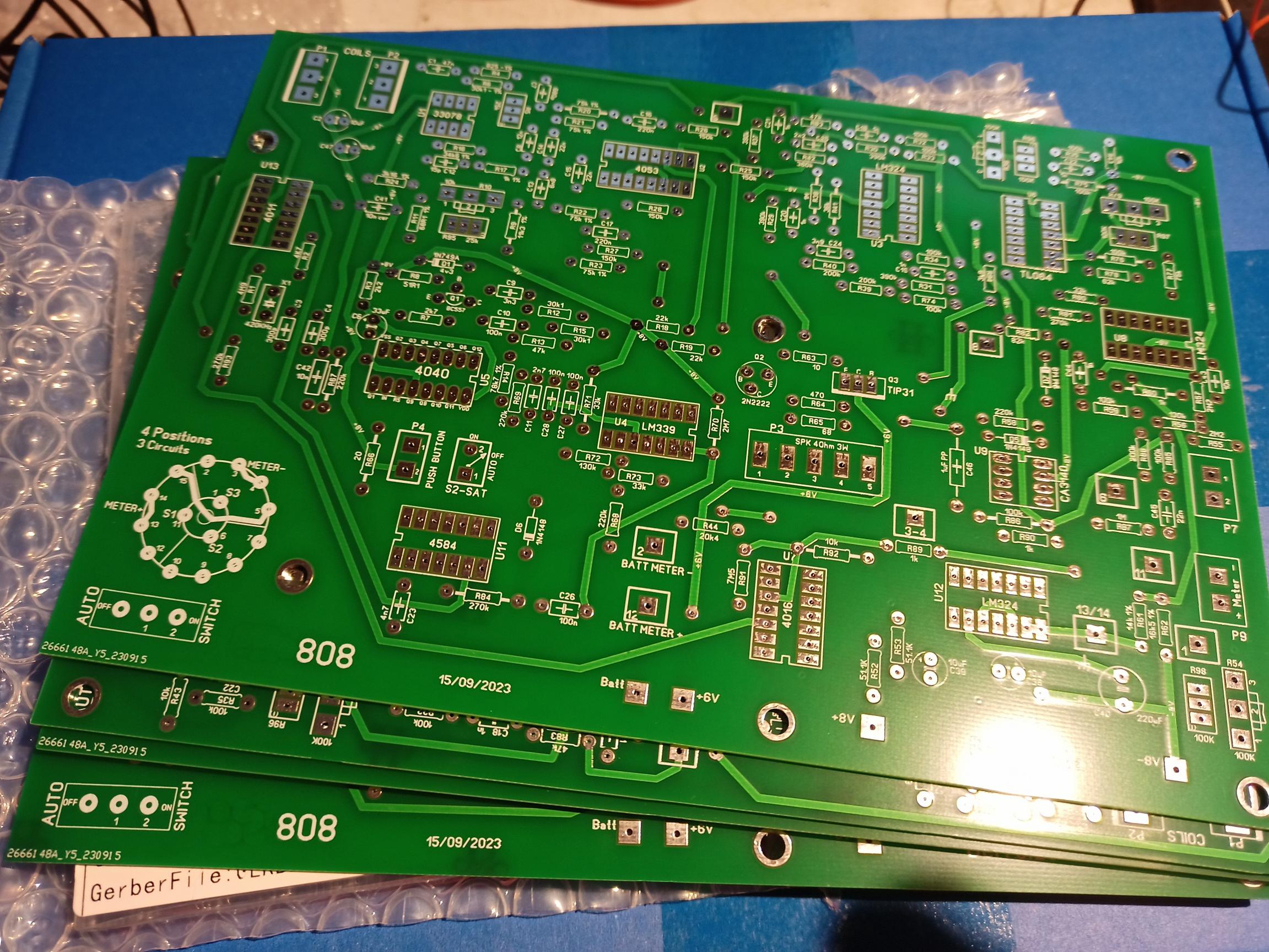

                      • The boards arrived
