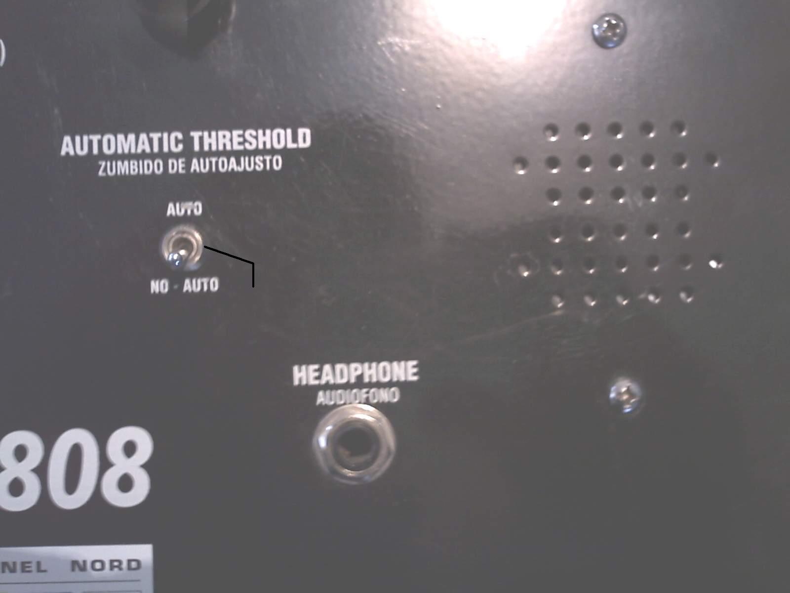

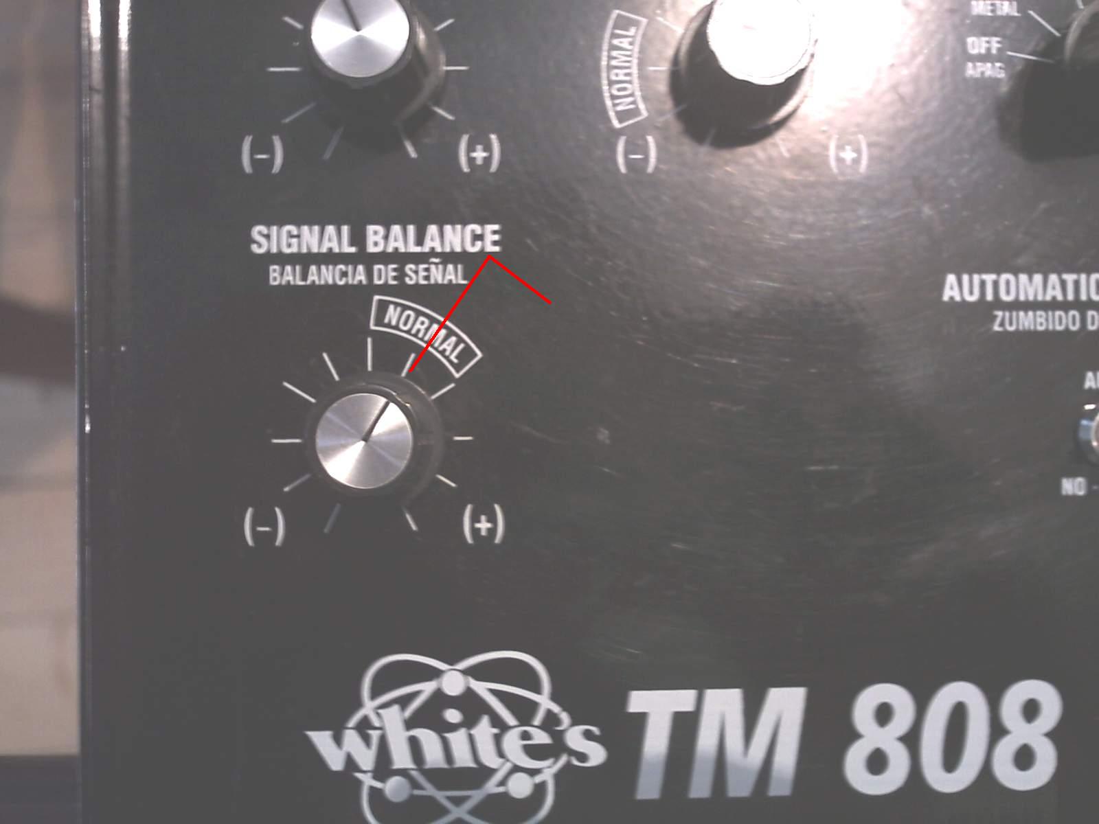

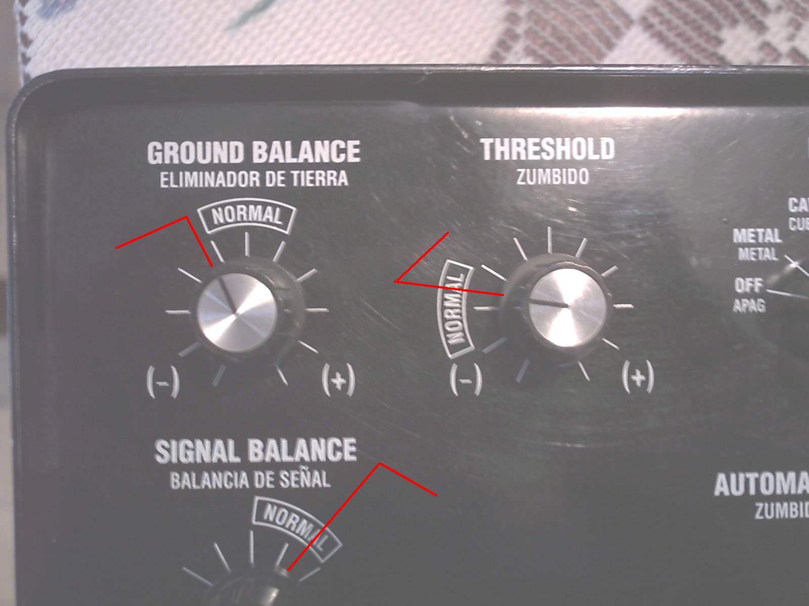

          • #65
            Well....TM808 is not brainstorming device to adjust.
            Follow posted photos and do the presets like i am suggesting here.
            When finished, lift device up in air for 1.2 to 1.5m over the soil and press the reset knob. Hold for second and release.
            Lower device down to normal operating position, holding it with one hand of course.
            You will hear threshold sound. Now with threshold pot adjust it to mum sound...bairly audiable. And that is all. It is ready to work with.
            That is the way i used it. Again this can be very subjective so you may find more proper way for you.
            On some soils i have to repeat this oftenly, on some dont. Moisture affect it to much for my taste.
            Personally i do not use it. I am very interesed in it due some other reasons;
            first a lot of people asking me to make it...offering descent money for handmade, and second reason is educational. I want to fully examine this design and later maybe do some mod on it. Honestly i do like the way how White's did it. Pretty nice design.
            Regards!
