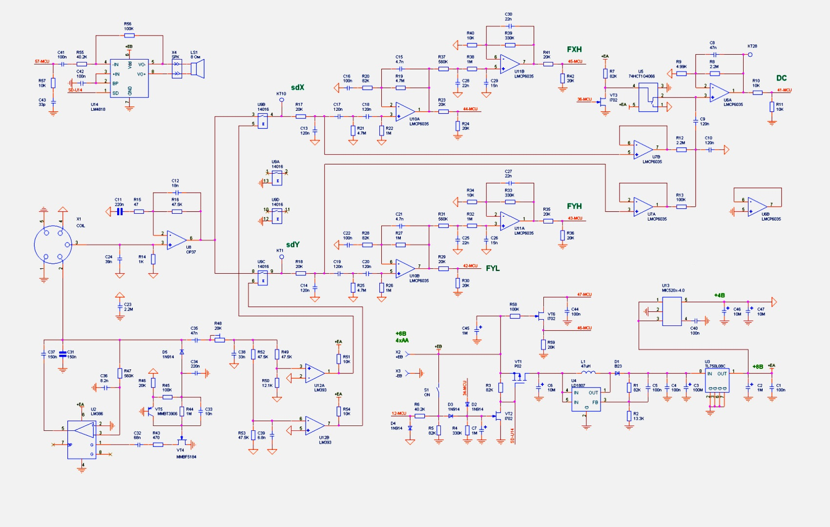

    Click image for larger version  Name:	image.png Views:	0 Size:	981.7 KB ID:	426157​show what you have on oscilloscope, U8 pin 6, U2 pin 5, U12 pin 1 & 4.
      Thanks Pito. Found the op amp, OP 37 and with no metal presnt it is showing 6.65KHz pk-pk 340mV. With metal pk-pk 6.5V, about same frequency. U2 and U12 appear to be different (LMC60, LM396?) but will trace through crt to check - just off to work.

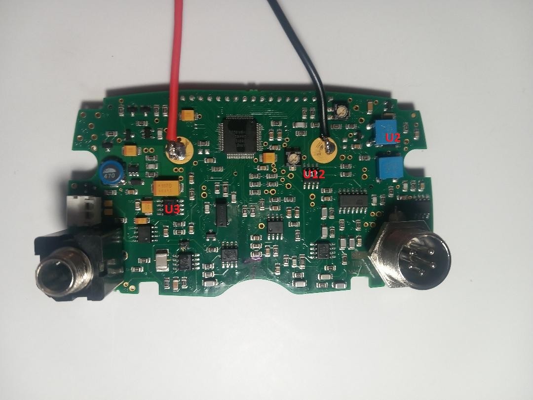

        show PCB picture

        4016, pin 5, 6 ?
        KT1, KT10 ?

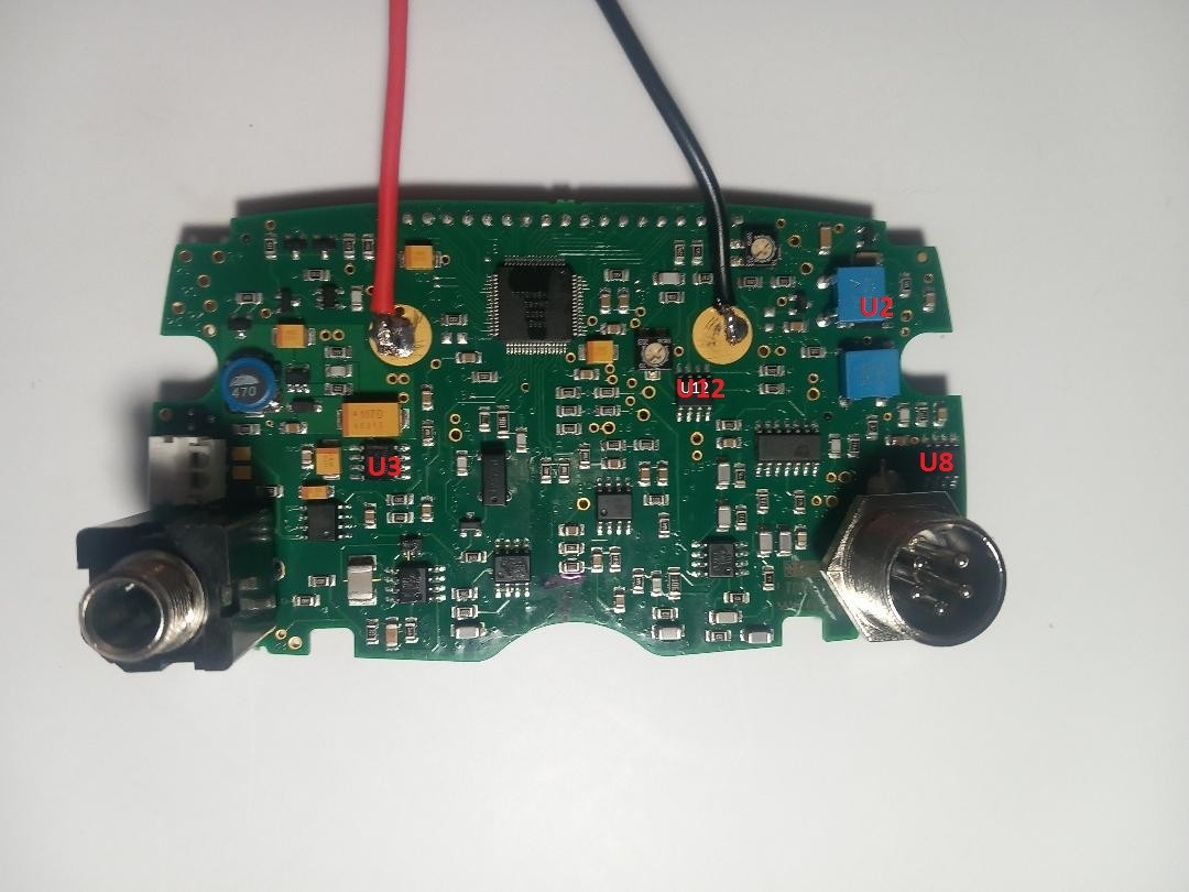

          It was a sine wave, it clipped at 6.5V. Noticed that the presence of metal only altered the waveform at short distances, less than 3". Just back from work and I intend to scope the crt at the points you suggested. I attach a photo of the pcb. Once again, thanks for the help.
            4016 pin 6 sine wave (distorted, more like a rounded square wave) pk-pk 880mV 6.65kHz, with metal more like noise
            4016 pin 5 noise only, with metal, no change
            KT1 sine wave pk-pk 260mV 6.8kHz, with metal 6.6V 6.8KHz square wave
            KT10sine wave pk-pk 220mV 6.8kHz, with metal 6.6V 6.8kHz square wave
              U3 pin #1 = 8V ?
              416 ,5,6 = 8V square wave, shifted 90 degrees
              KT1, KT10 = similar to this

                  U2 pin #6 = 8V DC ?
                  Pin #5 = square wave 8V?
                  U12, pin1, 7 = square wave 8V?
                  pin 8 = 8V DC ?
                  U8 pin #8 DC voltage ?
                    Without coil, U2 and U12 were just noise at pins indicated. U8 pin 8 was 7.4V dc
                      U2 pin 8 = 8V DC = U2 and U12 were just noise at pins indicated = ?
                      with coil C31 = ?
                        Without coil
                        U2 pin 6 8V dc, pin 5 noise, pin 8 1.5Vdc
                        With coil
                        C31 sine wave/pulse pk-pk 31.8V 6.65kHz
                        Pins described as noise were mainly 50Hz (mains power)
                          C31 sine wave/pulse pk-pk 31.8V 6.65kHz = perfect , Tx coil ok
                          C24 ,no metal close to the coil = ?
                          U8, pin 6, no metal close to the coil = ?
                          C38 = ?
                          U12;
                          pin 8 = 8V DC ?
                          pin 3, 6 = sine ?
                          pin 1,7 = square wave 8V ?
                            C24 noise
                            U8 pin 6 noise
                            U12
                            pin 3 sine wave 3.4V pk-p k
                            pin 6 sine wave 6V pk-pk
                            pin1 noise
                            pin7 sq wave 3V pk-pk
                            pin 8 8V dc
                            Having problems finding C38, my eyes not too good! All waveforms at about 6.65kHz.
                              C24 noise = with metal close to the coil ?
                              U8 pin 6 noise =with metal close to the coil ?
                              U12
                              pin 3 sine wave 3.4V pk-p k = not perfect but ok
                              pin 6 sine wave 6V pk-pk = not perfect but ok
                              pin1 noise = not good, should be the same as on pin 7
                              pin7 sq wave 3V pk-pk = not perfect but ok
                              pin 8 8V dc = ok
                              U12
                              pin 2, 5 ?
                              U8
                              pin 3 DC = ?
                              pin 7 DC = ?
                              U9
                              pin 5 = resistance to the ground ?
                              pin 6 = resistance to the ground ?
