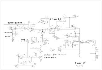

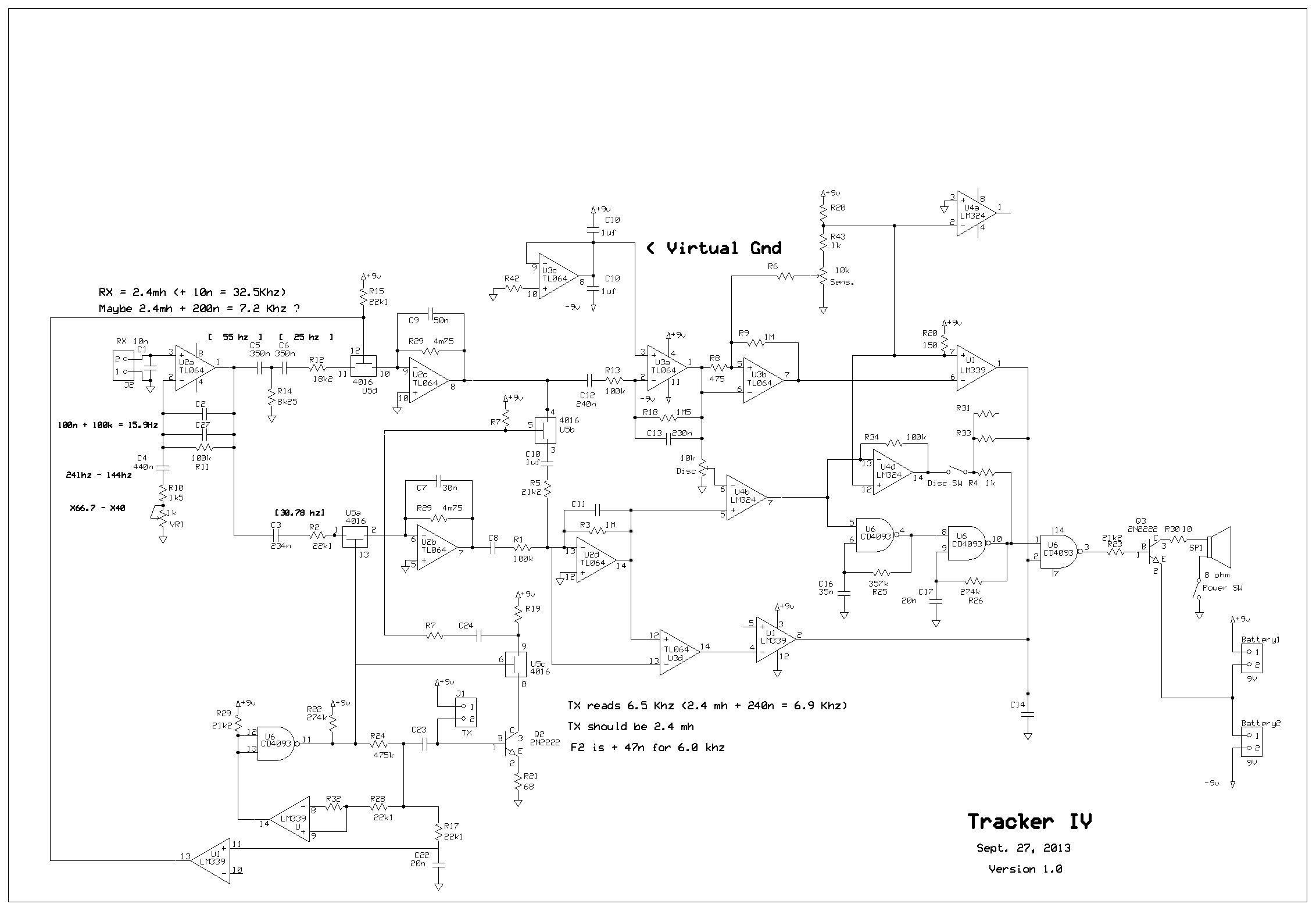

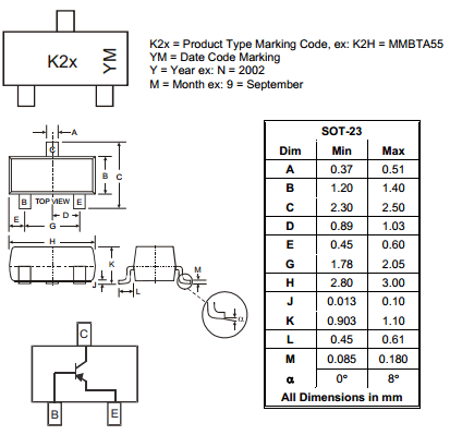

ID:	427728 Something doesn't look right about this part of the circuit. anyone familiar with it? Shouldn't the Tx coil be in the transistor collector. The pinout of the transistor shown on the PCB suggests this is the case. however the schematic shows otherwise. This setup is rather strange. Click image for larger version  Name:	BountyHTrackerIVGeo.jpg Views:	0 Size:	311.8 KB ID:	427727

      Click image for larger version  Name:	MMBTA55.gif Views:	0 Size:	18.7 KB ID:	427744 Click image for larger version  Name:	images.jpg Views:	0 Size:	9.4 KB ID:	427745

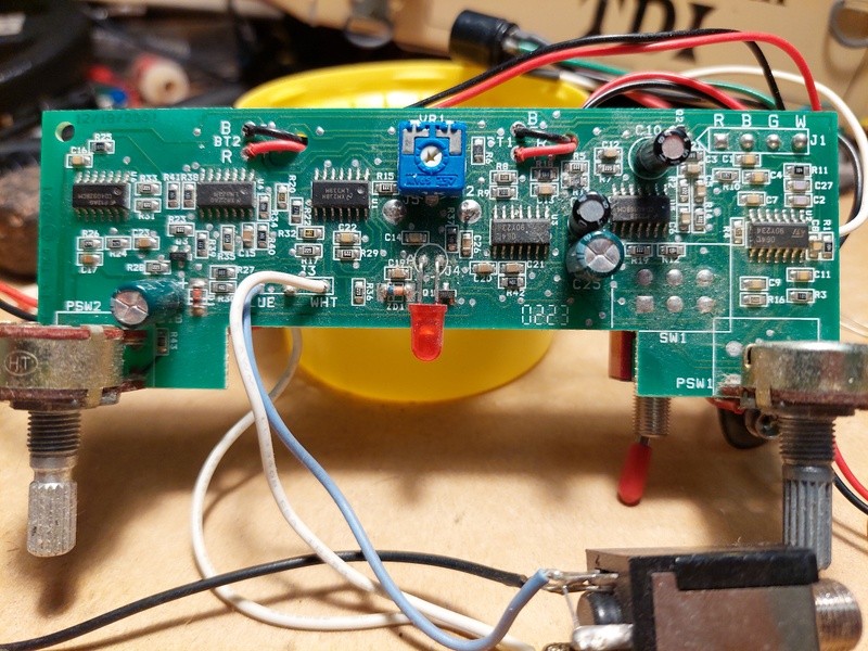

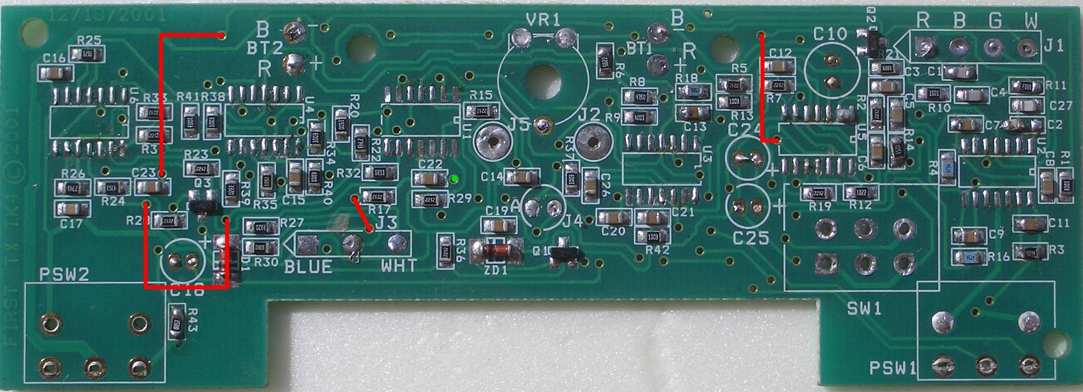

        I compared the scheme with the PCB and whoever traced it did a very good job, except for the Tx circuit, everything else is correct. But it is not complete. The second half of the disc/all met/tone switch is missing from the scheme but that is easy to draw in. And the low battery circuit is omitted, no big deal.

            It appears to me that what is shown on the schematic as Base / 1 is the Collector; Collector / 3 is the Base; the Emitter to 68R looks correct. Transistor is shown correctly as npn type.
              DBanner, I have a complete pcb if you need me to check anything, Agree with Skippy, the base and collector reversed

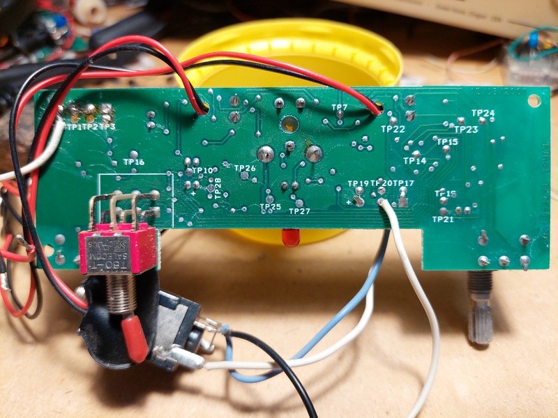

                  Here is a top and bottom of the pcb
                    I agree.
                    I redraw the main circuit, here it is. I will complete it with the corrections.

                      I'm redrawing the Tx circuit along with the phase comparators. I want to simulate this section just to see what it's doing. It looks strange, but except for the incorrect transistor orientation, the rest of the circuit checks out(matches what's on the PCB.

                            The thru-hole and SMT schematics are absolutely identical. The one shown has SMT 1% resistor values.

                            Looks like it. Corrected/missing values are:
                            C4,C13 10n
                            C2,C27 120p
                            C3,C5,C6,C8,C12 220n
                            C7,C9 3.9n
                            C11,C16,C22 22n
                            C14 470n
                            C17 6.8n
                            C20,C21,C23,C19,C26 100n
                            C24 1u
                            Also, U3-pin6 connects to U3-pin2, not pin1.
