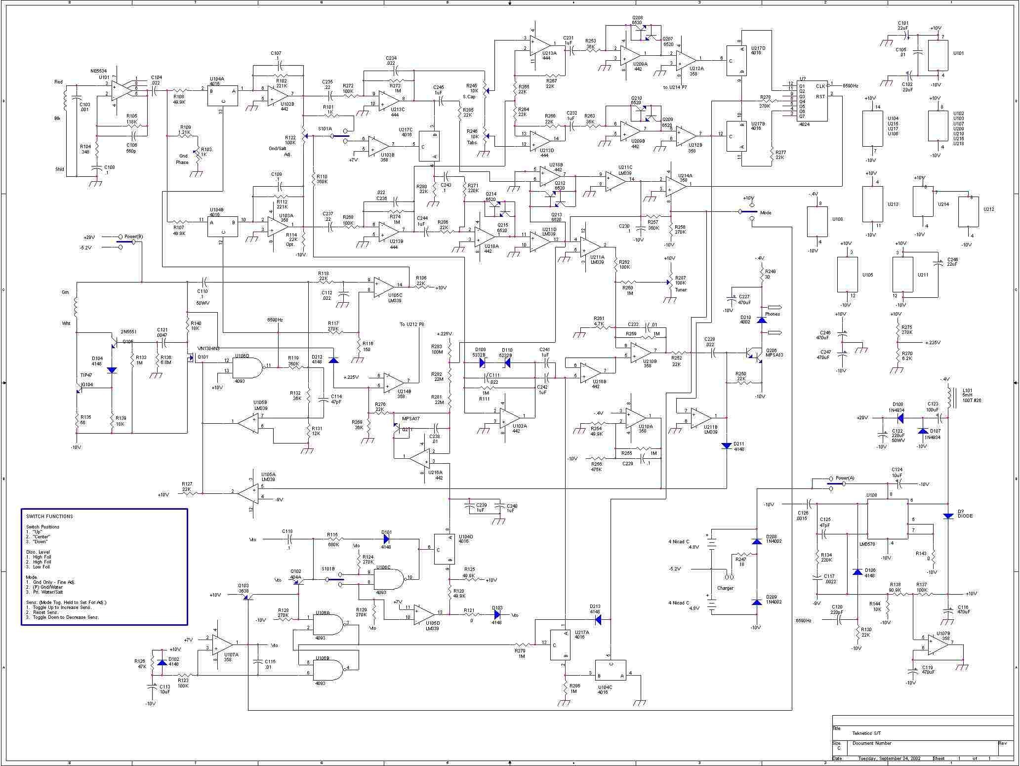

    Nice circuit. But I can't find a user manual.

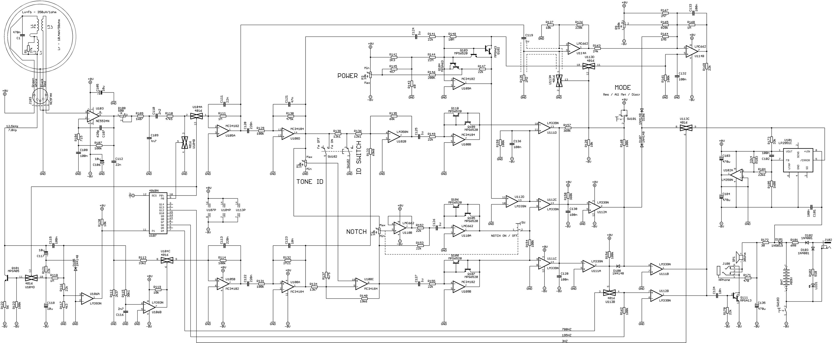

    I like how the tone ID is acomplished. With ratiometric discrim. post demods.

      Please can somebody explain how does U109A and associated circuitry work? What is marked as POWER appears to be the sensitivity pot, but the feedback loop of 109A has number of transistors in strange arrangement. Some sort of compression?
        3Hz supplied by 4060 I assume is for low battery beeping, as LP2951 put out error from pin five, chopped by switch U113C, is this correct?

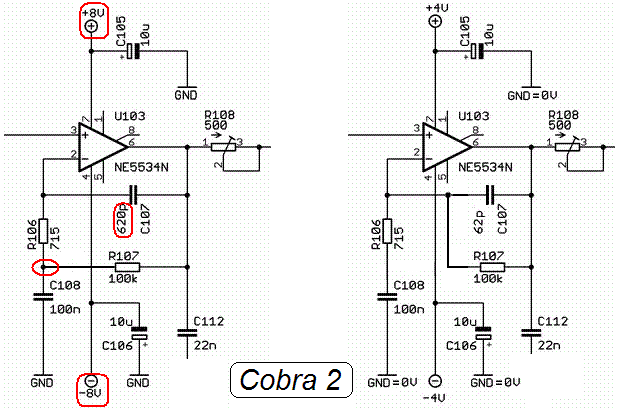

          R107 in the preamp should be connected to pin 2. Yes?
            R106 is wrong, it should be in series with C108.
              Yes, ok.

              The error was copied over.
                These schematic drawings are not so easy to follow. It's messy stuff. Lines all over the place.
                  So it is a Payne design.
                  Payne had own site with great info, but it had died. I just did keep some info from it, but not all.

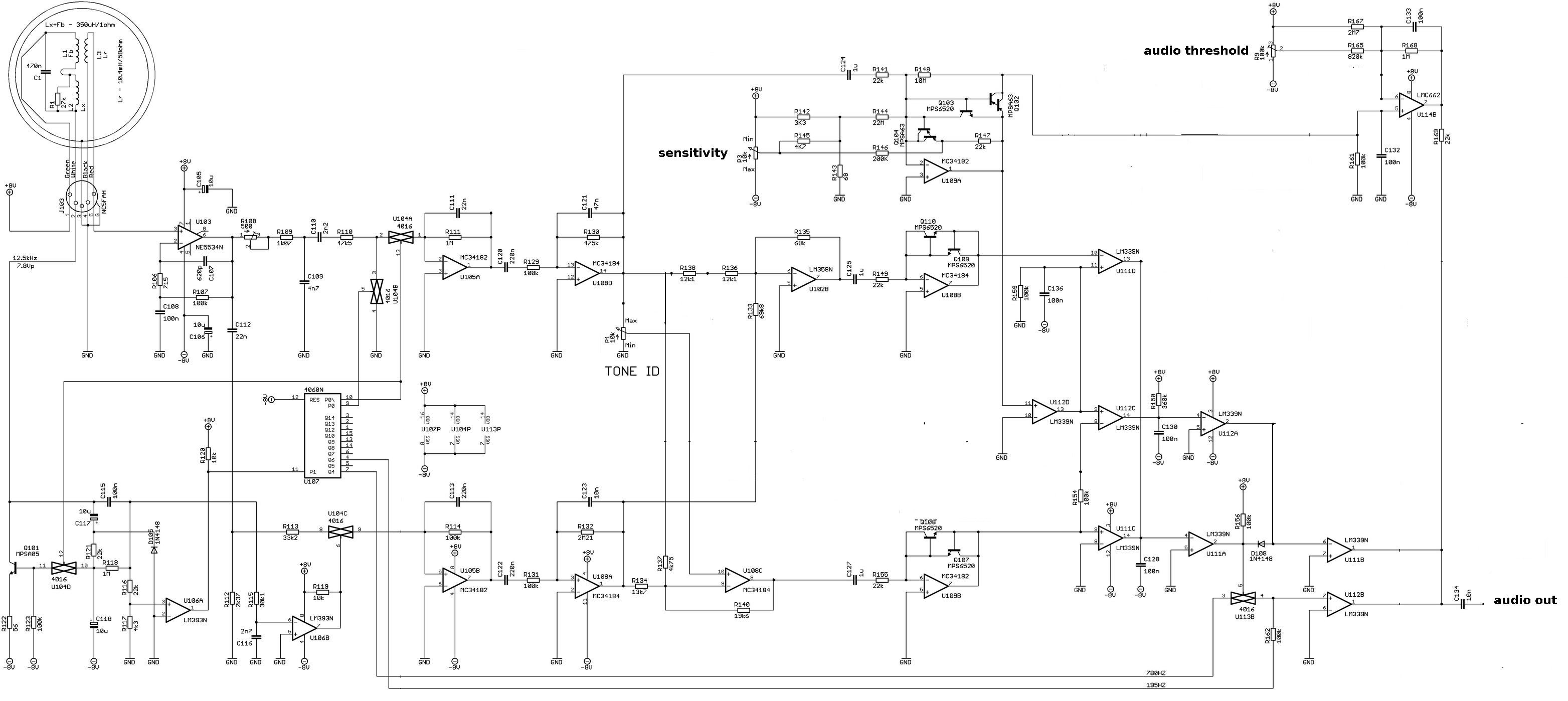

                    The bare bones tone ID circuit (full range).
                    Power supply should be +4V and -4V and GND.
                    Click image for larger version  Name:	Cobra II Viper lite.gif Views:	0 Size:	419.6 KB ID:	428762

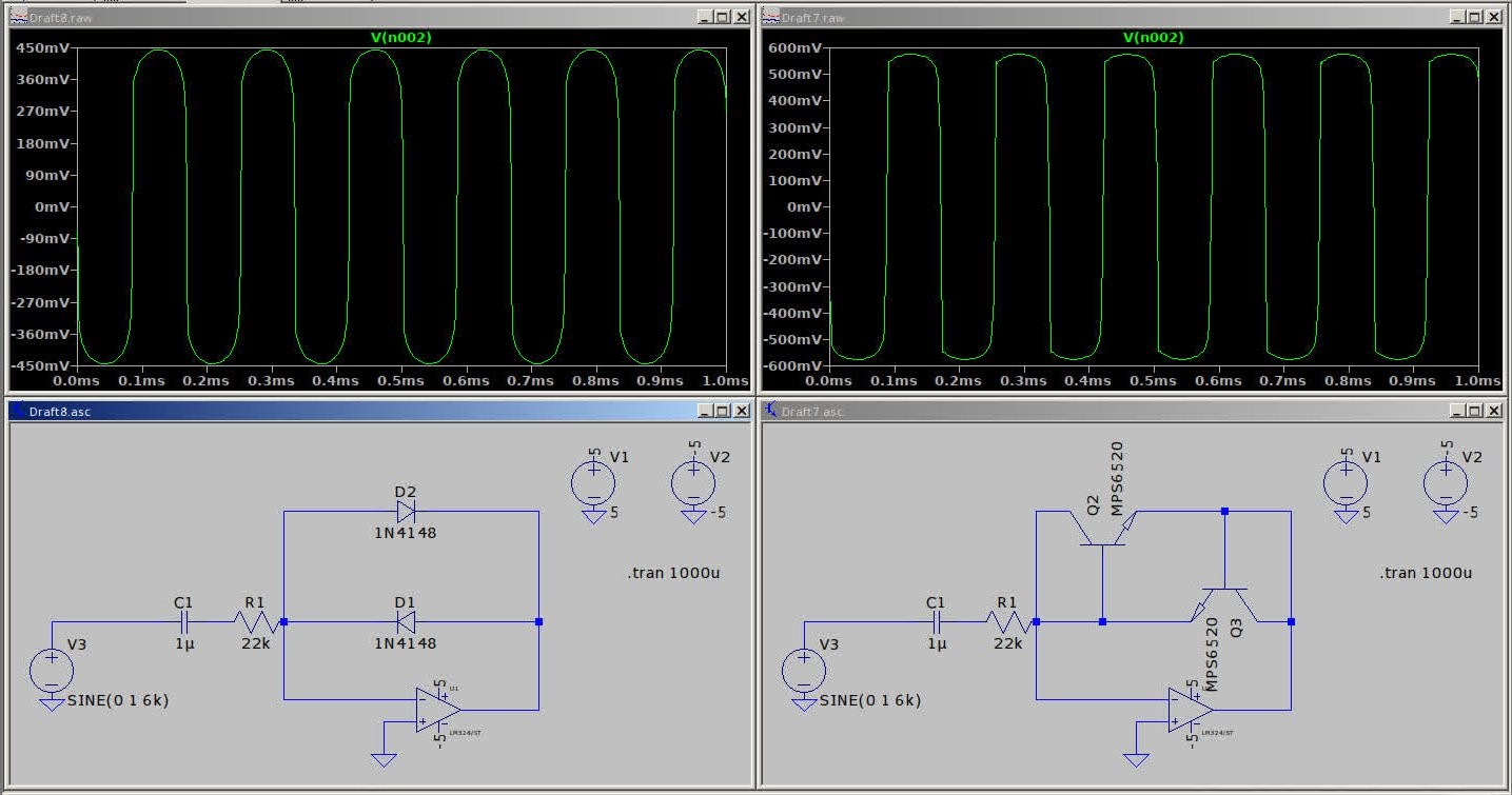

                    R136 and R138 combine for single resistor 24k. Q105,106,109,110 replace with anti parallel diodes.
                      like this?
Name:	Cobra 2 Preamp Errata.gif
                        Correct.

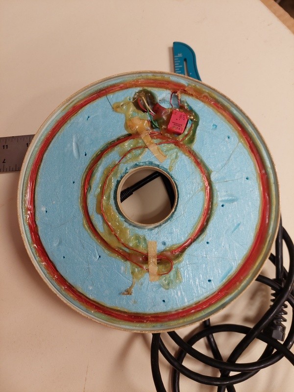

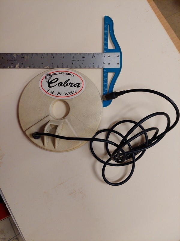

                          The Cobra was another Kellyco creation. Discovery Electronics would send them cases of unlabeled Baron's where they would do a re-brand. Discovery refused to sell Kellyco the upgrade modules for competitive reasons. At that time I had a small contract manufacturing business. Kellyco contacted me to develop and retrofit the Cobra's with a LED bar graph. The LED bar graph was a big selling point at the time. I probably did 150 units. The Baron/Cobra was an excellent detector functionally, but a big design flaw was the cast aluminum control box. It must of weighed two pounds alone.

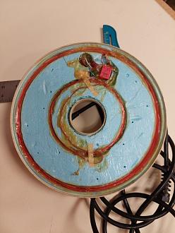

                          Here is picture of my test coil, which I later opened. I believe Jim Karbowski was making the coils
                          Click image for larger version  Name:	Cobra Baron coil.jpg Views:	0 Size:	85.1 KB ID:	428788
                          Click image for larger version  Name:	Cobra coil.jpg Views:	0 Size:	119.8 KB ID:	428789

                            Diodes instead of transistors. Not quite the same p-p obviously.
                            Click image for larger version  Name:	diode vs transistor.jpg Views:	0 Size:	164.8 KB ID:	428823

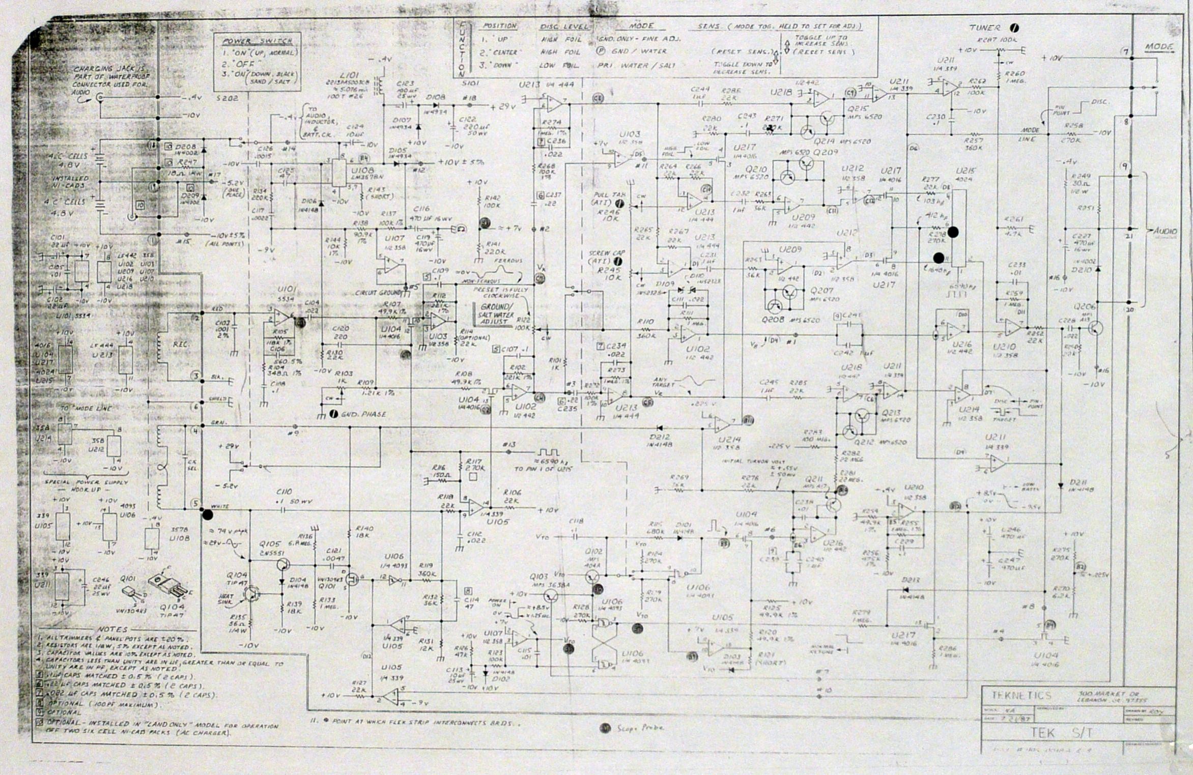

                              same sort of arrangement with transistors with the Tek ST schematic. Preamp drawn correctly this time.
                              Click image for larger version  Name:	Teknetics_ST_sharpened schematic_001a.jpg Views:	0 Size:	418.6 KB ID:	428826
                              Click image for larger version  Name:	Tek_sch.jpg Views:	0 Size:	845.4 KB ID:	428827
