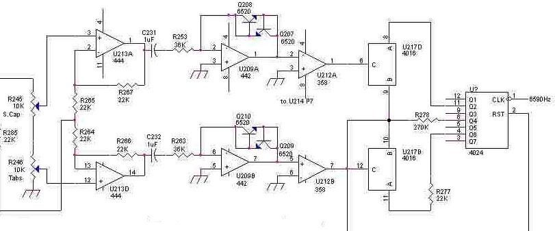

        Check out this tone arrangement here, pretty slick.
        Click image for larger version  Name:	Teknetics_ST_tone.jpg Views:	0 Size:	60.6 KB ID:	428832

          Most of those detectors were straight cmos logic chips, no micro-processors. I think the auto tracking ground balance module did have a processor, but never have seen a schematic. Have you figured out what the 3hz clock is doing? Maybe something to maintain the analog ground?
          Add:I found this text I copied from one the old forums
            3Hz I think is for low battery "beep beep beep". The LM2951 voltage regulator chip has an error pin that can be set when input voltage(battery) is low. The output high is then modulated at 3Hz and mixed(modulate) (195Hz) via a comparator through to the audio amp. I hope I got it right, otherwise somebody can explain what's goin on.
            LM2951.pdf
              I didn't realize the error pin was an output. So low battery trigger makes sense.

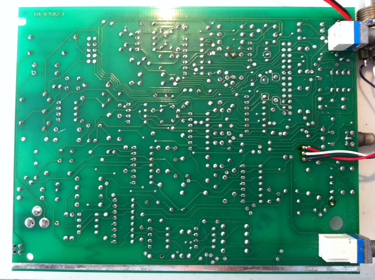

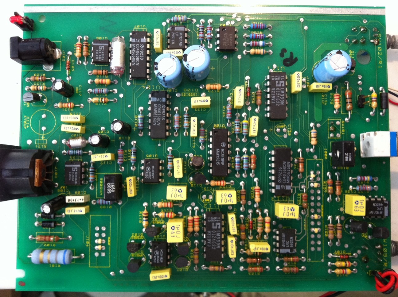

ID:	428891 Click image for larger version
                          Thanks for the info, I've been taking a very close look at all of George Payne's schematics and patents that I could find.
