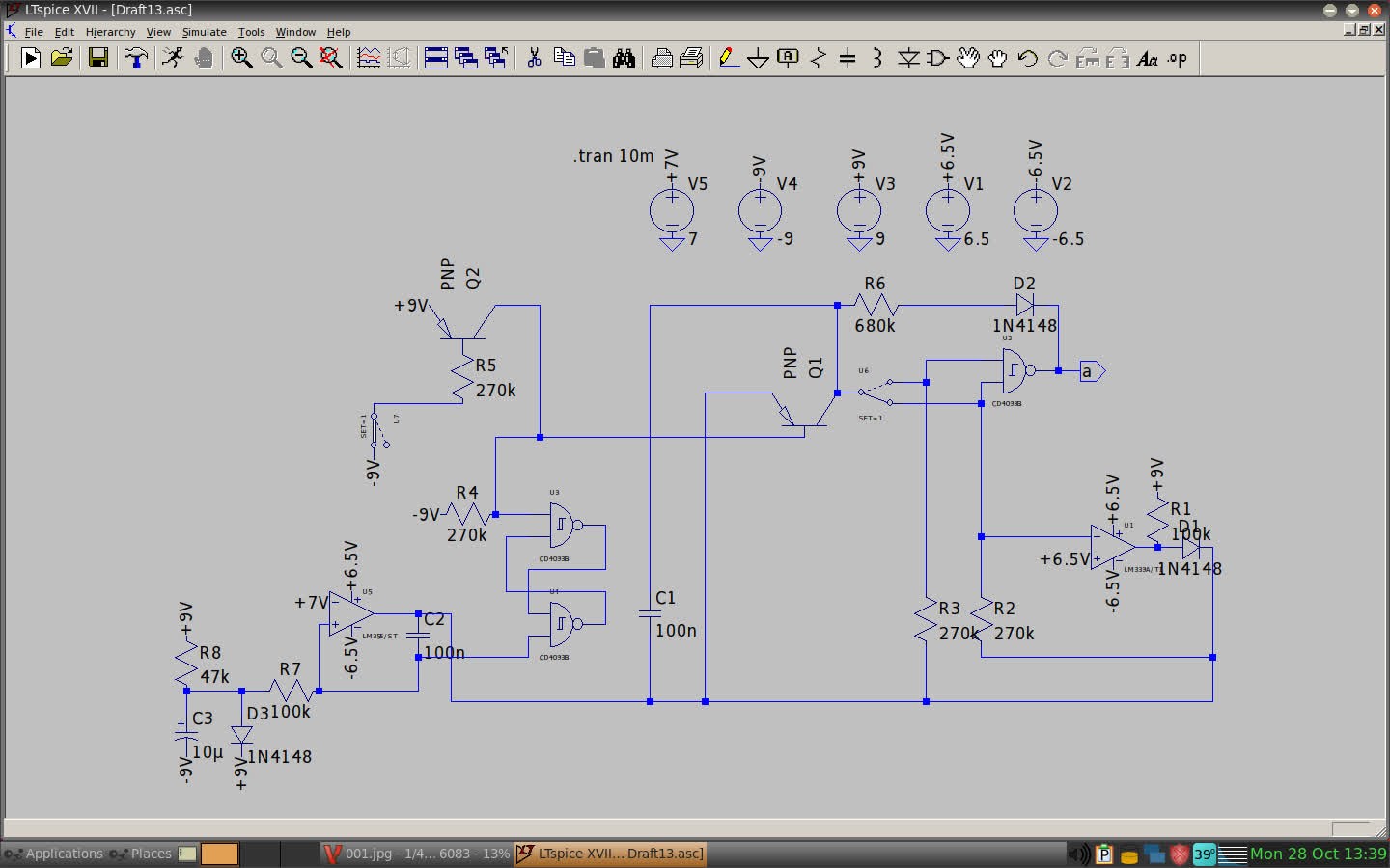

    [ATTACH]n428899[/ATTACH] A slim down version of this scheme should make an awesome 2-tone beach machine. Trying to understand the mode switching circuitry.

        Looks like in (black sand/salt mode) it puts 30+ volts across the Tx coil. Hence the boost regulator. One of those china boost modules could be fitted to a slim down scheme which is rigged to operate only in black sand/salt mode, thus eliminating all the toggle switching circuitry?. Maybe. A specialized beach detector with 2-tone discrim. I'll draw a lite schematic version and post it to get some feedback on what you guys think.
          need to figure out a manual "pot" sensitivity control instead of the fancy pancy toggle "up" or "down" to increase /decrease sensitivity. That shouldn't be to difficult.
          This is accomplished I believe via U216 (the one with Q11) and its circuitry. Still unsure how it all is supposed to work, I need to read the operators instructions for the TEK S/T.

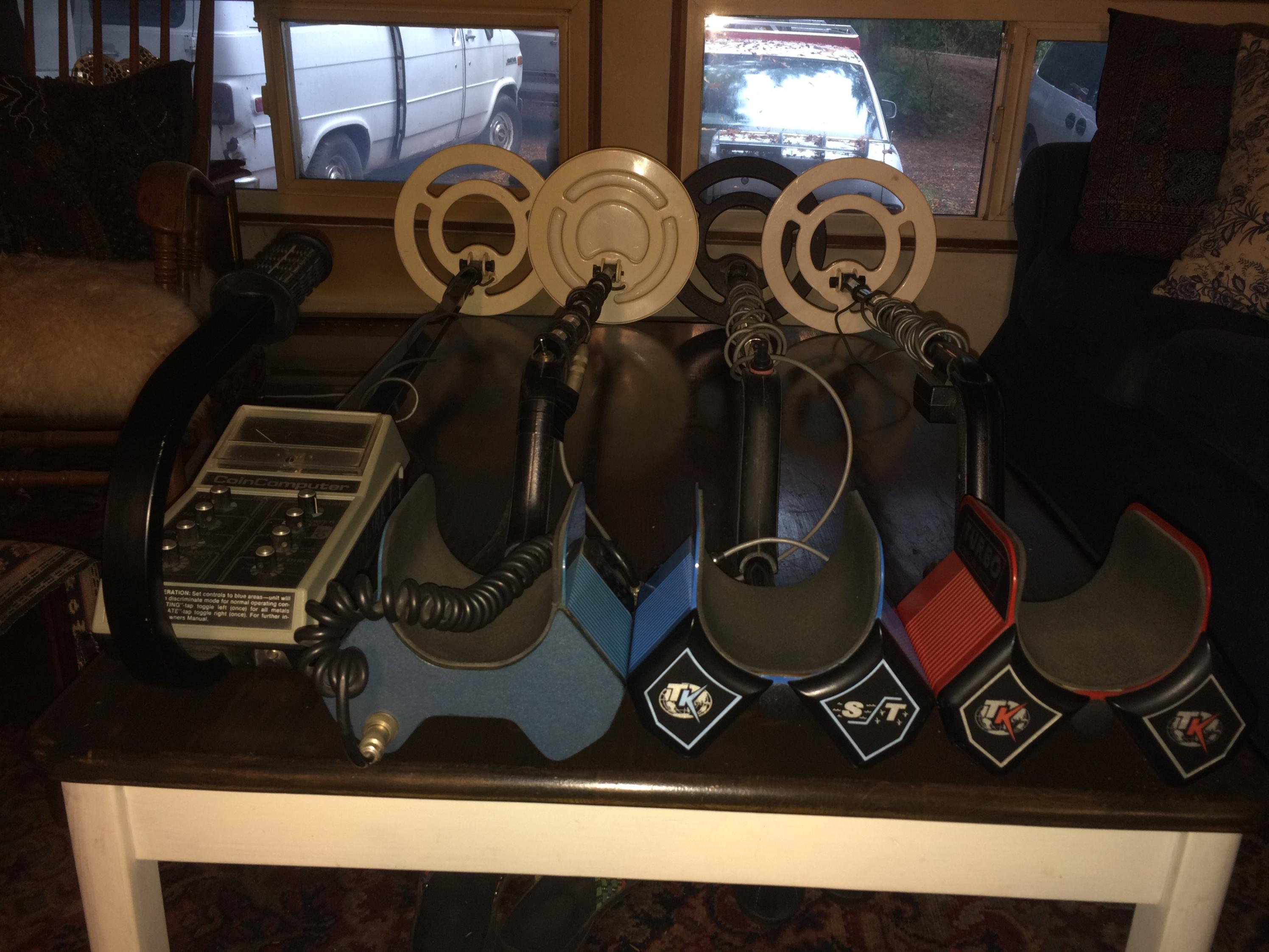

                Click image for larger version  Name:	IMG_0175.jpg Views:	0 Size:	488.3 KB ID:	428911
                very unusual housing for the electronics, it was a 2 board design, I think. Those search coils look like the standard bounty hunter coils. No problem getting those.
                  I think I can make a very good beach detector based on the S/T scheme.

                    The circuit uses primarily +9 and -9 Volts. The +6.5V and -6.5V in my sim is redundant.

                        Very interesting circuit no doubt. LM3578 switching regulator has internal oscillator (pin3) which can be set using an external capacitor, the formula given in the datasheet is:
                        F(osc) = 8×10 ^−5 /C 1
                        Now looking at the schematic of the S/T shows a 1.5nF cap is used to set the internal clock. This is also tied into the Tx circuitry. Using this formula I calculate 5.33kHz. Is this the operating frequency of this detector? Everything is nicely synchronised and tied together. That's very nice indeed.
                            [ATTACH]n428919[/ATTACH]
                            You will need to figure out how to synchronize your Chinese boost module to the Tx. The modules I have do not have external timing caps, but they do have enable pins. Possibly you could blip the enable pin with the Tx to keep synchronized?
                              Problem with china upconverter module is switching interference, and not possible to synchronize everything. Better to stick with original power supply scheme using LM3578.
