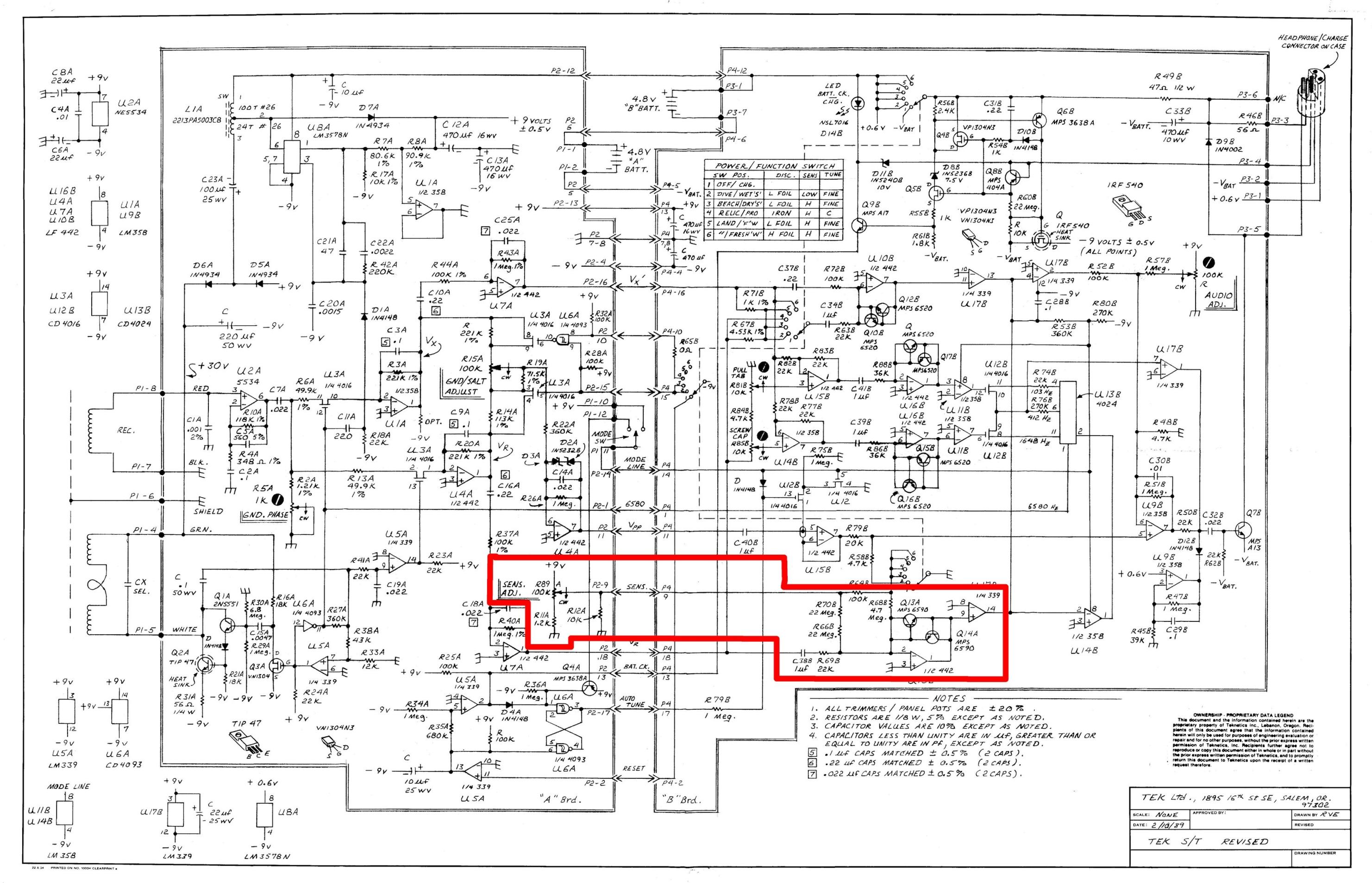

            There is a sens pot on the revised schematic, but I don't see one on the previous scheme. I need to compare the two schemes to see what's going on.
            TEK S-T REVISED_-_TEK LTD_0.pdf
            The revised scheme has a beach mode. Wouldn't you know.

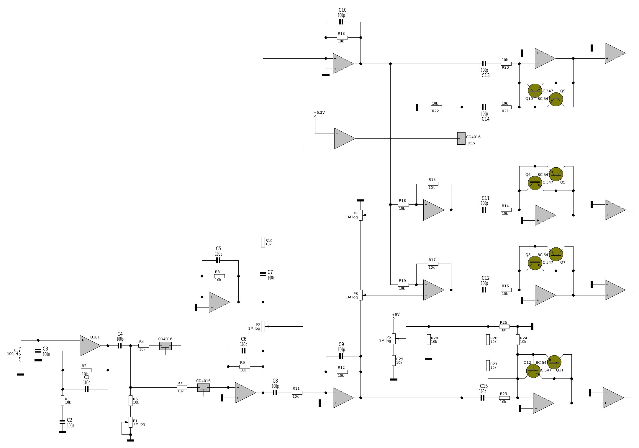

              Actually, it is just a simple change. As I suspected it would be, but nice to actually see it drawn out in the revised scheme. It would seem that the toggle up/down switch being used to adjust the sensitivity was thrown out in favor of a manually adjusted pot. Interesting. I will have a new schematic drawn soon. A slim down version, only for beach hunting.
              Click image for larger version  Name:	007.jpg Views:	0 Size:	737.8 KB ID:	428934
                The revised sensitivity using a pot looks like a better solution.

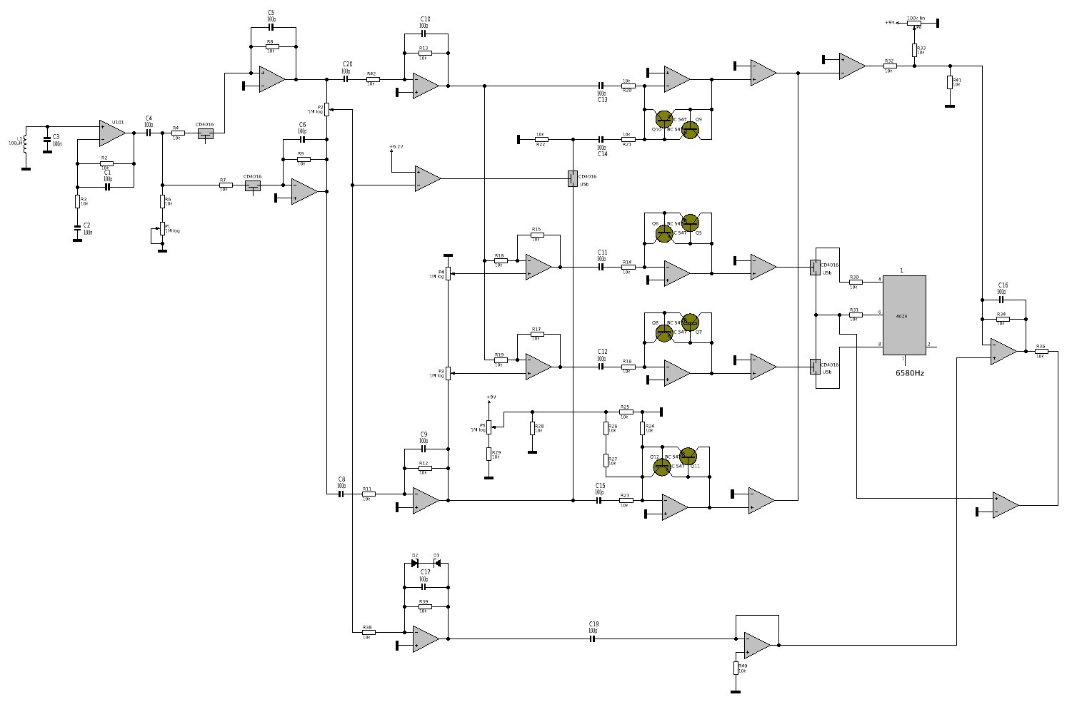

                  my slim version is taking shape, sens pot included. It will be configured for beach mode only. The power supply, Tx oscillator and phase drive will be a departure from the original though. Nice thing is I can use an off the shelf factory made coil for testing.
                  Click image for larger version  Name:	TEK ST.jpg Views:	0 Size:	196.4 KB ID:	428937
                    I would like to replace those transistors with ant-parallel diodes but they conduct at slightly smaller voltage compared to the transistors, I'm not sure how this will affect the performance of the circuit though.

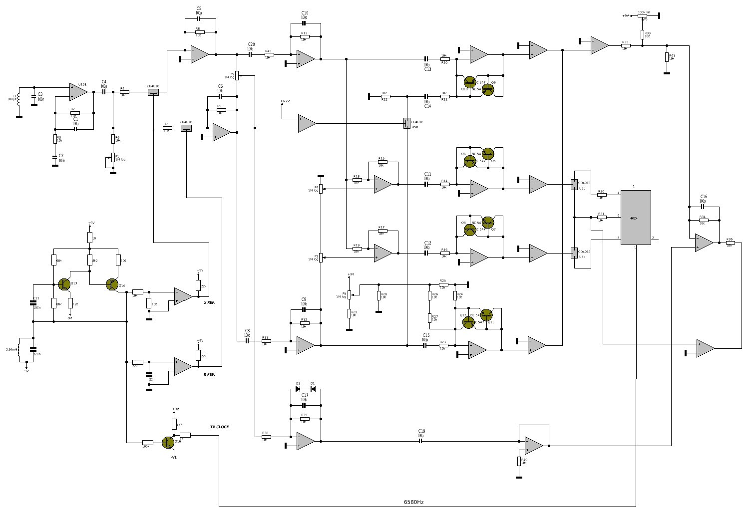

                        Tx oscillator, phase and quadrature drive added to scheme. This is where I changed the circuit. So far, so good. I will resolve any errors later on. The structure of the scheme is becoming clearer.
                        Click image for larger version  Name:	TEK ST.jpg Views:	0 Size:	141.7 KB ID:	428942
                          Earlier in the thread I made a calculation on the internal clock frequency of the LM3578. I don't think it is correct. The Tx freq. is supposed to be 6580Hz.
                              Hi. These transistors or diodes limit the overload of the chip. Once upon a time I tried to replace the diodes with transistors in the White's IDX detector and I did not like working with transistors. It's better with diodes. But that's my opinion...
