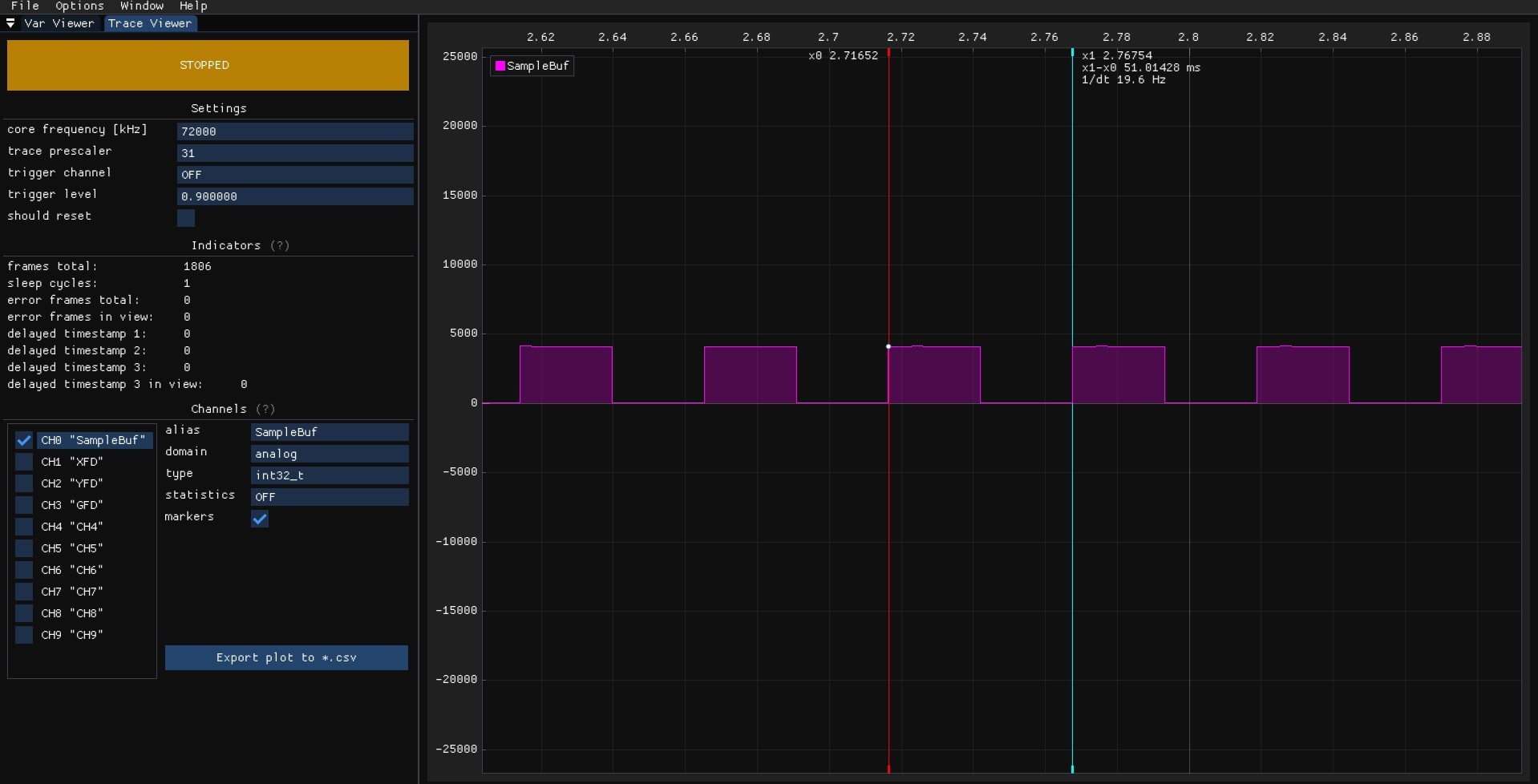

            • Today I had time and tried the method that I use in my metal detector on an STM32 BluePill and it seems that direct sampling would work without problems. In my test I tested a TX frequency of 20kHz and I made 16 samples which were then resampled 64x. The main loop runs on RTOS and includes all filters, magnitude and VDI calculation so this is the majority of the code. I attach a printscreen where you can see samples from the TX signal processed in Demodulation(); the frequency of the RTOS loop is about 312Hz.
                excellent excellent
                thats a great confirmation.
                I recalculated the entire md for 9 khz, improving the Qs and tightening the bandwidth + increasing the siot rates from 256 to 512. my calculated enob is 19, but practicslly, it should be slightly better than 16-17 bits.​

                  If you are interested, I can add complete files for Keil ARM and STM32 Cube MX.

                      Here is the complete project for Keil ARM and the file for displaying data in the MCUViewer program, which is in the Media folder.
