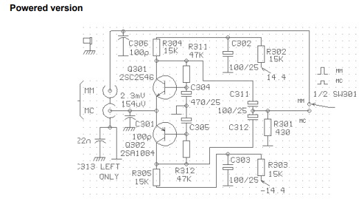

                            • That is on paper, in real word with Rx coil connected ?
                              Picture of the bread board ?​
                              not clear how Rx signal (green ) is getting to opamp
                              • In your drawing the battery and capacitors will short the signal = so how is possible that your circuit is working (good just only on paper )?
                                This is a different story, you have R304 and R305
                                ​Click image for larger version  Name:	image.png Views:	0 Size:	49.3 KB ID:	435225​​
