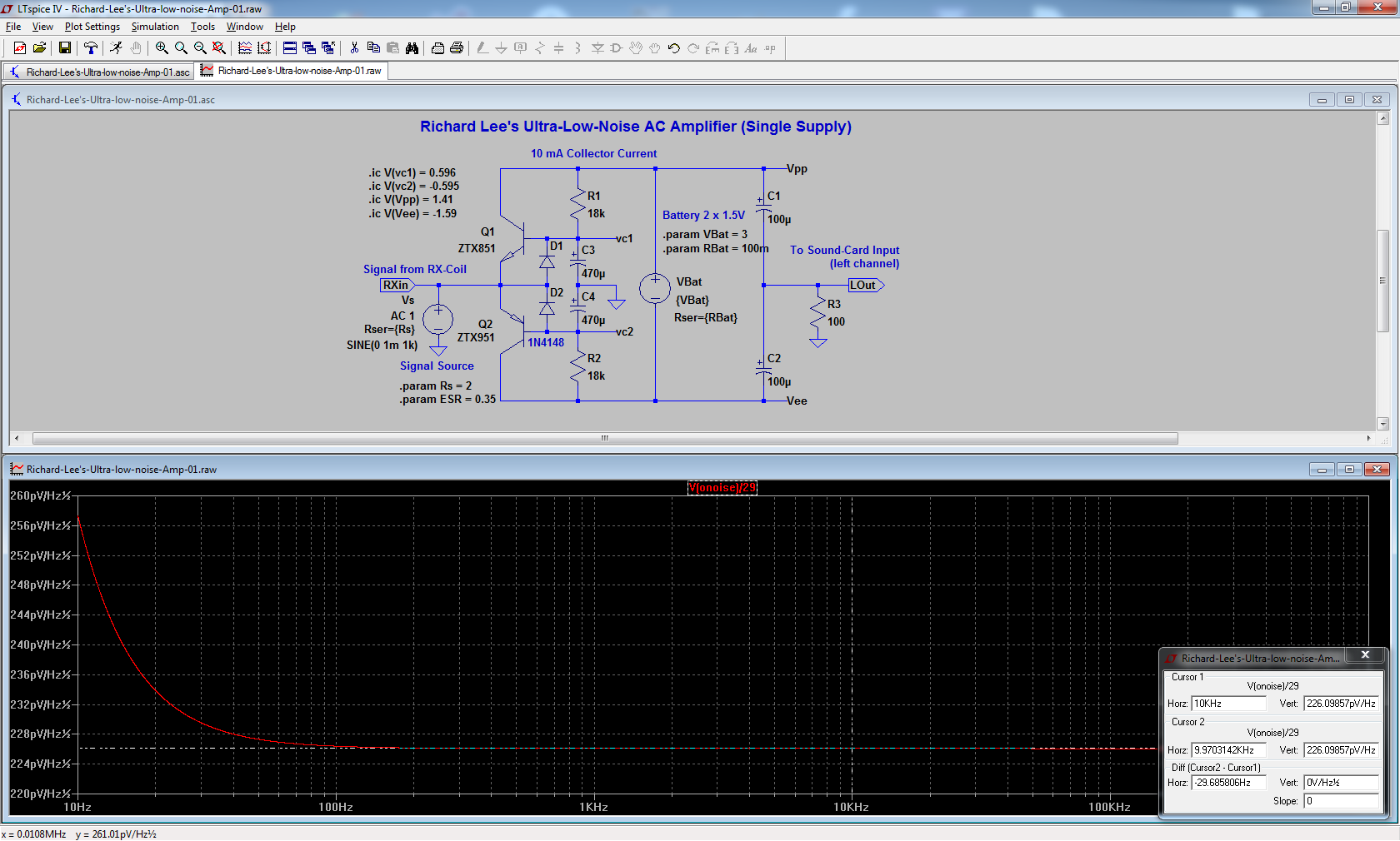

            • Hi all,
              I have put a working LTspice simulation files for your convenience to play with. You can do transient, AC (frequency response) and amplifier noise analysis. Just make the desired command line active and mark the others as comment.
              This common base transistor pair amplifier is acting like a TIA (transimpedance amplifier - current to voltage amplifier). This is what it makes it very very interesting. Watch the current through the signal source. It's voltage drops due to source resistance Rs.
              It's a best finding gadget for decades!

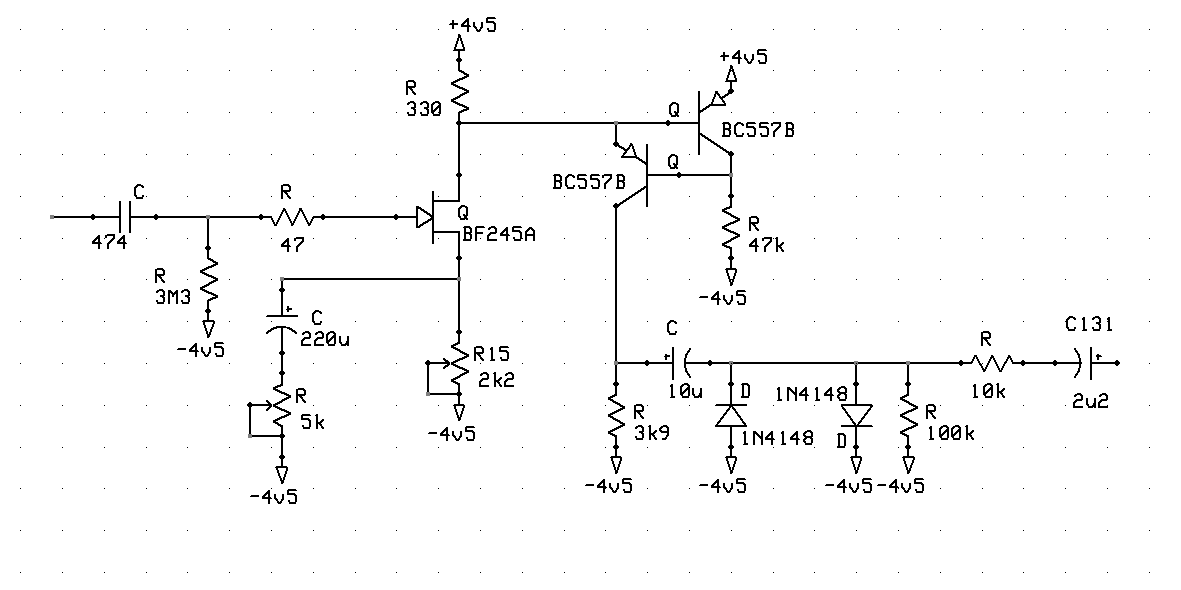

              • Common-base is generally the better approach to low noise. Here is a CB preamp I was messing with several years ago. It does not require a floating voltage source. I don't recall where I found this but probably an audio application. The values shown are what was used in my last sim.
                  It's the same topology. A bit modified however. You have a buffer (amplifier) and the end of the output to get defined gain regarding output impedance to the next stages.
                  It's a (old and forgotton) moving coil (MC) amplifier.
                  Also very interesting.
                  Thank you Carl.
                  Aziz

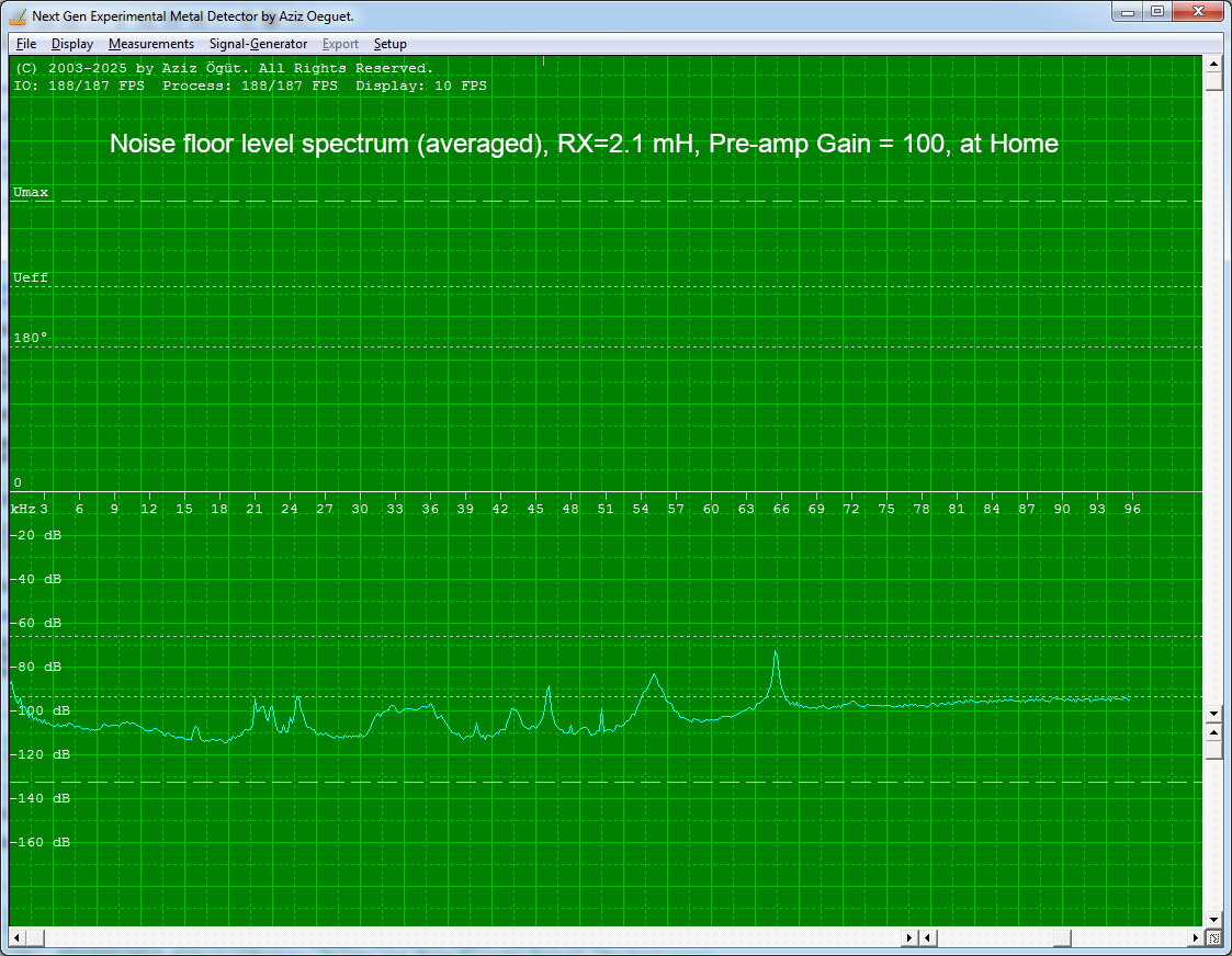

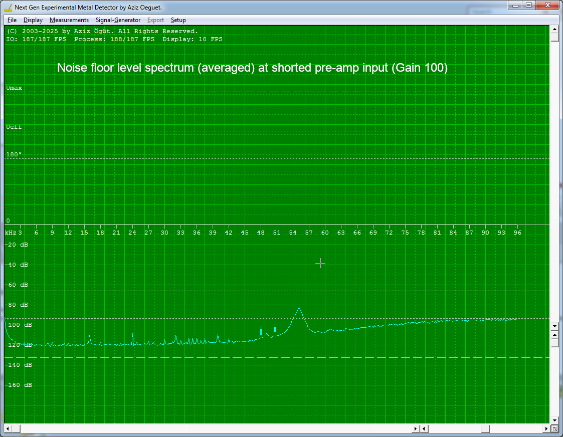

                    • Hi all,
                      now the real EMI noise at home. Fasten your seat belts please.
                      I have connected an RX coil (L=2.1 mH) to an ultra-low-noise pre-amp of gain 100. The pre-amp does not produce any significant noise. Even with gain of 100. But the sound card does.
                      Let's look at the shorted input of the pre-amp first:
                      Click image for larger version  Name:	NoisefloorlevelG100-Shorted-Input.png Views:	0 Size:	87.3 KB ID:	435117
                      And now with the RX-coil at the pre-amp input:
                      Click image for larger version  Name:	NoisefloorlevelG100-RX-Coil-2.1mH.png Views:	0 Size:	98.4 KB ID:	435118
                      You see, the FFT spectrum rised on almost all regions up to 70 kHz. Above 70 kHz, the ADC of the Sound BlasterX G6 produces more noise so the EMI isn't visible, because the EMI noise is below the noise floor level of the ADC system. There are still regions with low EMI noise (around -110 dB level regions). And regions with bad, really very bad behaviour (all the peaks).
                      You see, that pre-amp gain of 100 is large enough. It should even be lower. Maybe 6 dB lower. This is factor 2. So pre-amp gain up to 50 is ok I think.
                      If we have an IB-mismatch, which produces 10 mV residual signal on the RX coil, this would be at gain 50 500 mV output. Ok, maybe too much. We should take lower gain. Or lowering our IB-mismatch residual RX voltage.
                      Maybe an active cancelling with a cancelling coil (one turn loop over RX coil)? Yes, this could be done very easily. I have done it 15-20 years ago. This is working perfect. Even on a dual frequency detector. But I would lose one output channel and would have half TX power at the end.
                      Anyway, you see the EMI noise (at home), which is causing a lot of headache.

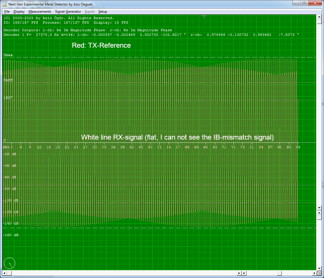

                            • Hi all,
                              well I have connected a TX and a RX coil to my sound card. Pushed the transmit power to almost maximum power and tried to balance the RX coil. Only single frequency at the moment. TX coil is tuned with a capacitor at 27375 Hz resonant frequency. RX coil is not tuned. No pre-amp connected.
                              I could balance the TX and RX in first attempt into the 1/1000 of the ADC input range. This is something in mV region depending on the line-input level ruler. I could probably get it better and lower.
                              RX Phase detection is so much sensitive compared to magnitude. Which is the normal case if you look at the frequency response spectrum at resonance frequency. The phase change is much steeper than the magnitude. If you have a high Q TX coil system (low TX resistance), this is even much more sensitive. But we can do more. Much more.
                              As the RX coil won't be tuned at all with a capacitor in the multi-frequency mode, we really need an amplifier to get more depth and sensitivity. A gain of 50 to 100 is in game again.
                              And guess what? We need an Ultimate-​Ultra-Low-Noise-KISS-Amplifier (UULNKA).
                              Without the pre-amp it would be a nice detector. But with the pre-amp ...
                              I will show you some pics if I have more time.
                              Cheers,
                              Aziz
                              • This is it.
                                Click image for larger version  Name:	TX-RX-IB-flatline-no-preamp.png Views:	0 Size:	106.4 KB ID:	435156
                                It got even 5 times better. I could probably get much better with active IB-nulling. Then pre-amp gain of 500 or 1000?
