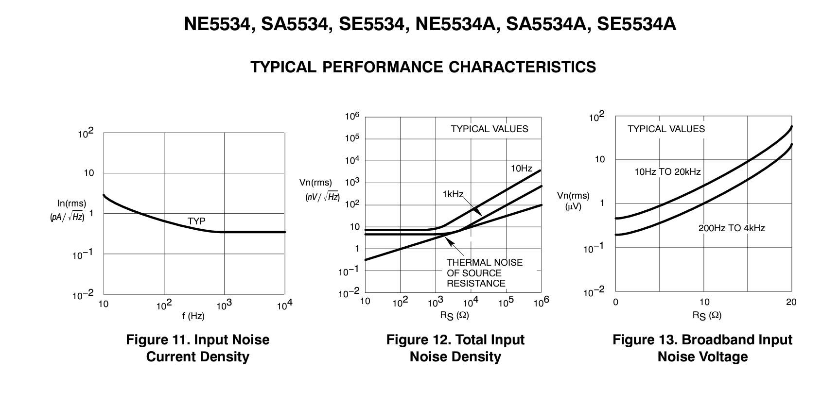

      • Just reading the data sheets for a "cheap" ne5534 shows the source resistance will have more effect on noise than your wallet will. LOL
        ( and it is random noise anyway .. non synchronous )

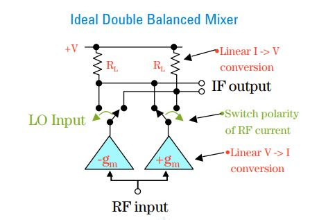

          • Hi Aziz ... there may or may not be a reason. Maybe it was a "bluebird" .. some designers choose to overdesign to maybe counteract a percieved deficiency somewhere else. VLF machines are fundamentally frequency domain and use ( or should use ) synchronous demodulation. If the mixers used are "leaky" ... ie the mixers are not balanced and port to port isolation is poor then low frequency noise at the input will impact the target frequency bandwidth. So if you lower the noise at the frontend you can offset this effect ... however you should really look at getting a better mixer as the demod.
            Most schemes I see use chopper switches like the 4066 or 4053 in single ended mixer configuration ... these are not really ideal if high performance mixing is required.
            Look up Gilbert Cell for ( you can get a chip NE602 NE612 I think ) ... they can achieve balanced mixing ... theres lots of schemes though even using 4066 in some circuits.
            Of course with high spec ADCs this is all a moot point as nowadays the mixing can be done in the DSP and achieve near perfect results ( depending on the bit resolution and noise floor of your ADC ).

              • The Gold Bug was designed by David Johnson. Most likely he thought he could design a better discrete opamp than what was available. The same thing was used in the CZ designs. David was insistent that the preamp needs to have ultra-low flicker noise even though a balanced demodulator cancels flicker noise. I suspect you can replace the discrete amp with any decent opamp and not see any difference.
                The Bounty Hunter Red Baron (George Payne, 1977) used LM1496 analog mixers (Gilbert cells). Barry Gilbert worked at Analog Devices when I was there, chatted with him a few times. He was a master of bipolar design.
