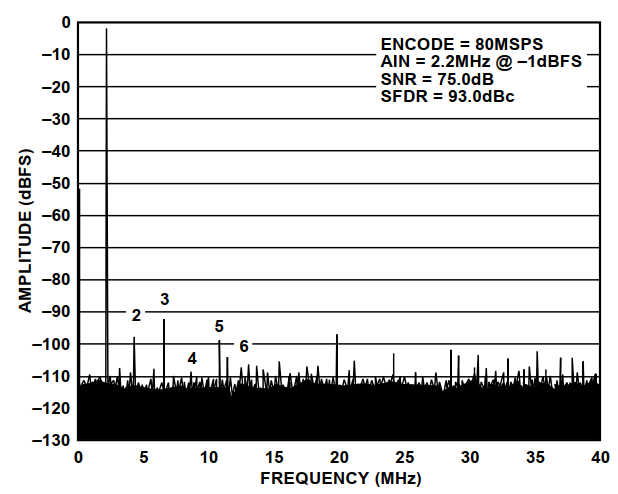

  • Keep in mind what you call SNR isn't really SNR, it's a relative noise level and its value depends on the depth of the FFT. To get SNR, you have to integrate all those noise bins over the BW of interest. Here's an FFT or the AD6645, a chip I helped design. You can see the noise floor is around -120dB while the SNR is only -75dB. From this, you can calculate the size of the FFT to be 64k. Using a smaller FFT will raise the noise floor but the SNR stays the same.

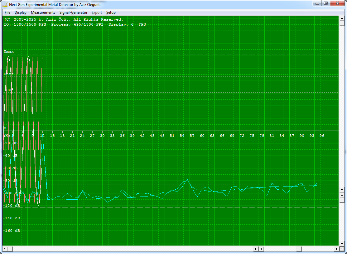

    • Hi Carl,
      yep. I should have called it noise floor level instead of SNR.
      When I reduce the block size to 128 (instead of 1024), the frequency bins integrate more noise as the bandwitdh of the frequency bins gets greater.
      It is at least 10 dB more noise at each frequency bin.
      Oh my god!, I can process only 1/3 of the frames (495 of 1500). 2/3 will be discarded as the process-thread can't make it as fast as the IO-thread delivers data.
      But this is the old process-thread with 1001 features. The new process-thread with the Goertzel decoders will do that with ease.
      Aziz

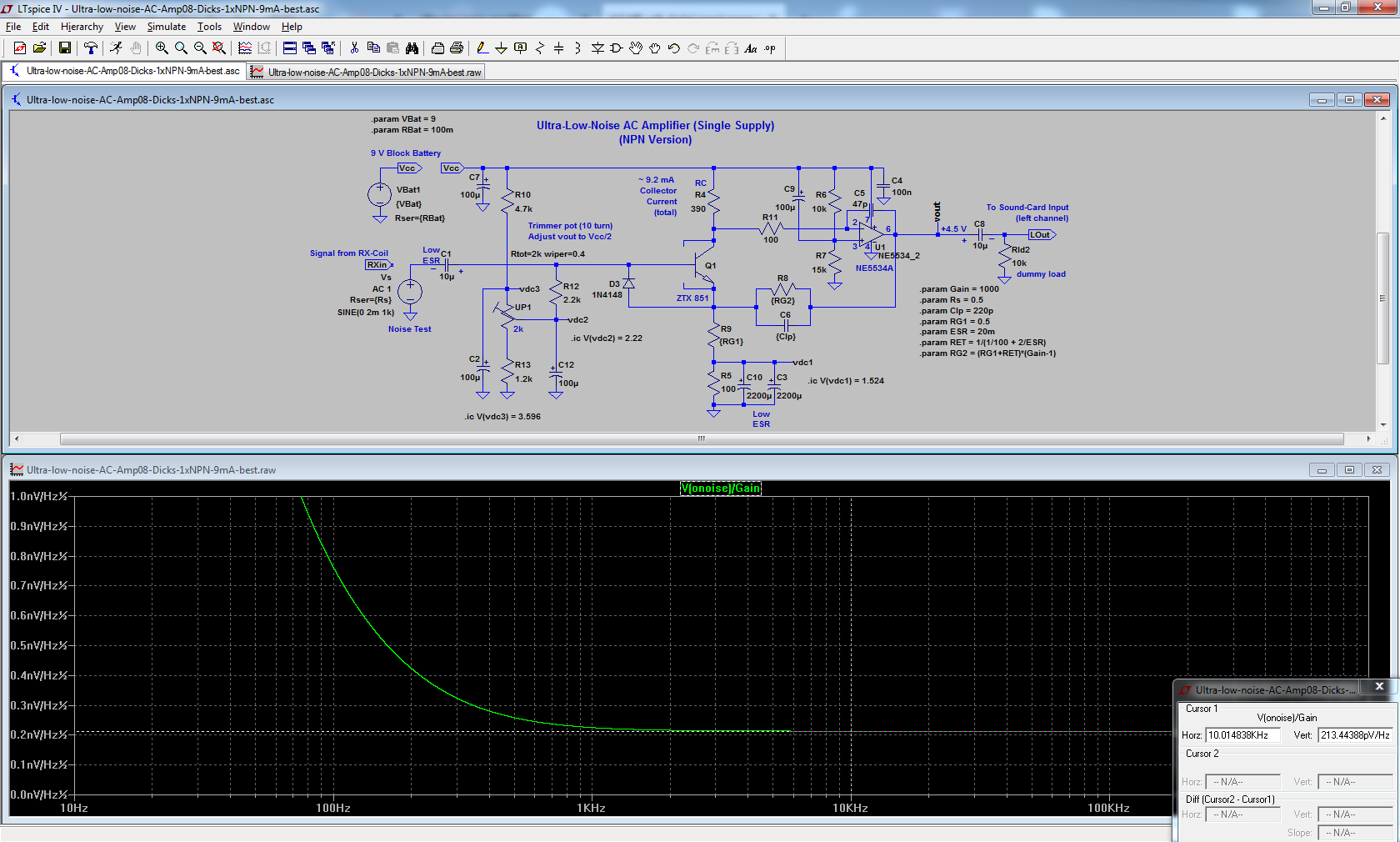

        • Hi all,
          have a look.
          I have adapted and arranged Dick's Ultra-Low-Noise Pre-Amp:
          see source http://www.dicks-website.eu/low_nois...rt3/part3.html
          Click image for larger version  Name:	Ultra-Ultra-1xNPN.png Views:	0 Size:	135.9 KB ID:	435040
          This nice pre-amp with gain of 1000 and 9 V single supply operating voltage (9 V block battery), achieves with only 1x NPN (ZTX 815) an input voltage noise density (en)
          en of 0.225 nV/rtHz at 1 kHz and
          en of 0.214 nV/rtHz at 10 kHz
          Not bad. With a cheap NE 5534A op-amp. Even with a 500 Ohm load on the output of the op-amp.
          Now the critical conditions, which allow the superior noise specs:
          Collector current set to approx. 9 mA
          Source resistance is max 0.5 Ohm (RX-Coil with 0.5 Ohm series resistance)
          Gain setting resistor RG1 is 2x1 Ohm parallel (=0.5 Ohm). Must be fixed at this value.
          ESR of the capacitors must be each max. 20 mOhm.
          The real gain setting resistor RG2 can be calculated according to the formula above (must be approx. 500 Ohm)
          Bandwidth is well above 100 kHz. Enough for me.
          Power consumption approx. 12-13 mA.
          No LT1028 or AD797 required at all.
          I have versions with 2xNPN and 3xNPN in parallel. These are a bit better. But the power consumption is too much for a 9 V block battery. I like the single transistor version. I don't need to go below en 0.22 nV/rtHz.
          Cheers

                        • I have made three working configurations in LTspice and looked at the noise at the output of the pre-amp. The noise density is measured at 10 kHz. The bandwidth of my noise calculation is 200 Hz. So we integrate from 10.0 kHz to 10.2 kHz over the noise density to get the output noise voltage of the pre-amp. Or simply Noise = ouput noise density * sqrt(200 Hz).
                          Let's look at different configurations.
                          Configuration 1:
                          Pre-amp gain G=500
                          RS = 4 Ohm (RX coil resistance)
                          Ouput noise density = 160.55 nV/rtHz (at 10 kHz)
                          Noise = 2.271 µV (rms)
                          Configuration 2:
                          Pre-amp gain G=1000
                          RS = 2 Ohm (RX coil resistance), RX coil has twice less turns as we have twice more pre-amp gain
                          Ouput noise density = 264 nV/rtHz (at 10 kHz)
                          Noise = 3.73 µV (rms)
                          Configuration 3:
                          Pre-amp gain G=2000
                          RS = 1 Ohm (RX coil resistance)
                          Ouput noise density = 460.2 nV/rtHz (at 10 kHz)
                          Noise = 6.51 µV (rms)
                          You see the answer now why. But this does not anwer my question yet. How much gain is required at what RX coil inductance? I have to plug a pre-amp and an RX coil to see the answer in the FFT spectrum. Trial and error method at best.
                          Cheers,
                          Aziz
