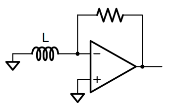

        The RX-coil is practically shorted to ground.
        No, it's not. It's practically shorted to virtual ground. Here's a circuit to consider:
        What's the gain of this circuit? How does it work? (Hint: you already have the answer.)

        The RX coil is capable of producing either a voltage or a current. In the case of the Lee amplifier, the RX coil current is converted into an output voltage, therefore it's a transimpedance amplifer (G=Vout/Iin). It's a perfectly legitimate way to make an RX preamp whether the ultra-low noise is a benefit or not.
        Also, maximum power transfer only matters when you want to transfer maximum power. In the kinds of designs we do, we avoid that because it's just wasteful.
