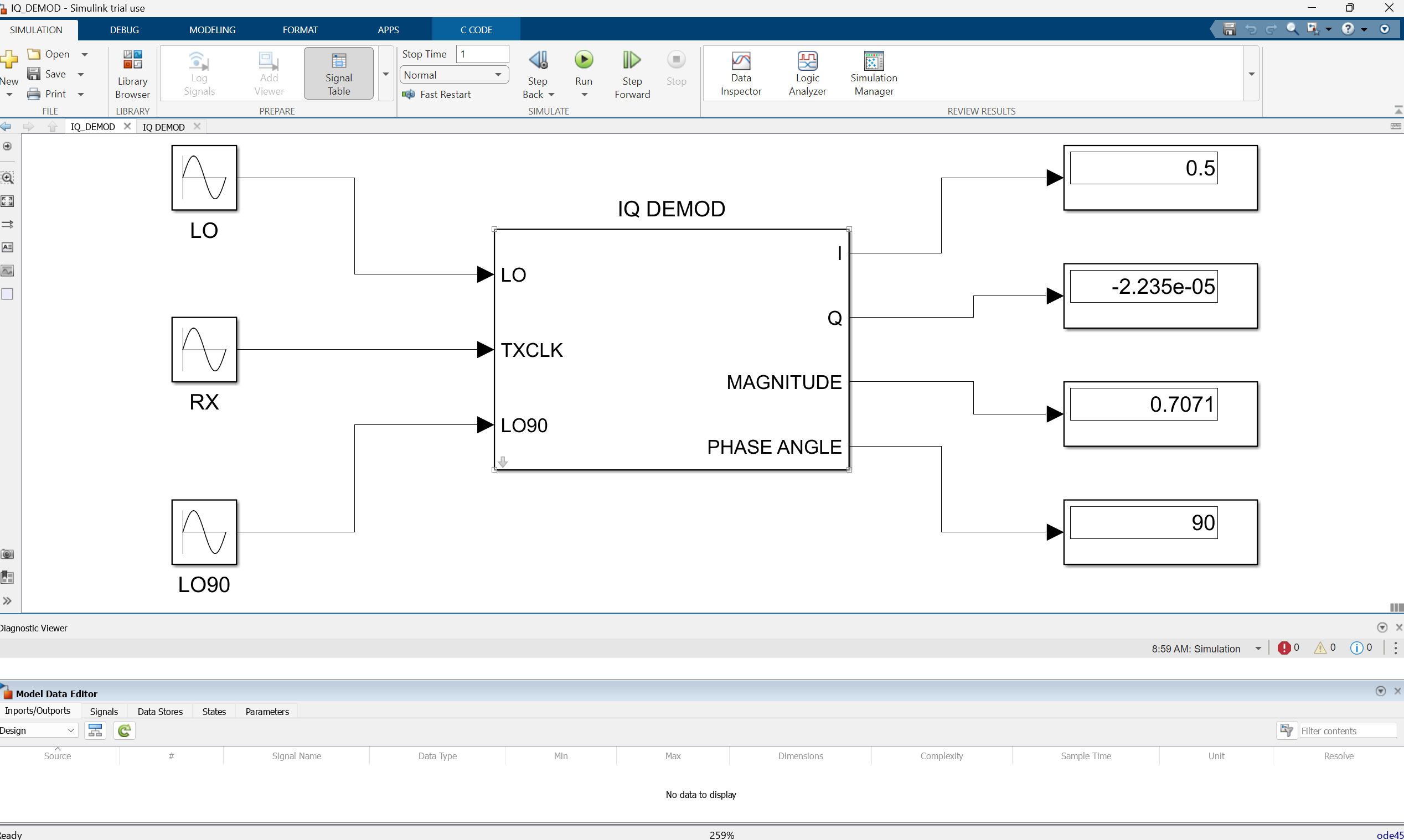

        1. Draw your model and run it in simulink- heres the IQ demodulator

        and here is what is in the IQ block
        2. You can edit the params in each block like frequency / phase etc as much as you want. Add or delete blocks as required.

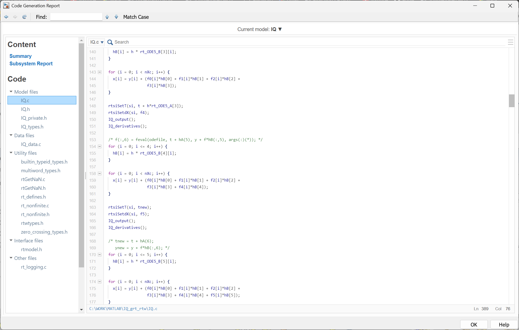

        3. Now right click on the IQ block and select generate code. Done the C code for the IQ demod is autmagically generated.
ID:	432680​4. You can even get Matlab to squirt the code into your chosen platform. ( you WILL have to put more bits into it though )
        If you have your model all this takes less than a minute.
        I can post the model too ... but maybe you should learn by doing.
