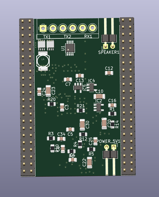

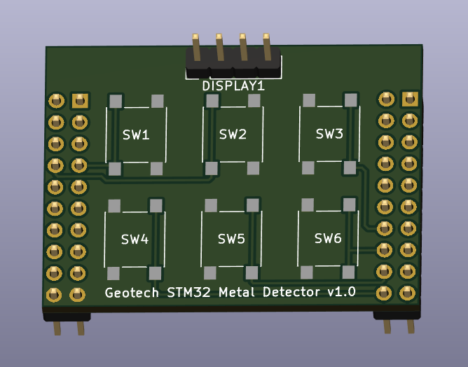

                      • Hello everyone
                        I started working on the PCB design that I wrote about in previous posts. On the top PCB where the buttons will be, I added a small I2C 1.3" OLED display which will be quite nice and I'm still thinking about adding this audio amplifier which can process both analog and digital signals which I think would be useful too. I'm attaching the file for STM32CubeMX so you can see the output connections and write your objections what would be good to change. The board on which all this will run has one minor problem because it doesn't have direct ADC pins PC2_C and PC3_C connected which is a bit of a shame. The top PCB is designed completely and I'm still working on the main bottom PCB.
                        TI’s TAS2521 is a 2-W, mono, digital & analog input Class-D audio amp with miniDSP & 18-mW, mono headphone driver. Find parameters, ordering and quality information

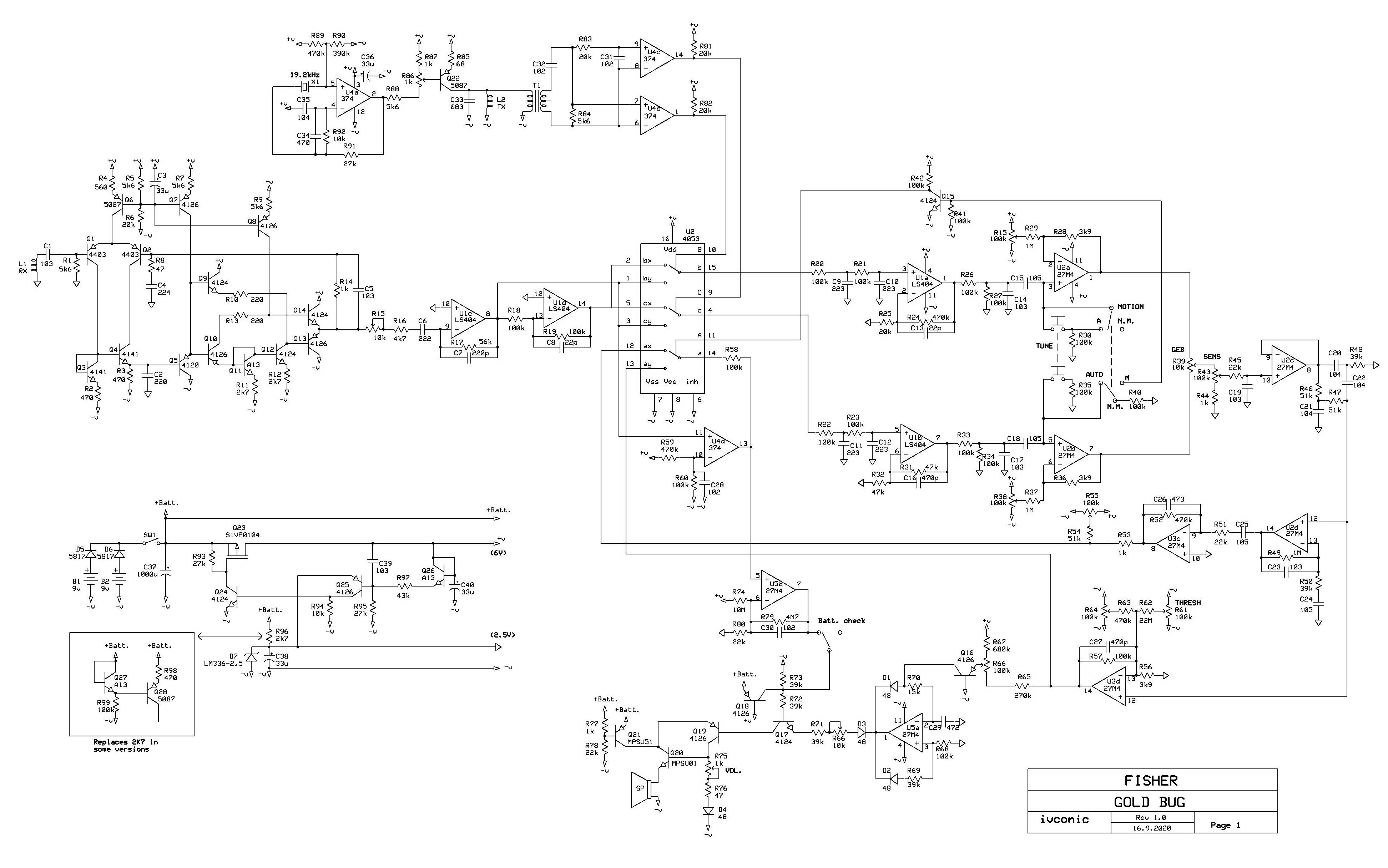

                          • In this case, how to explain that Fisher Gold Bug working at 19.2KHz use as first RX stage very complex OpAmp completely designed at separate transistors? I think, the aim of this is very low noise.
                              Hi Detectorist,
                              in Fisher Gold Bug RX front end it is a more or less complex differential amplifier. Gain is defined by G=1+ R14/R8, with inherent band pass filtering using capacitors C5, C4. At the input there is a high pass filter (C1, R1). So it is AC-coupled.
                              This isn't an ultra low noise design. But quite low noise.
                              The preamp I have shown outperforms it. By simplicity and noise specs.
                              Aziz
                              • Hi Aziz,
                                I wrote "very low noise", not "ultra low noise". Explanations for R8,C4,R14,C6,C1 and R1 are more than obvious. This part of schematic is connected as noninverting OpAmp, not as differential amplifier. For me will be interesting answer from Moodz at my question, sorry!
