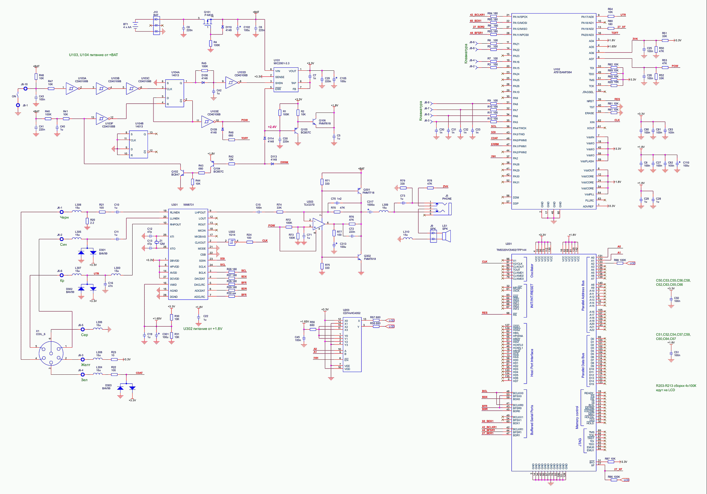

                • #98
                  Originally posted by Atul Asthana View Post
                  Great conversation, I am learning
                  which low cost 24 bit codec would be suitable in this design?
                  and which direct sampling design should I study?

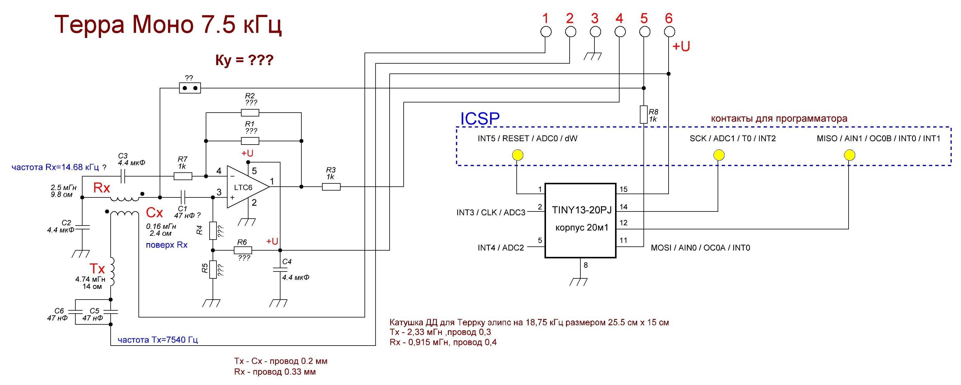

                  • #99
                    point to consider about using expensive opamps.
                    however, with 24 bit codecs, I'll probably need good opamps.

                          • 6kHz is fine. For the purpose of development, frequency doesn't matter and can easily be changed later.
                              Click image for larger version  Name:	Schematic.gif Views:	0 Size:	255.6 KB ID:	432300​
                              Thanks ivconic for the schematics.
                              As per Carl's recommendations, if we stick to the original scheme, there isn't much hardware involved, as outlined in an earlier description.
                              Once the software design is finalized, we will focus on the appropriate hardware, which primarily consists of op-amps and filters. These components have already been calculated but will be revisited if the TX frequency changes.
                              Additionally, care will be taken to ensure the hardware supports efficient signal processing with minimal noise. Any changes in TX frequency will also necessitate adjustments to the filter bandwidth and response characteristics to maintain system accuracy.
