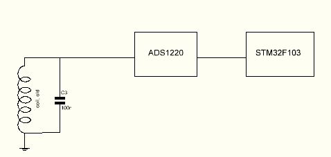

                • And here is a ADS detector, what is missing is Arduino Goertzel phase detector code
                  This is why you dont need amplifier at the front end of the direct sampling ADC metal detector.
                  Click image for larger version  Name:	image.png Views:	0 Size:	50.2 KB ID:	435440​​​

                      • Originally posted by pito View Post
                        The ADS1220 is useless for direct sampling. 2 k-SPS vs 192 k-SPS (my sound card). We would require hw demods for this adc. No go.

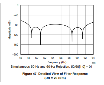

                              EMI mostly is caused by power lines 60Hz/50Hz and harmonic of them, ADS 1220 has filters 60Hz/50Hz
                              Click image for larger version  Name:	image.png Views:	0 Size:	23.7 KB ID:	435451
                              ​I have done some real measurements with an RX coil. With preamp (gain 100 or +40 dB) = show it on oscilloscope​
