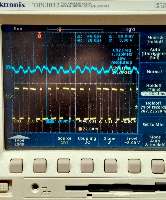

            Here are three pre-amps that I made and tested. The first (equinox) had some problems with oscillations and low bandwidth. It used some flea sized components, so I blamed it on pcb design and poor soldering. The second (vanq) worked well but the bandwidth rolled off in the 30khz range. I modified the third to to work up into the 40khz range. These operate at 3.3v and have a low impedance differential output which allows using simple twisted pair cable. Credit to Orbit on helping reverse the vanquish pcb. I am interested in how it would be received and fed to the ADC.
            Hello
            I would like to know what the output signal shape is from this amplifier at the RXN and RXP outputs. Do you have any photos of the output measurement on an oscilloscope ?.​
            • Here is the only photo I could find. RXN and RXP are equal but 180deg out of phase. The yellow trace is the Tx and the blue is the pre-amp out. Not sure which output it was or what mode the detetector running. This is from 3-4 years ago so I don't recall all the details

                  Thank you, that's enough for me, this is exactly what I wanted to see, do you think this circuit could work if connected directly to the ADC processor input or would I need any additional components ?.
                  • Originally posted by Marchel View Post
                    I have no experience with direct sampling so, I can't help. If you look at the schematic JoyJo posted, the pre-amp feeds the PCM1861 thru a common mode choke and anti-alias filters. You should study the PCM1861 datasheet
                      Yes, I've already looked at it and it seems like it could work, I'll try putting this preamp together and give it a try.
