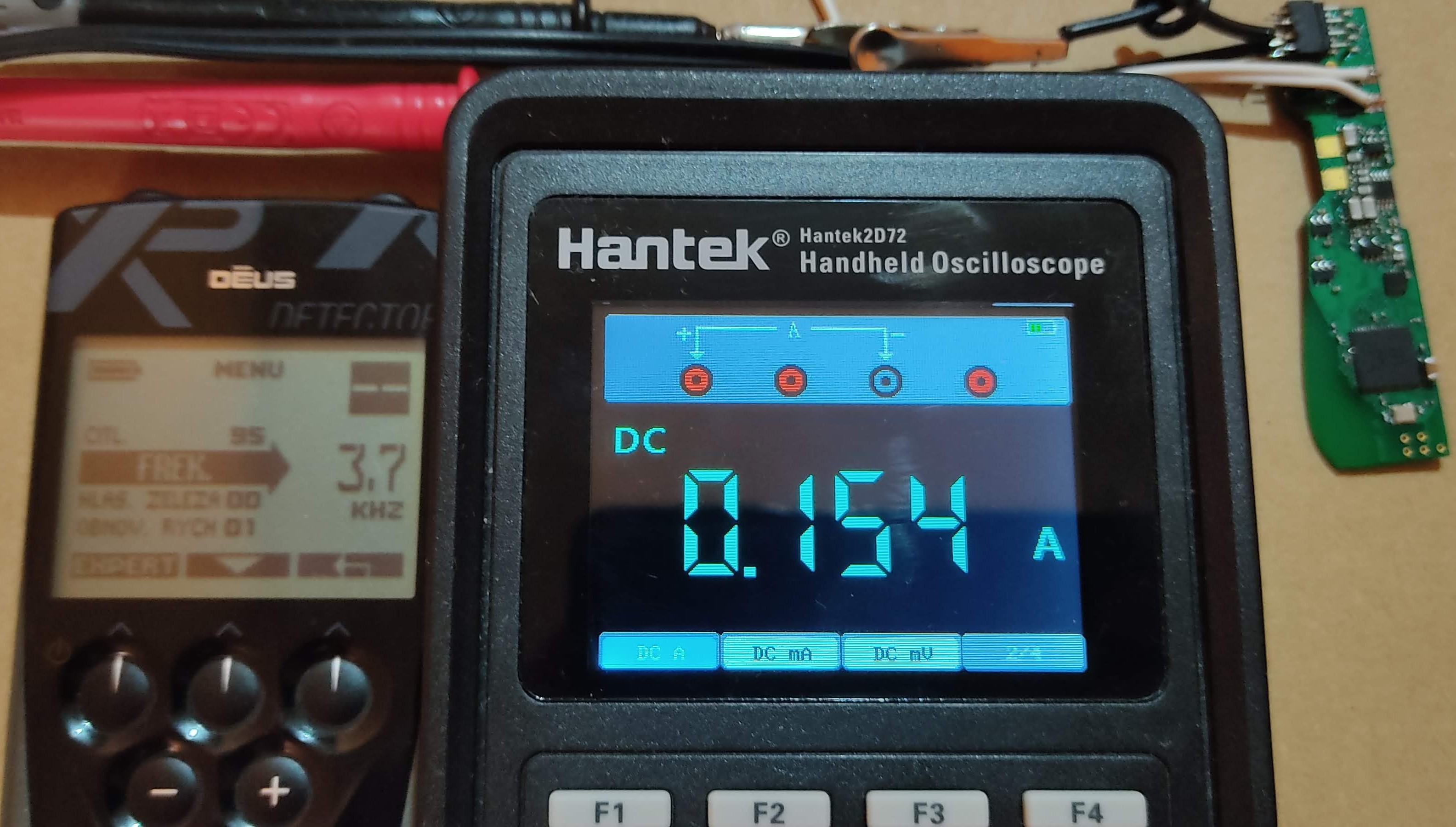

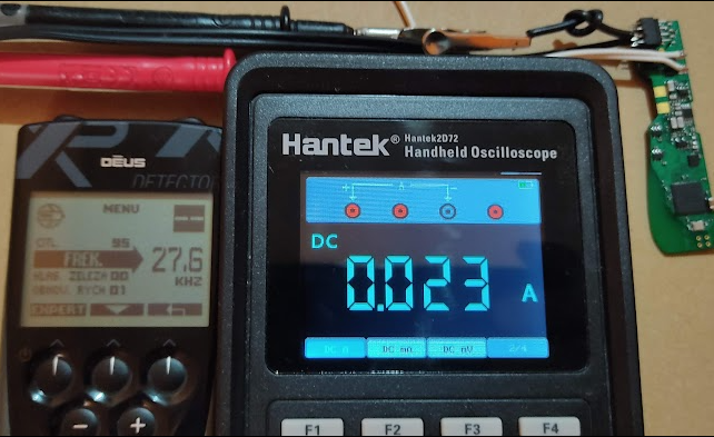

          It depends more or less on the TX winding and frequency. I use an XP Deus X35 coil and the total electronics draw is about 40mA. Other detectors I have seen draw something between 80-120mA from the battery.
          • Is it this current is draw from Tx circuit or from total detector with processor and all other electronics?
              In my case, the total current is the same with the processor and all the electronics. This figure varies depending on the frequency used, I think the maximum current I measured was 60-80mA.
              • Here are current measurements on the XP Deus X35 at two different frequencies.

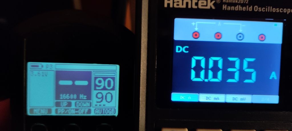

                • Now I did a current measurement because I wasn't completely sure of the current draw so the current at a frequency of 16.6kHz is 35mA in my electronics which I replaced in the X35 coil.
