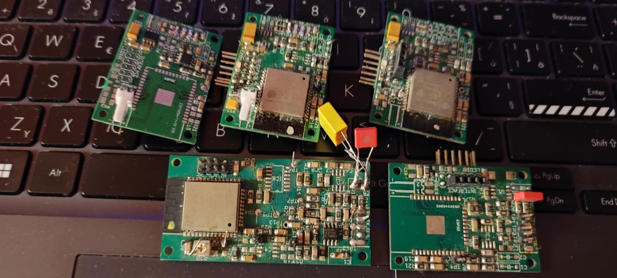

                  ESP32 Metal Detector is probably my first project that I started working on, but then I stopped working on it because the hardware was complex and I started working on direct sampling detectors and switched to STM32.
