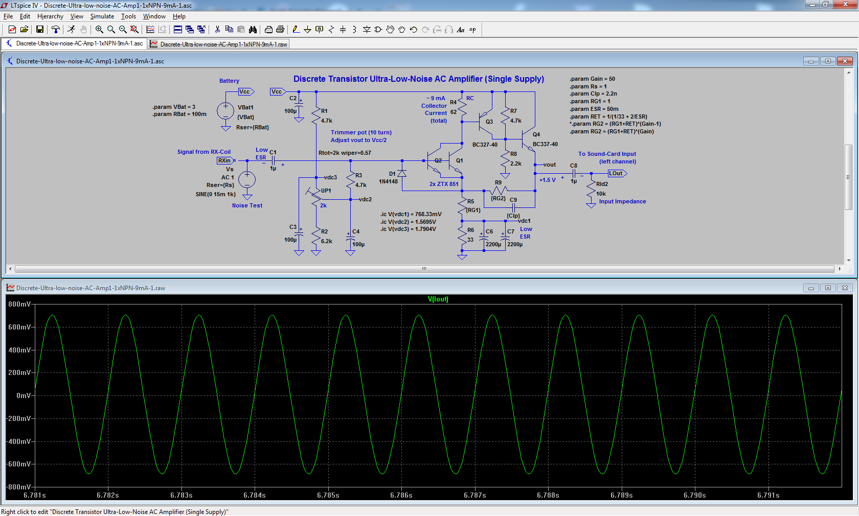

                  • Hi all,
                    well, ok. I have got rid of the op-amp and made the AC pre-amp fully discrete now (the good old days style ).
                    It operates now at 3 V battery voltage and allows max. 15 mV input voltage at gain of 47. Beyond the limit, it begins to disturb the output as there isn't enough voltage range due to the transistor voltage drops.
                    Power consumption: 25 mA at 3 V.
                    Noise-Specs? It's Ultra
                    See below:
                    Click image for larger version  Name:	Discrete-Ultra-Ultra-with-driver.png Views:	0 Size:	115.5 KB ID:	435345
                    Cheers,
                    Aziz

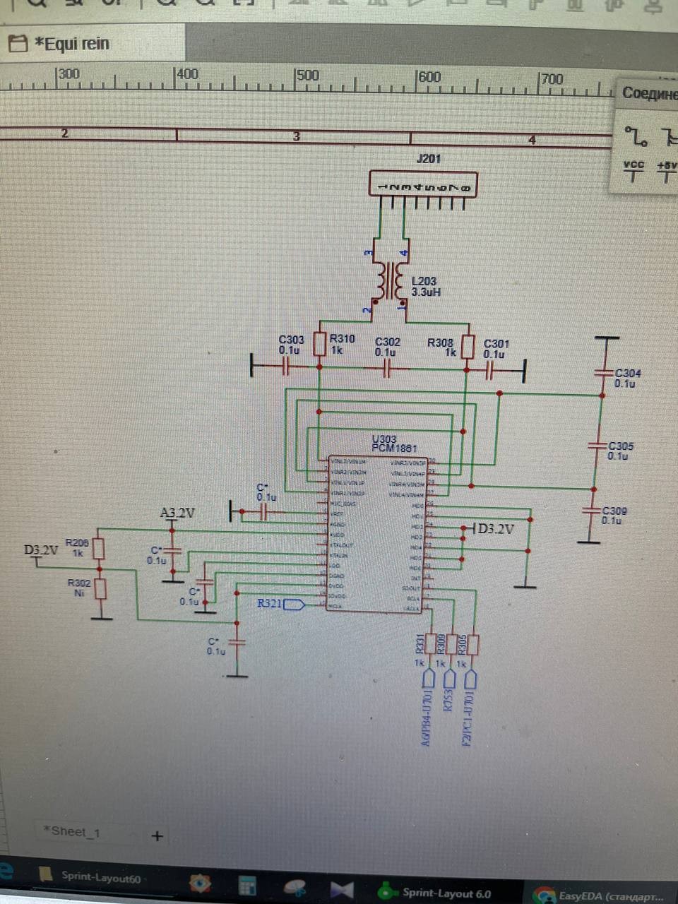

                      Here are three pre-amps that I made and tested. The first (equinox) had some problems with oscillations and low bandwidth. It used some flea sized components, so I blamed it on pcb design and poor soldering. The second (vanq) worked well but the bandwidth rolled off in the 30khz range. I modified the third to to work up into the 40khz range. These operate at 3.3v and have a low impedance differential output which allows using simple twisted pair cable. Credit to Orbit on helping reverse the vanquish pcb. I am interested in how it would be received and fed to the ADC.
                      Equinox has such an input part in the block. The second differential input is used to monitor the current in the coil Tx. Click image for larger version
                      • Thanks! That completes the basic hardware picture. The rest is code.
                          Hi all,
                          Aziz
                          and minimum ? = sensitivity
                          • Originally posted by pito View Post
                            Hi pito,
                            you have misunderstood me. Due to the low battery voltage of 3 V only, the input voltage is limitted at a specified gain of approx 50.
                            Input 0 - 15 mV -> no distortion expected. Output voltage peak-to-peak would be approx. 1.5 V.
                            Input above (> 15 mV) -> distortion to output happens.
                            • so you can say sensitivity is 1 microvolt and output will be 47 microvolt noise free ?
                              15x47 = 0.705 V not 1.5 V
