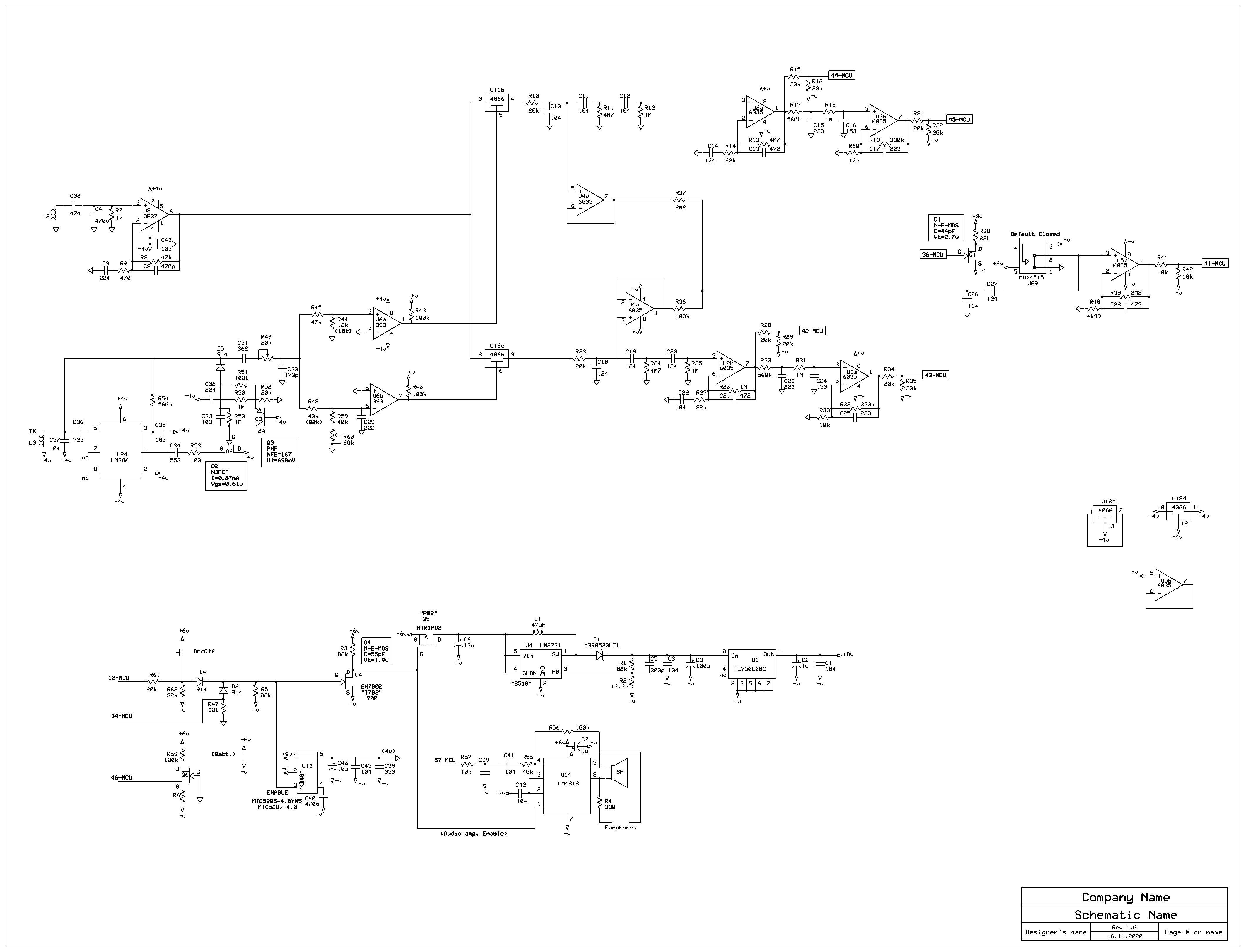

    I have a Garret Ace 250 that takes a long time to turn on and once it turns on it doesn't detect anything. I've been comparing it with a schematic I found in the KT315 shared files but there are some differences. Because I also took the patience to draw it.
    Here I share the schematic, but I want to know if there are any flaws in the schematic because I want to ask some questions to those who have experience in repairing this detector.
    Please note that I drew this schematic as the detector is (that is, with the fault), which is why I need your help to repair it.​
    Here I also share a photo of the plate and also the number of components according to the diagram I drew.
      I would like to know first if the GATE of VT6 is connected to +4V or is it only connected to pin 47 of U1?
      Because according to my board, pin 47 of U1 and the GATE of VT6 are connected to +4V.​

                The diagram that I published and comparing it with the one that Ivconic shared with me is drawn correctly. Thank you Ivconic, you were a great help to me! As for your PCB, several tracks need to be drawn, just follow my diagram.
                Here I publish my scheme, it only has some tweaks.​

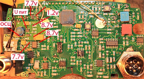

                  Friends, I have been checking the power supply and have taken voltage measurements at the points shown in the image.
                  Red readings are taken without the sensor and blue readings connected with the sensor.
                  I would like to know if the output voltage of U3 should be around 8V, if so it could be that the IC is bad or there is something that causes the voltage to drop too much.​

                      Looks like: "...or there is something that causes the voltage to drop too much..."
                        I don't know if this will be of any help to you, I just browsed through my disk and have found this from another forum:
                          If U3 were to burn out; then there would be no voltage on U13, at least that's what I assume.
                          It seems that the voltage "+EA" (8V) is under some load and therefore has a voltage drop.
                          Another possibility is that the U13 is a bad circuit. Because U13 should divide the voltage of U3 in half.
                          It's really hard to pinpoint the problem. Because everything is interconnected.
                          Perhaps the best method is to somehow separate the power supply part from the rest of the detector and check
                          what voltages it will give when there is no load.
