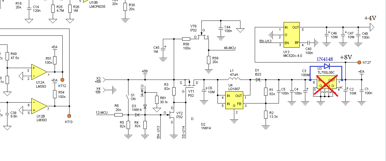

                  Hello friends, I'm going to tell you about a problem I had with my Garrett Ace 250. I was checking my Garrett and noticed that the output of the 8V regulator was only 3.4V. I isolated the 8V regulator on the same board (I didn't remove it), then took a measurement and it read 8V. I immediately thought the regulator was fine, so I checked all the 8V points and everything seemed correct. After racking my brain trying to figure out what the problem was, I started to suspect the 8V regulator again. What I did was put a 1N4148 diode between the input and output of the regulator, and bingo! I found the solution. The detector worked as it should. The whole problem was the 8V regulator.
                  After removing the regulator and replacing it with the diode, my question is: can I use the detector permanently with this diode? I ask because I can't find the regulator or the 78L08 regulator in my area.
                  Any suggestions are welcome!​ Click image for larger version
