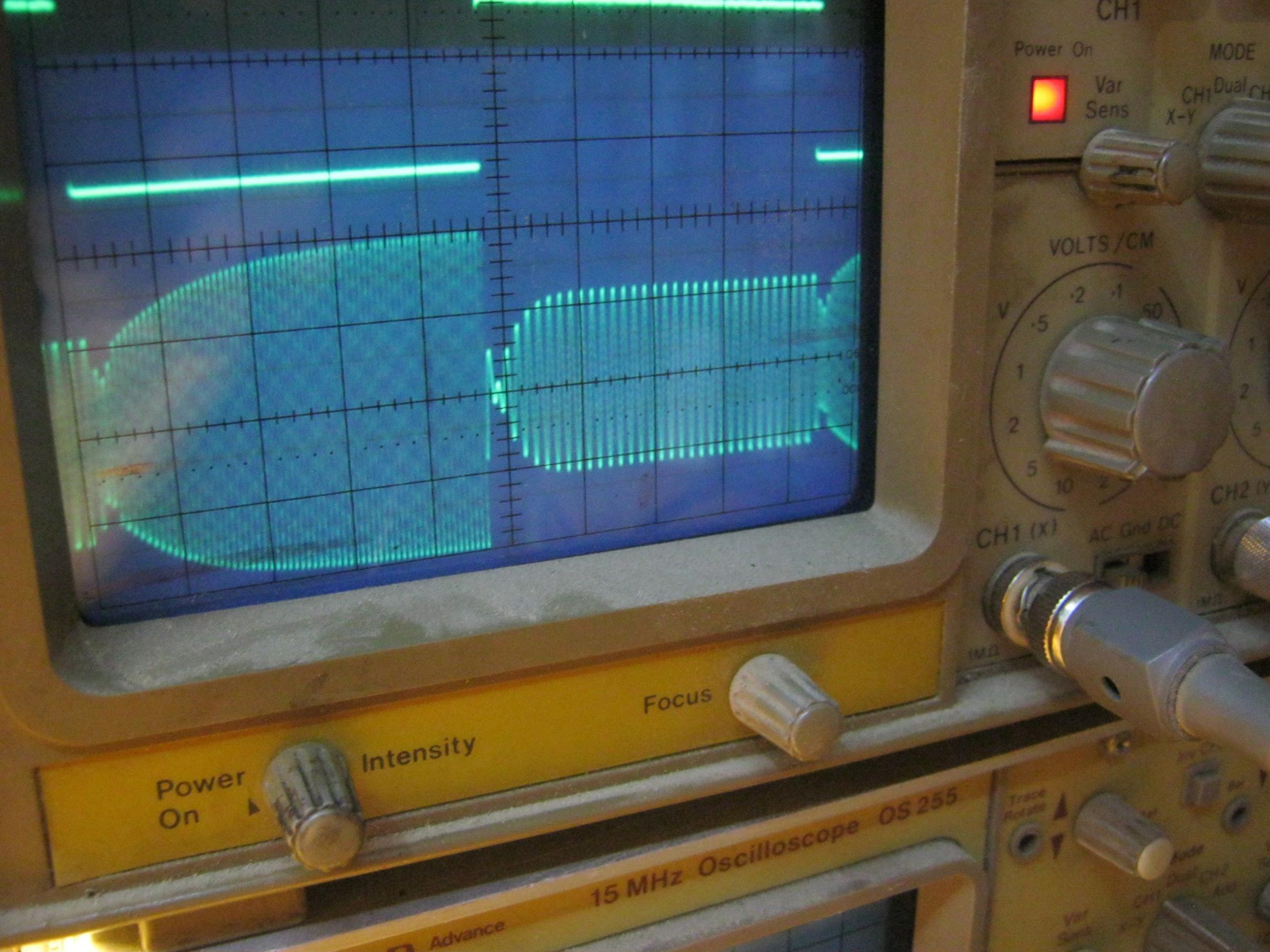

ID:	434134I built such a machine. It was very complicated to build. The machine changed frequencies 128 times per second. When changing frequencies, one had to wait for the vibration to build up, and only then could the signal be examined. When changing frequencies, the resonance of both the transmitter and receiver coil had to be changed. My machine went at 8 and 16 kHz. Actually, I recommend building a multifrequency machine driven by a square signal. They are much better.

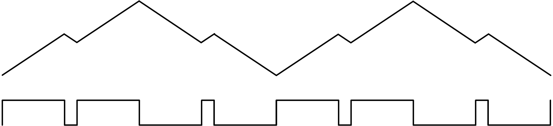

                  I doubt there is any one ideal way to do this. For example, if you want a 1x and 3x frequencies you could do it this way:
                  The top waveform is coil current. You can adjust the short ramplet duty cycle to change the amount of TX energy between the 1x & 3x frequencies. This is probably best done by watching an FFT.

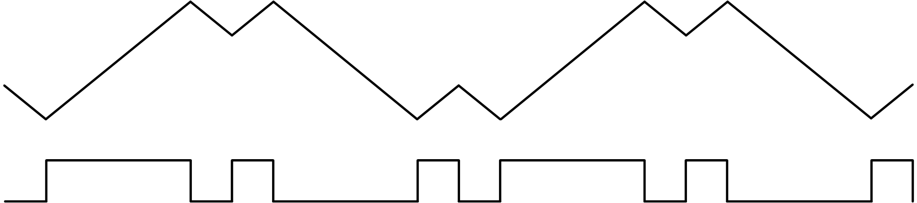

                  Here's another way of producing 1x and 3x frequencies:

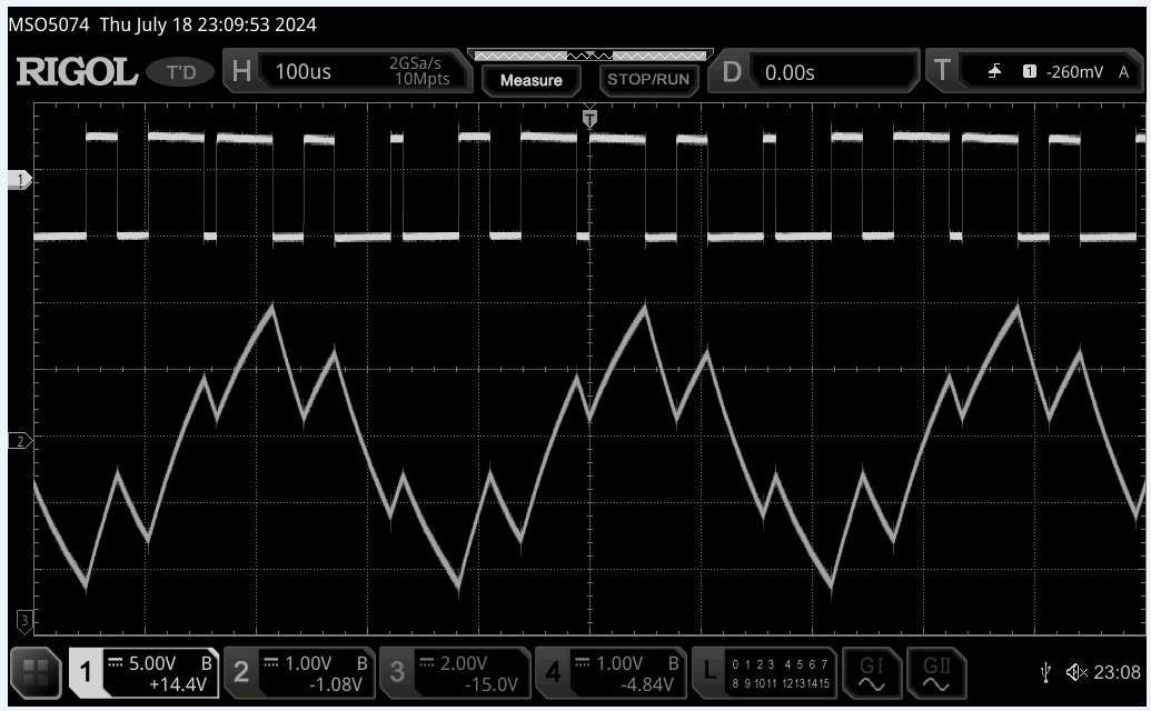

                  It's not necessary that the ramplets be symmetrical. Here's the DFX TX waveforms:
                  It's similar to the first waveform above but with two extra reversals per cycle for a 1x & 5x frequencies.

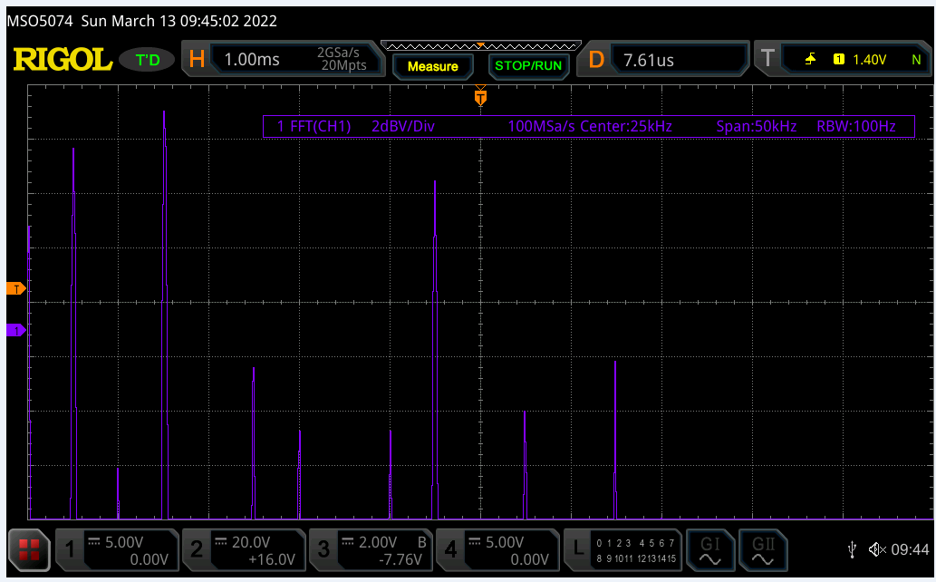

                  The short of it is, create some waveforms and see what they look like in an FFT. A digital oscope makes this easy; here's the FFT of the V3 TX, you can see that 7.5kHz is the strongest while 22.5kHz is the weakest.

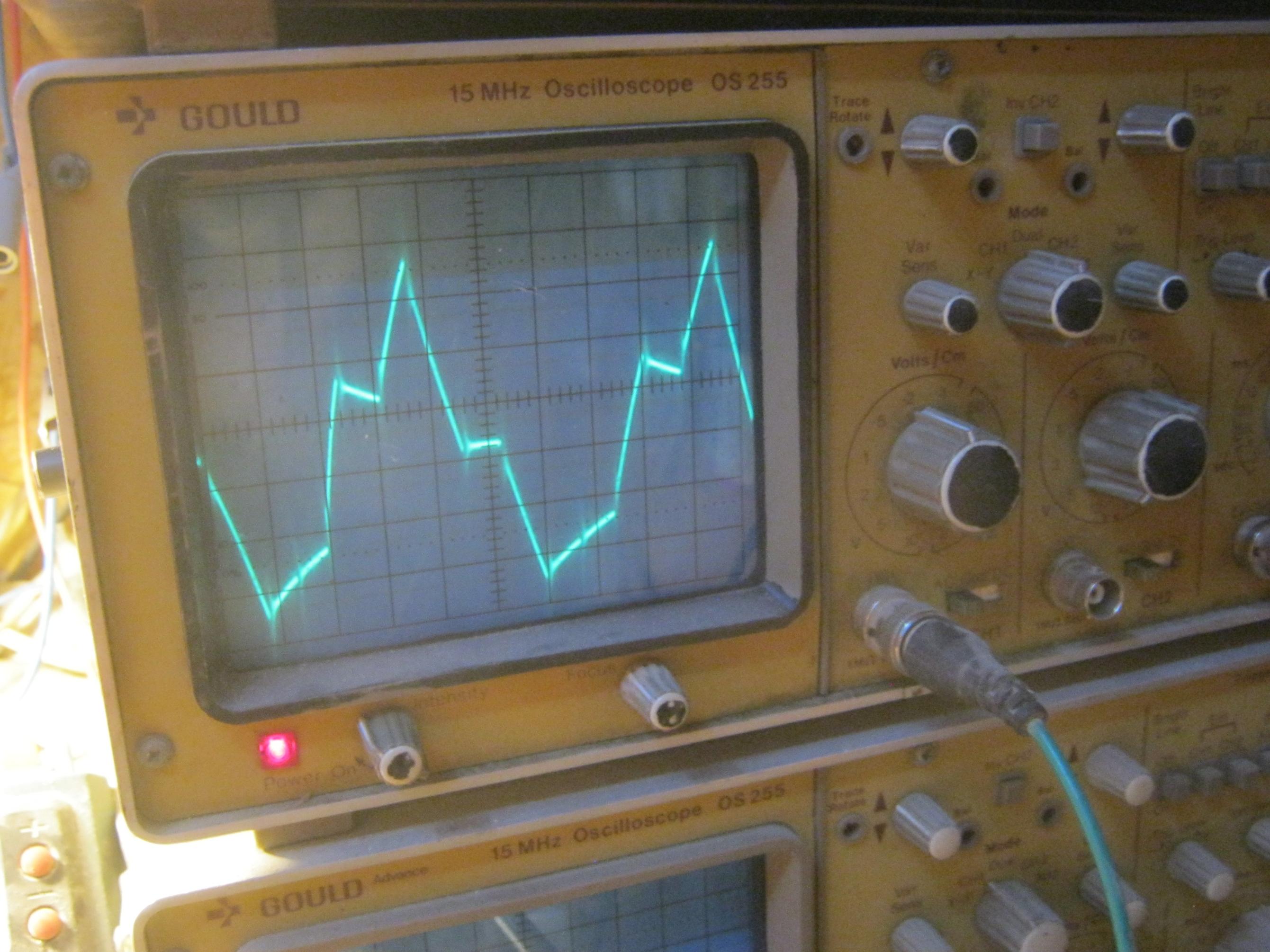

                      A picture of the square multifrequency machine when it was built. It has operating frequencies of 5 and 20 kHz. Completely self-designed. Simple little circuit.
                          Is this sequential multifrequency?
                            Continous. One half of the H-bridge goes at 5 kHz, the other half at 20 kHz.
                              I've never tried it that way. But that explains your oscope waveform; sometimes the coil is driven, and sometimes it's effectively shorted.
