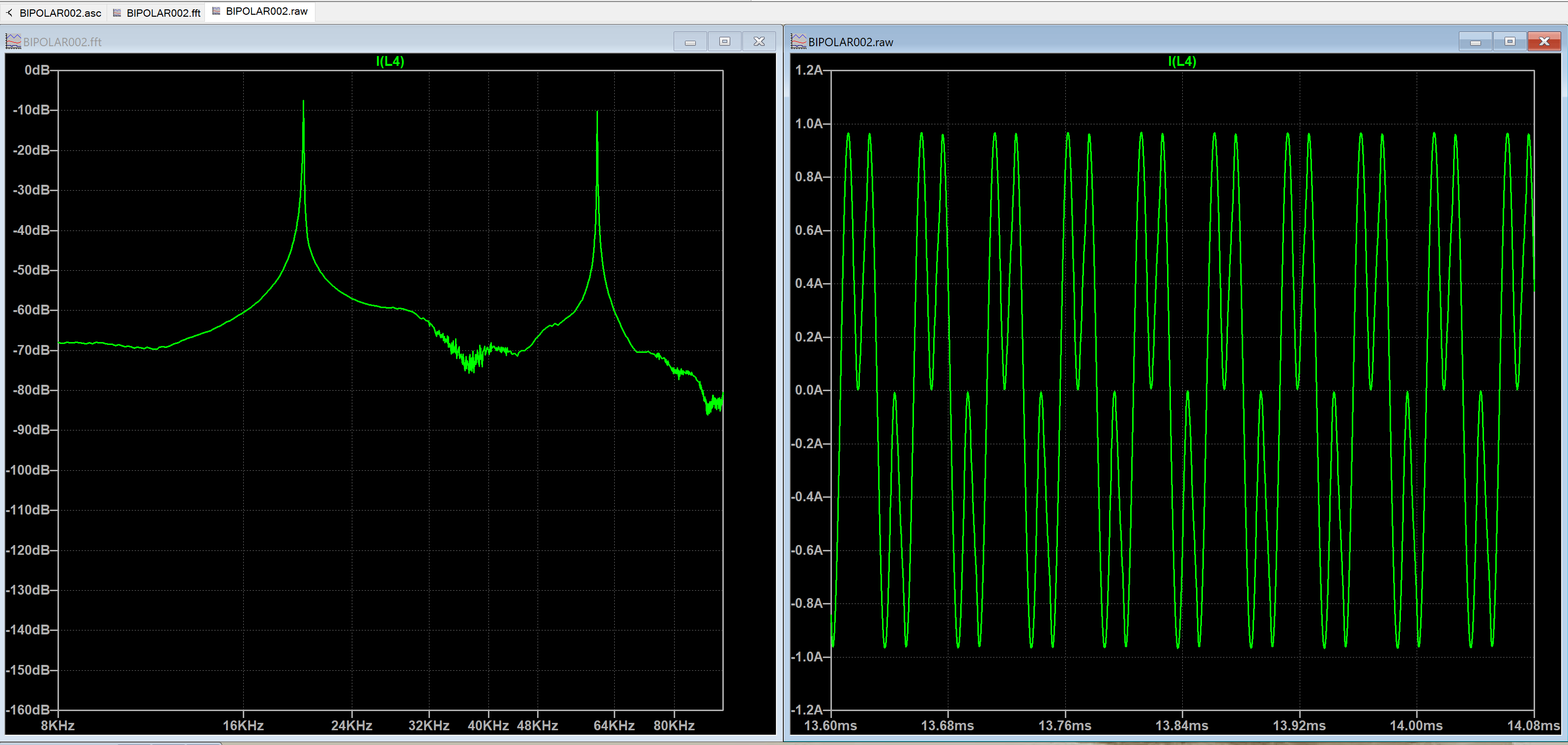

                ...generating high power sine waves is fairly easy using additive half sines and an allpass filter because it will allow passage of odd harmonics ...
                For instance I use the waveform below generated from a square wave source simple biresonance and consumes only 75 ma from a 12 volt source to generate practically equipower sine waves at 20 and 60 Khz with clean spectrum and no wasted energy. Those "ramplet" waves are simply weird.

                      I already published the circuits how to make sine and half sine ...even quarter sine TX. High power and minimal current draw. An FPGA makes things a lot easier to do things synchronously but oversampling means you won't need a preamplifier since with the right ADC you can't actually implement an amplifier with lower noise than the ADC sample step resolution ... I get approx 6 nanovolt resolution on my 24 bit oversampled implementation and I am only demodulating single frequency .... Not sure that multiple frequency is actually needed.

                        This is a very nice wave form Moodz!
                        I would be interested on the TX circuit and spice simulation. I don't know where to search for.
                        Aziz
                          TX circuit
                          Aziz

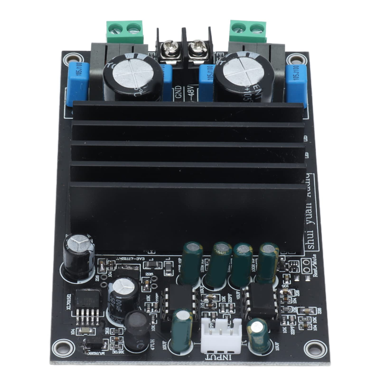

                          regular audio amplifier , the speaker coil is driven by multi frequencies.
                            Not a regular audio amp ... A "D" class amp like the TP32xx series from TI that have 100khz bandwidth and can achieve around 90% efficiency into a half ohm coil.
                              TPAxx ...typo
